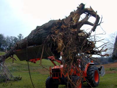

As I have said many times to many people, I just never liked the HST ranges. They either need a fourth range or the kick down range (with a modification to the present M range) you see on many HST models today. With that under its belt it would be a great tractor. To see that change will require a rebadging. If they are going to do that, straighter loader arms and a curved hoe are probably in the works then as well. I had the Gearmore 72" HD box. With a minor modification it was a superb match for the L48.
