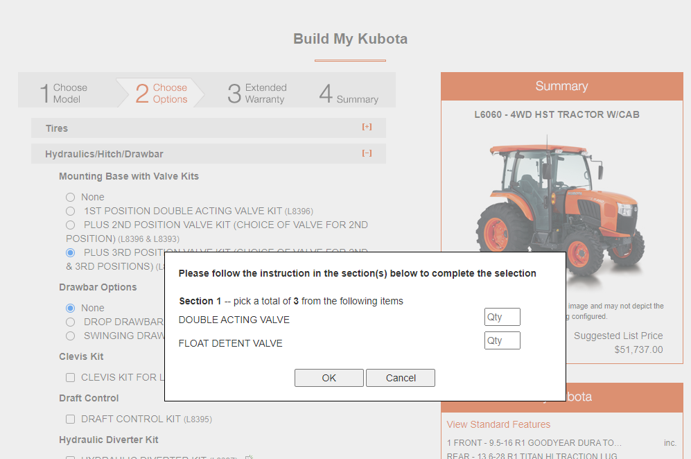

Hey all,
I just took delivery on a shiny new L6060 (woo!). While most of my implements are back ordered into oblivion, I at least got my hydraulic rear blade to play with. When I started using it I noticed something really funky with my rear remotes. I'm hoping someone could give some feedback on what might be up.
For context, I ordered 3 rear remotes, 2 detent and 1 float. My understanding is that a single float is always installed in position 2. In this video I explain and show what's going on with the three, but in summary, remote 1 and 2 don't have float detents but work fine otherwise, while remote 3 is nearly impossible to move in the back position, as if it's fighting something. If I REALLY put my strength in to it I can make it go but the hydraulics are whining and fighting me.
My engineering mind thinks that they installed the float in remote 3 and maybe backwards, so that pulling back on the remote lever is fighting the float detent in the wrong place.
The dealer rep so far has said that that's just the float valve and that's how it's supposed to be. I am of course pushing back but am hunting for more understanding to help with the diagnosis from-a-distance since I'm so far from the dealer.
Here's the video, and of course a glamor pic :cool:
Check your linkage adjustment from the valve to the control stick. Hard to tell but it looks like it could be binding up in the back position. Try swapping that blade function to a different remote. That way you can isolate valve vs blade issue. I don’t think it is deadheading. It sounds like the valve is only partially open in that position.
   / New L6060, what's wrong with my rear remote? #26
I would check the linkage under the panel to make sure everything can move properly. When I installed my remotes following the instructions, the hoses blocked one valve lever from moving all the way. The hoses needed to be moved to let the lever go through a full range of motion. They obviously did not realize that when the instructions were created.
I don't know if this applies to your tractor, but on my L3200, certain valves could only go in certain positions. I only have two, a standard double acting and a double acting with float detent. I don't remember all the details but the valves had to go on the stack in a very specific order.
   / New L6060, what's wrong with my rear remote? #27
I had the dealer install 2 rear remotes on my Gr L6060 and one of them wouldn't return to neutral position on it's own. The dealer sent a tech to my shop and he said the installing tech tightened the stack of valves to tight. He loosened and re-torqued the stack and all has been good since. My problem is a little different than yours, but I would get back to the dealer and let them work it out.

On the last two Kubota's I've owned (both L6060's), the dealer didn't install the linkage correctly between the lever & valve. On my current L6060 HSTC, the third remote, the one on the bottom of the stack, did something similar to what you're experiencing. I pointed this out to the mechanic at the dealership who reinstalled the linkage and the problem went away.
I don't know if this helps but I would definitely get the dealer to take a look before you start messing around with it.
