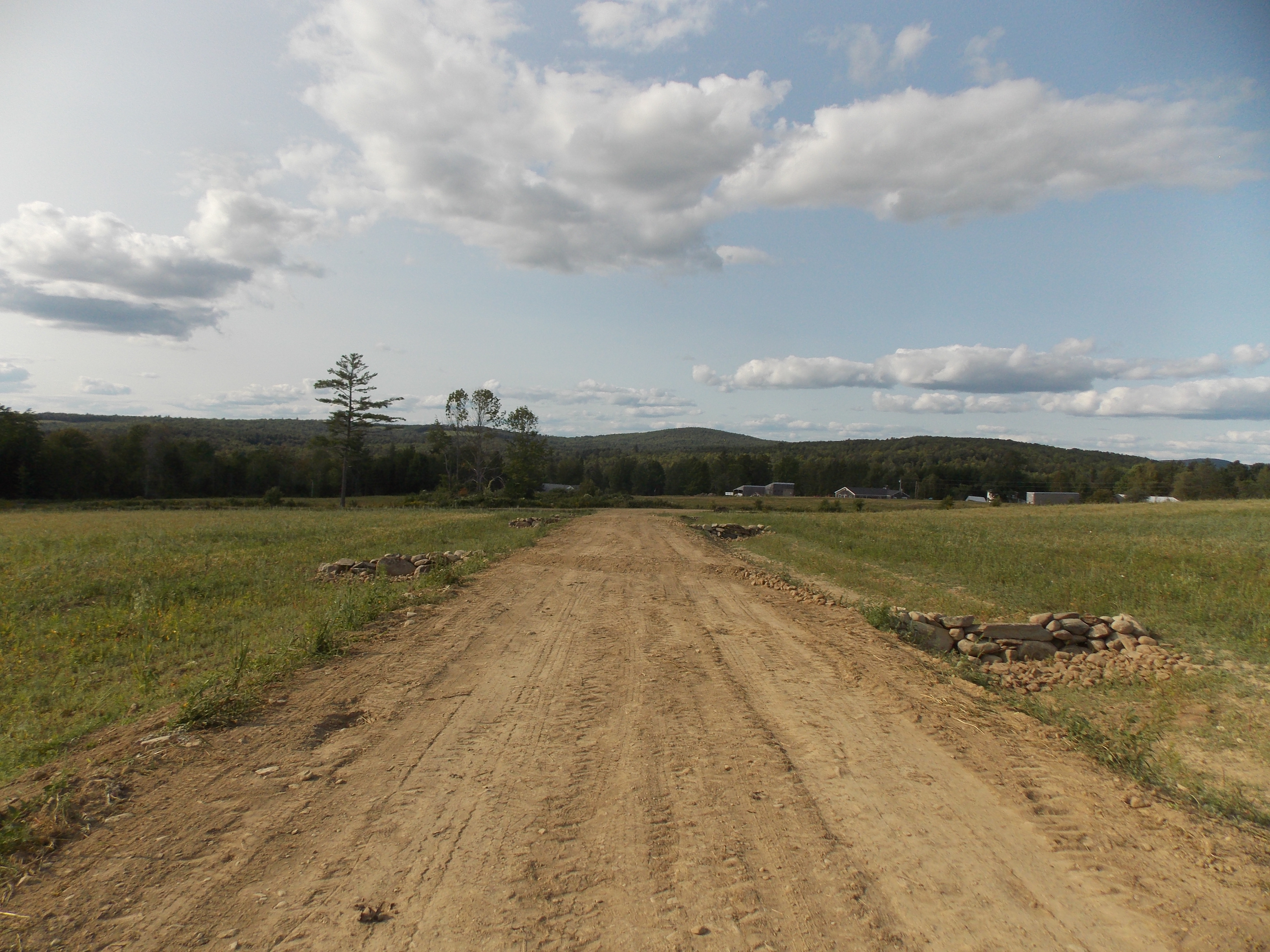

If you have water running down your tread tracks then even with a scraper, grader, grader blade, etc; you are going to be doing a lot of grading! That means the driveway you are trying to maintain has a grade, and it is not going to take much for the water to run down the depression of a wheel track and not down into the ditch no matter how much crown you put in your road. Water takes the path of least resistance and gravity.
I am not saying do not crown it, but depending upon the grade of the road, you really need a method for diverting water. If it is steep, every 100 feet, but longer spaced apart if it is less steep. There are several ways you can do this; depending on what your drive is used for and if you get snow.
The easiest in a location with no snow, is rubber razors, set at 30 degrees to the roadway, which is nothing more than a 3/8 strip of rubber conveyor belting (used) that is 8 inches wide and bolted to a 2x6 buried in the surface of the road. This upright rubber flap allows water to be diverted to the ditch, but allows cars to roll over it. This has the disadvantage of having some cost for the lumber and rubber belting, but looks and works the best.
Another method is to make water bars, again set at 30 degrees to the road. This is just a shallow dip that allows water a path off the roadway into the ditch. This method (one I use) is free because it just means forming the surface of the road, but small cars can have trouble navigating the dip, and the water bar can be plowed smooth if the road is subjected to being plowed if the location is subject to snow.
There are a few other methods to get the water off the road, but ultimately this is what you need...drainage, drainage, drainage.
You still have to crown your road, and you will still have to grade it smooth, but getting that water off your road in the first place before it gathers speed and runs down the inevitable wheel tracks has to be your first line of defense.
It is kind of hard to see because of the way the gravel blends everything together, but if you look closely at the attached photo, you can see how my road (on a 9% grade) has water bars going across the road. This channels a lot of water off the road and towards the rock check dams in the ditches to prevent erosion of my road, and the ditch.
