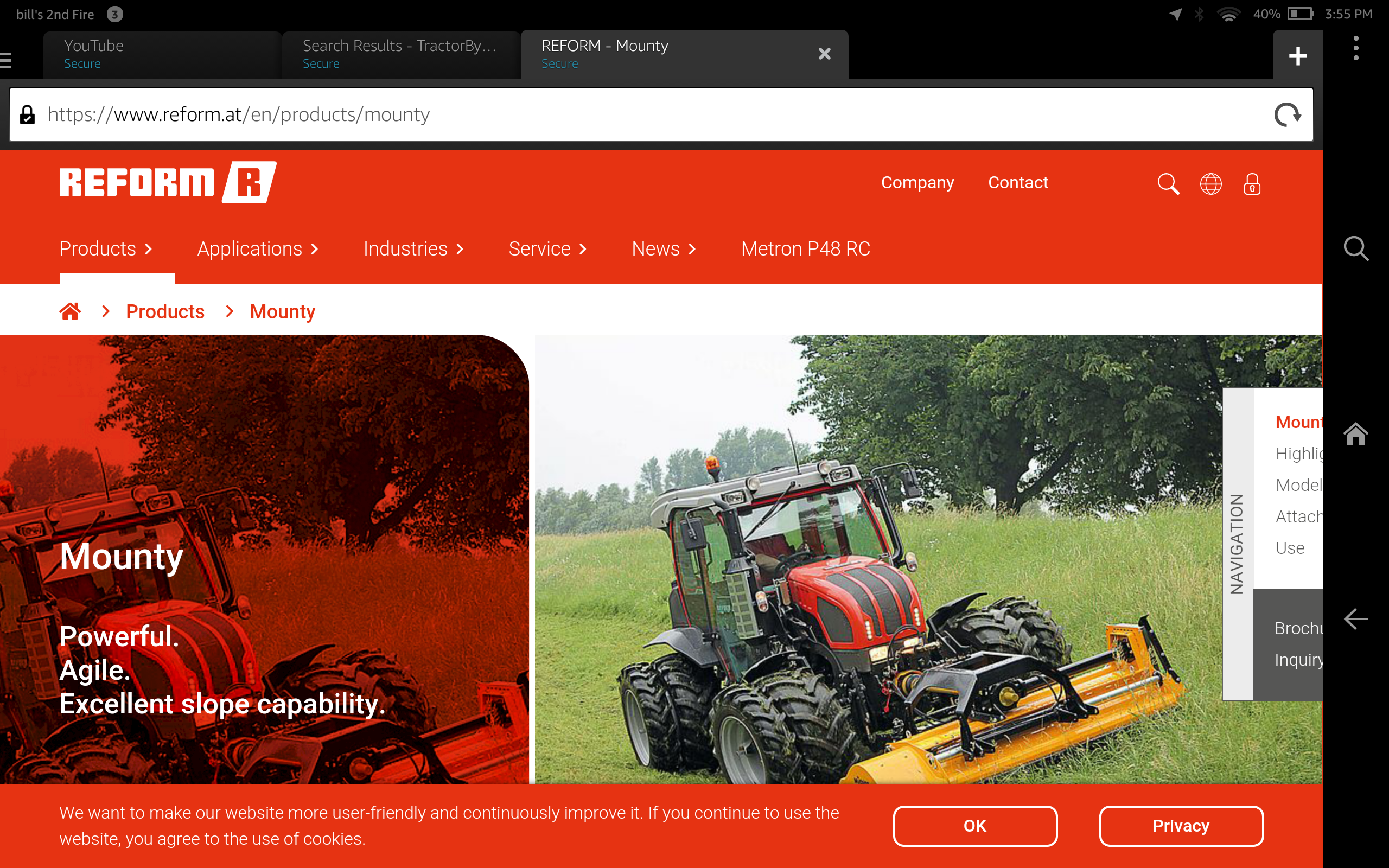

Just a slight adjustment. Some +60 hp tractors still utilize mechanical shuttles requiring the clutch to shift. And changing ranges is not so different than the car/truck shifting reference.
And just to interupt tradition, the swiss offer a 109 hp hydrostatic pump transmission in their tractor. And the deere and others IVT trannys are all hydro and actually superior to any HST in a compact. Go test drive one, you'll be amazed at the simplicity as your feet are NOT required.
