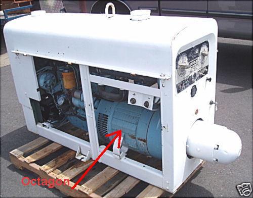

I have a 1971, and a 1974. The SA-200s with aluminum have an octagon shape generator.

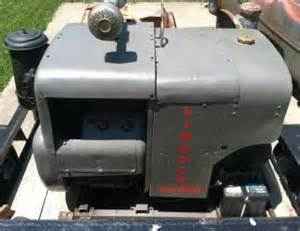

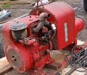

I'd sure like to get my hands on one of those short hat machines or one with the 4 cyl Wisconsin
I own one like this but need to get an engine for it or rebuild the one it has
this is like my first machine

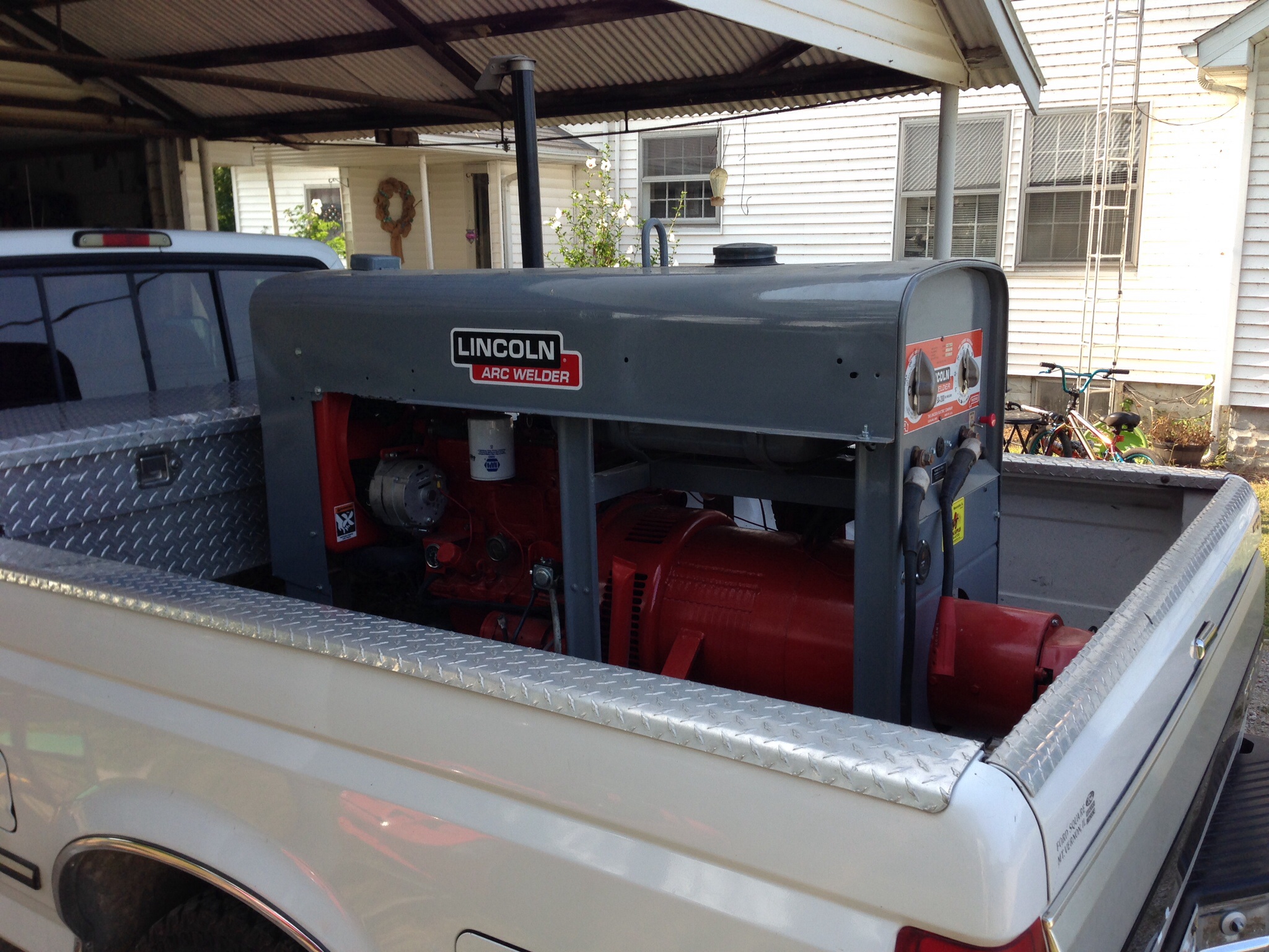

I have not used a stone or anything on my commutator, I did blow it all out with the brush covers off prior to starting her up and I made sure the brushes were free in their holders. It is a round barrel all copper generator and it really welds nice. I am far from a professional welder but this makes me look good. The R57 idler works perfect, I set the low and high RPMs with a hand tach and the open circuit voltages are right on the money. The icing on the cake is getting to hear that sweet little F162 purring through the straight pipe

   / New life to an older war horse #27

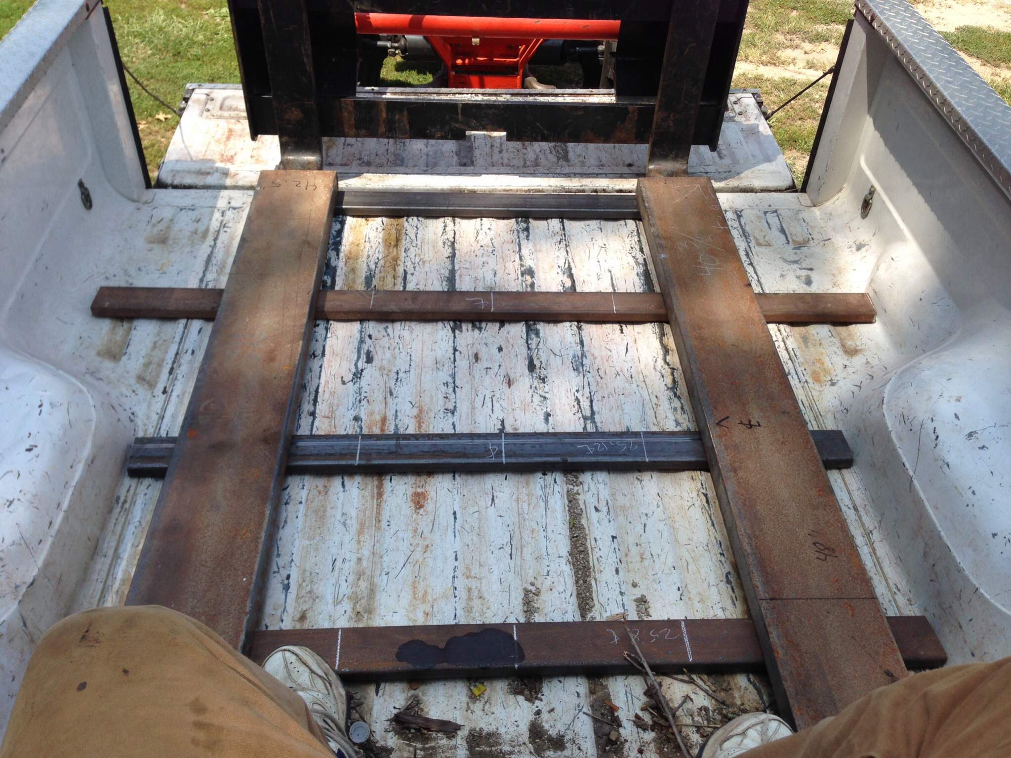

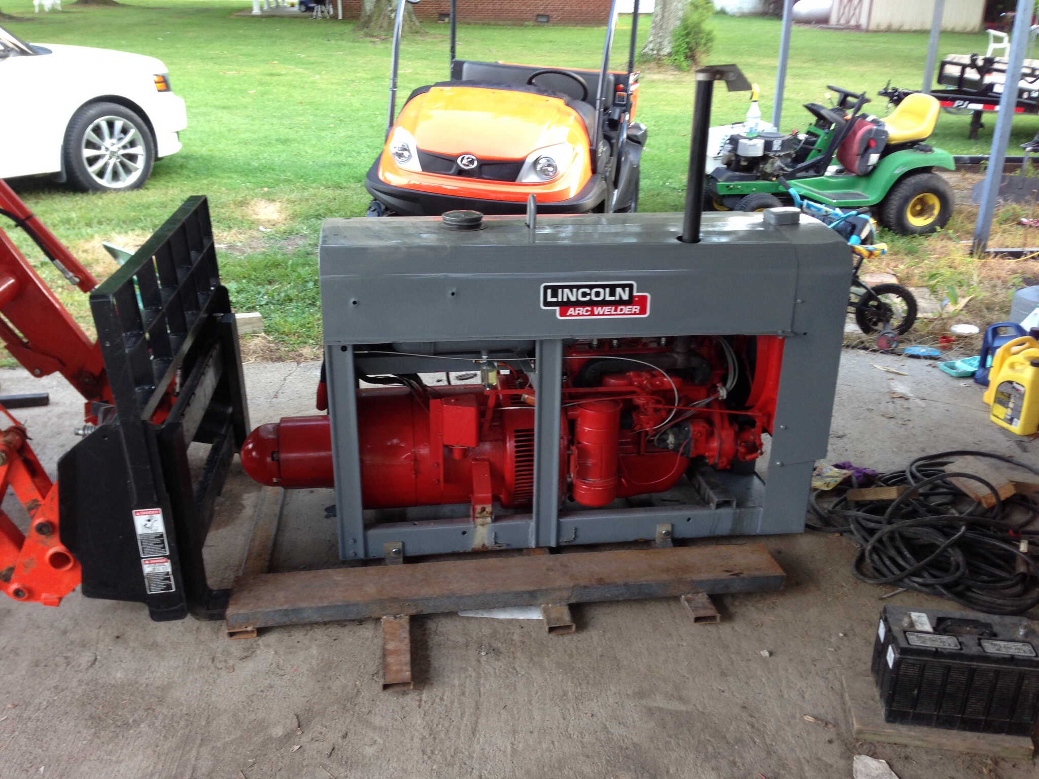

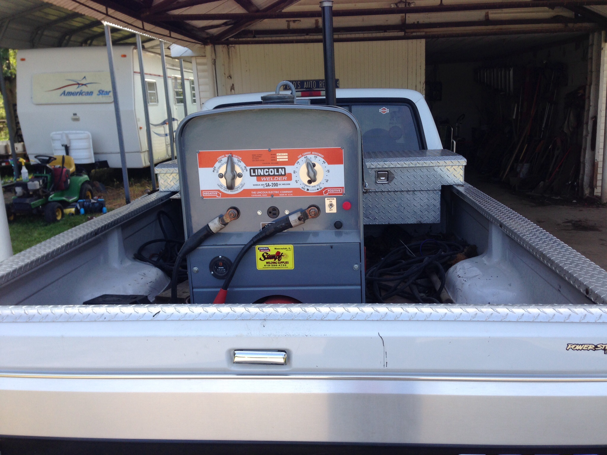

I fabricated a frame for the welder to set on that allows me to lift it in and out of my truck with pallet forks on my Kubota tractor. So far it all works sweet. Here are some pictures:

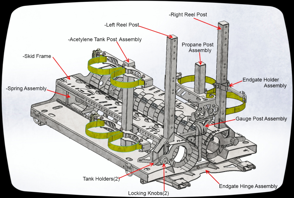

#29
here is a drawing of a frame that is designed to be full self contained unit it can be modified for several different machines
