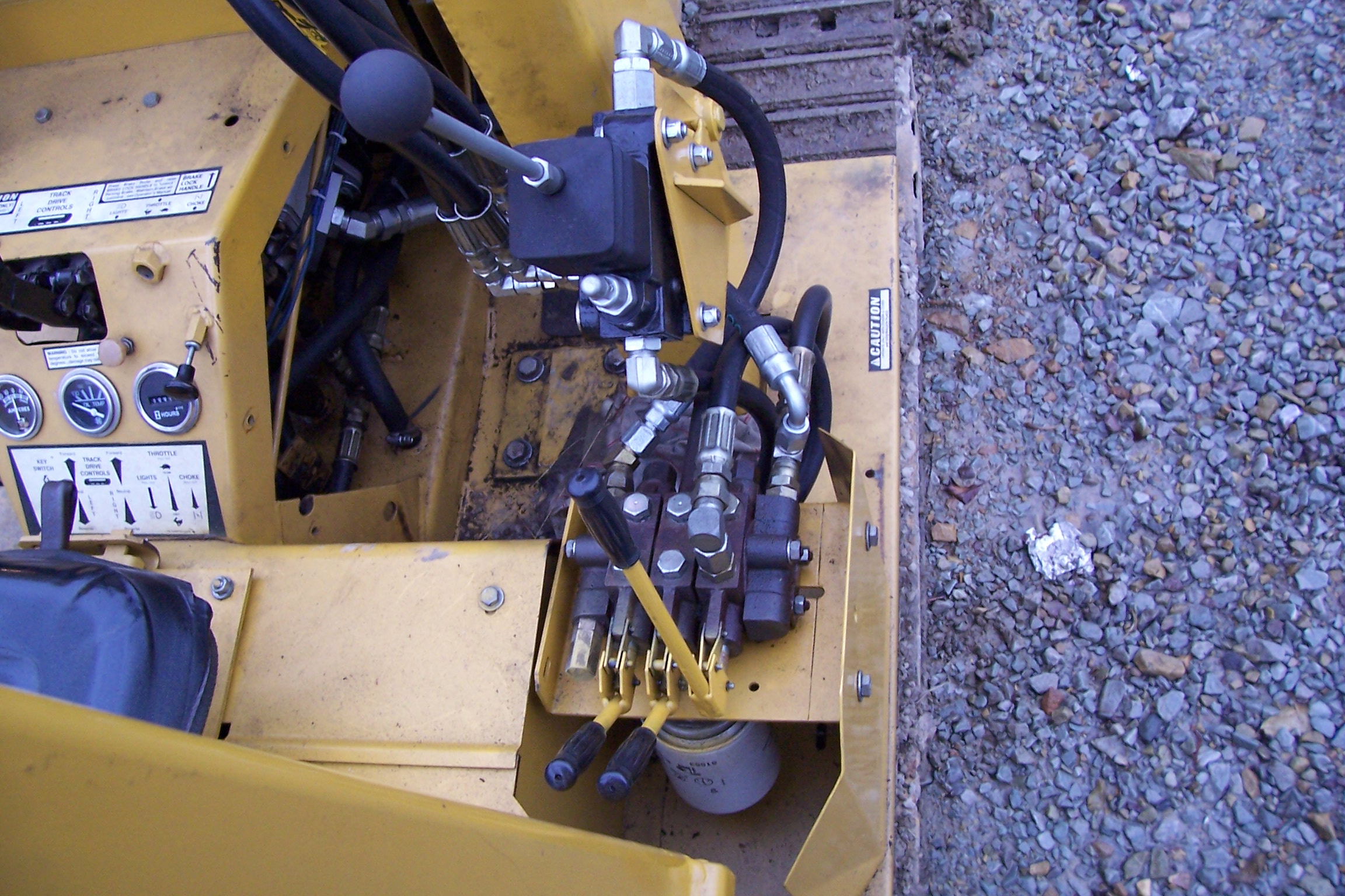

Thought I would post an update to this thread. I did replace the hydraulic pump with a smaller one than I first installed. The speed is a bit slower that before, but it now has plenty of power to dig and work the loader. The 21 GPM pump was just too much even with the flow divider in place. I can now use all functions of the loader without staling the engine. The new pump is a 1.35 CU In displacement at 17 GPM at full 3000 RPM. The factory twin pump set up is ideal to get the most of the available HP. One larger pump does take a bit more power to run. Here is a pic of the new loader valve installed. It is so much nicer to use than the factory single lever stack valve.
