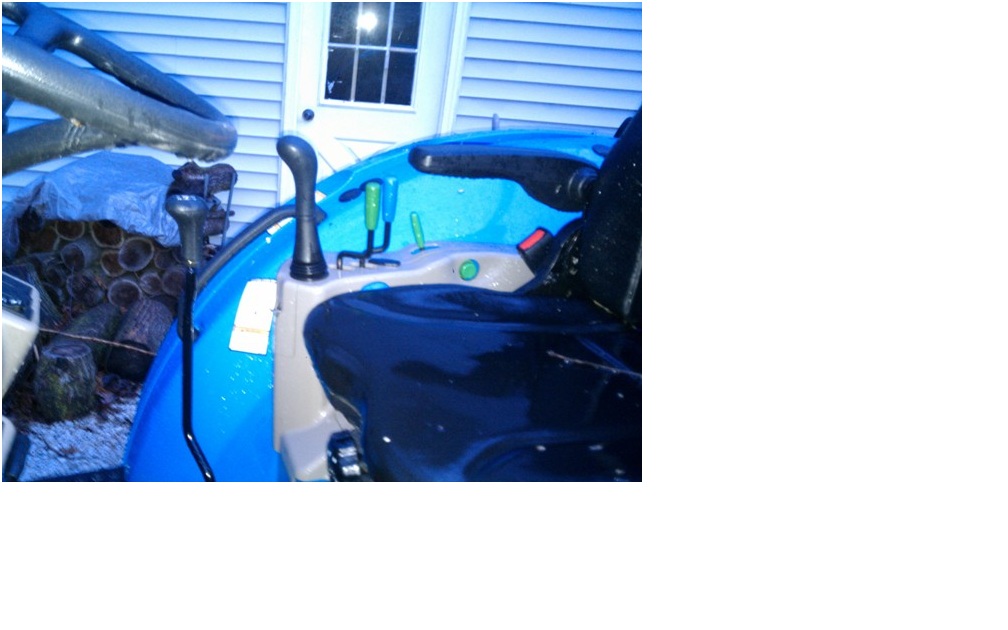

I forgot I have a picture of it.

Did you happen to pull back on the little lever on the right fender that has a green button below it. If it faces towards the back of tractor push the green button to release lever.The small lever is a feature that allows you to set the 3 pt depth and leave the setting there. Then just pull back on the I think on mine it is a green color sleeve and the 3 pt goes all the way up make your turn and get back to where you want to drop implement push button 3 pt goes right back to position. I LOVE THAT FEATURE at least I think it is a feature :). I believe LS states in the manual it is a safety lock so someone will not drop the implement by accident. I personally would never use that as a safety, the only safe way to work around an implement on the back of a tractor is to properly block it up or remove from the tractor. So I use it to set my last 3 pt down level and use the small arm to raise my arms, then i just push the button and goes right back where it was. Sweet IMO.
That is a nice feature, but the G models don't have it.

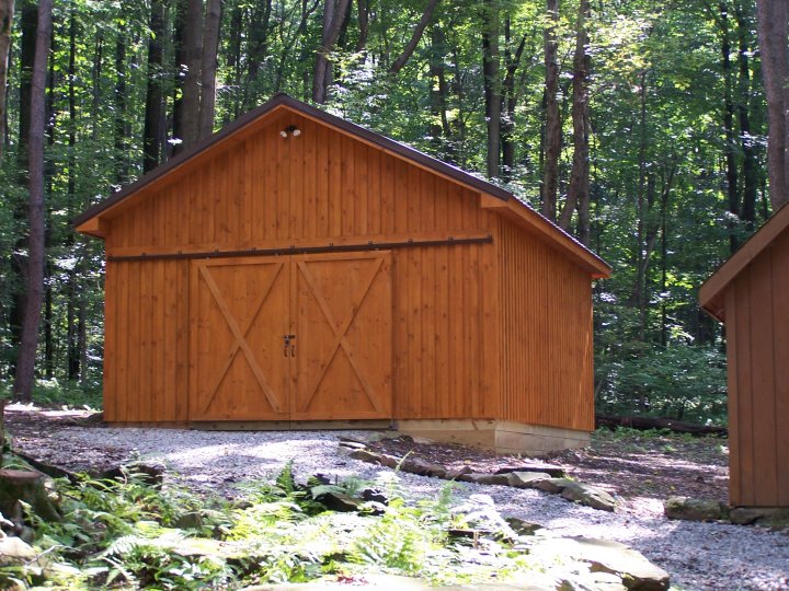

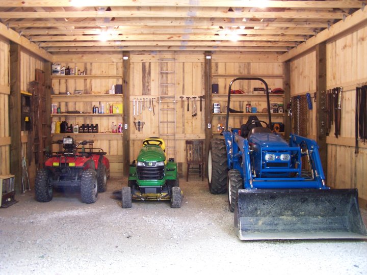

Still only have about 40 hrs on my G3033 but it's doing just fine. I gave it its biggest workout (digging and hauling dirt & gravel) when I was building a new pole barn home for it (see pictures). I very quickly learned the value of rear ballast.
When I bought it, my dealer didn't offer beet juice and I didn't want calcium, so I ended up filling both rear tires with RV antifreeze. The dealer in New Alexandria NOW offers beet juice.
Only other problem to report is a small hydraulic fluid leak at the distribution box but that just required tightening of a fitting. Also replaced the stock top link with a shorter one, which gave me more lifting height on the 3-point.
I'm very happy with this machine and I'm still trying to convince my wife that I really need a backhoe attachment for it. So far she is being totally unreasonable on the subject.
