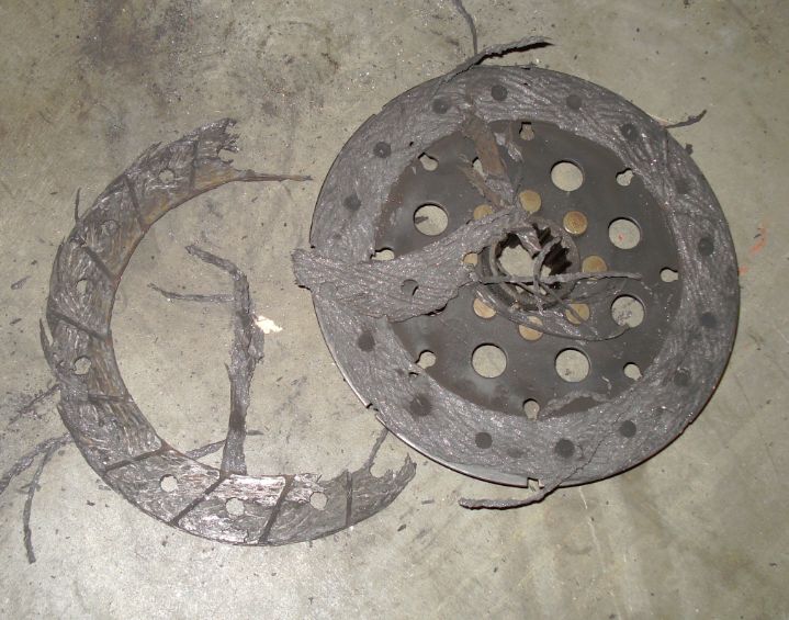

The tractor is back and was repaired under warranty. It was a loose clutch plate. Here's hoping it was a one off. Apparently this is only the second luzong that has been returned and the other one was thrashed.

Luzhong 280 Series have an external mechanism that operates the detent springs for the gearbox that is directly operated by the clutch pedal. If any gear including HiLo is not fully engaged this mechanism will not allow the clutch pedal to return to the fully upright position thus riding the clutch. We were advised the tractor would creep, the exact symptom of a gear not fully engaged. After phone discussions our client was advised we would charge a call out fee if the fault was operator error, ie gears not fully engaged. After onsite inspection it was determined the clutch was indeed faulty. A clutch, any clutch can warp and / or burn out in a matter of minutes of abuse. The client was advised if we find the clutch in this condition once dismantled it will not be covered by warranty. The tractor was collected by tilt tray, repaired and returned a few days later at our cost. To this date we have not heard back from this customer.
For the technical stuff:
After dismantling I found the clutch friction plate had totally disintegrated, something I'd never seen before. It seems the bonding process had been skipped, all that was left was the loose fibres. Luzhong, like all Chinese tractor companies source their components from other factories. Those that know, know many parts are interchangeable between different brands including Luzhong, Jinma, Foton, etc. This plate could've easily been installed in any of these tractors. The plate lasted 2 hours of use, obviously the fibres were firm enough to escape visual inspection during the assembly. Can I blame this on Luzhong quality control? No. Could I have detected this pre delivery? No. This is an error on the part of the friction plate manufacturer. Unfortunate for both myself and our client it was installed in this tractor.

There are always two sides to a story and it is good to hear your side. Looking at your pic it does seem odd but chalk it down to one of those things.
