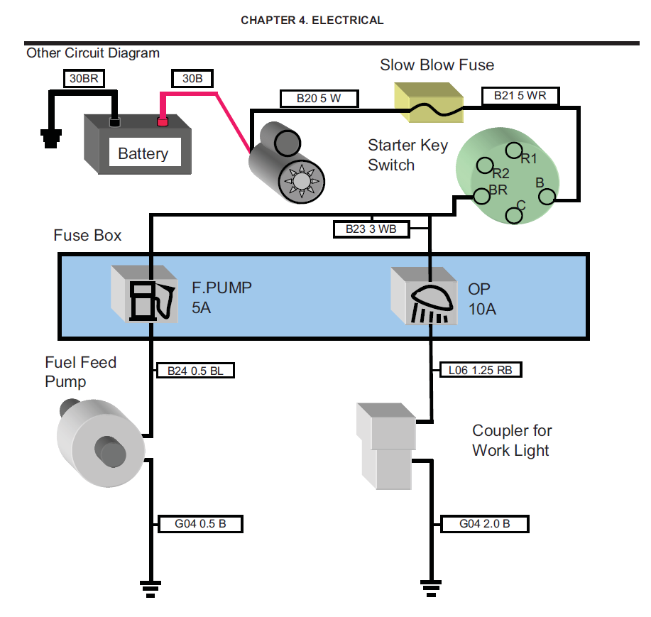

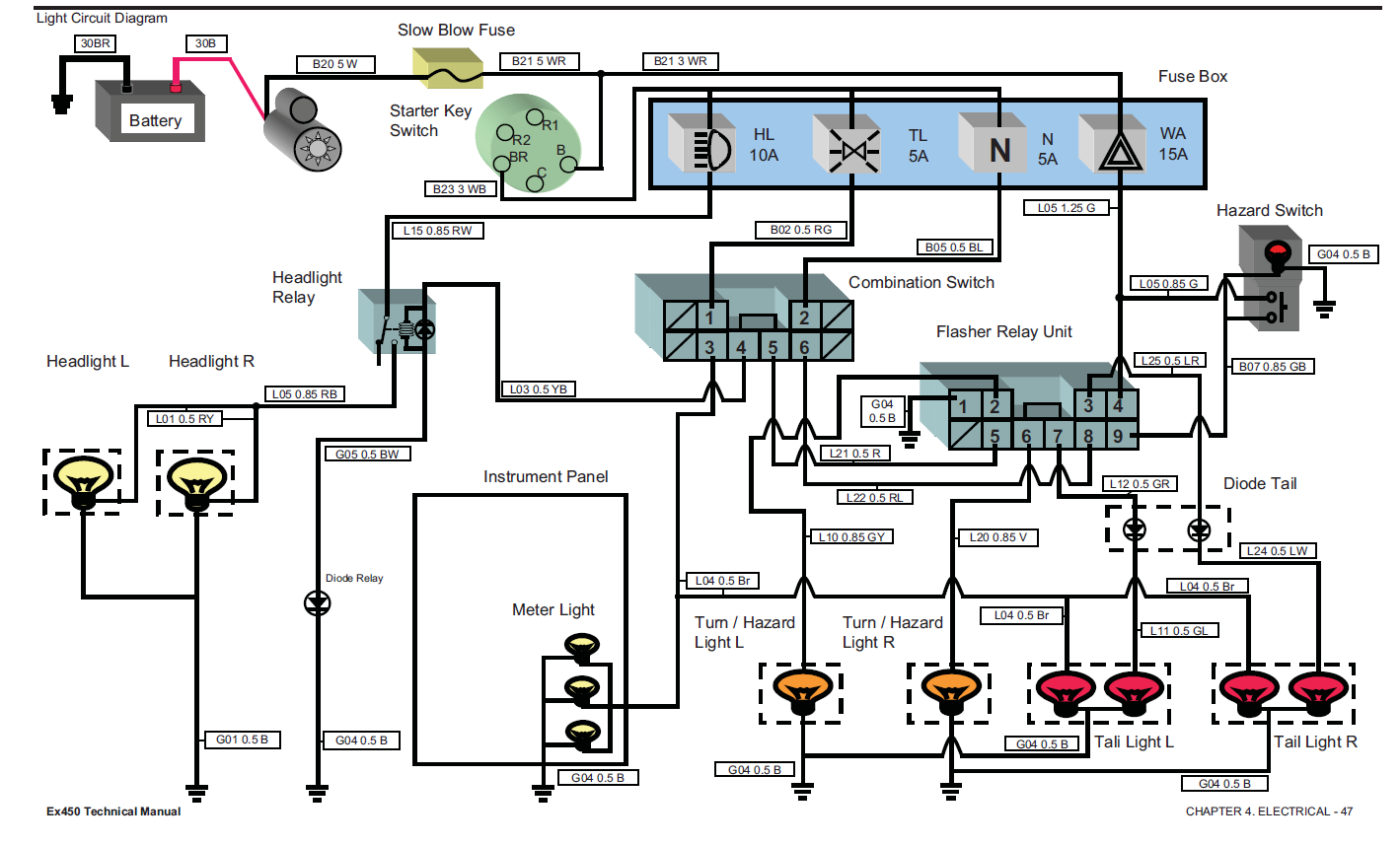

This is an old thread, so not sure anyone's still listening, but... where did you get the right side step? That is a pain to keep going all the way around, or take that big step upward.
Also - anyone have a wiring diagram for the Lx410? I can't seem to find a specific service manual for it, and I'm chasing down a repeated blown Switch Fuse. No obvious signs of frayed or chewed wires, it just keeps popping.
I have this for the EX450, wondering if its similar. Same engine, same age, same size, etc.
/ New LX410 #13
This helps a lot - thanks!
Where did you get these diagrams? I've been looking for where I could buy something like these.
