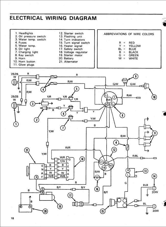

G'day AMPA you will not get any charge out of this system until you put the idiot light back in the system as it needs power to flow through this light down to the alt where it energizes the windings as the alt starts to charge it puts 12v back up this wire and turns the light off ie you have 12v + on both sides of the light it will not come on as the power cannot travel to earth. Hook up your light as it was originally and all should be well hope this helps

Jon is right. The alternator needs to have the lamp circuit to excite or trigger the output current. Many times there's room to Tee oil pressure and use a different coolant/oil temp sensor location. It's not a bad idea to keep idiot lights with gauges as the lights attract more attention. My stationary compressor as the ignition wired through temp and oil pressure senders as well as having gauges. A problem that would turn on an idiot light will kill the engine.

Hello Tread 70...I do not know where you got that info on my tractor but the wiring diagram is exactly the one in my repair manuel I think this manuel would be the operating manuel that I should have recieved with this used tractor when I bought it....but I only recieved the repair manuel which don't tell me too much .....Okay you other guys study this wirin' diagram and maybe tell me what I've screwed up...cause I know for a fact it was chargin' before I messed it up or should I say messed with it....and guys I really appreciate your interest and input on helpin'me get this tractor of mine runnin' like before....and believe me no more...advice from so called friends on improvin' somethin' that don't need improvin'............AMPA:D

:)Yes guys I was gonna' keep the amp lite at first but like I mentioned I changed out the original ignition switch and forget how it was originaly wired,maybe this is why I have two wires instead of one like the oil and temp had, ....one of the lamps had two wires and I think it was the amp lite and it probely was connected to the original keyed ignition switch, I now have only the one new keyswitch that has only one terminal for accessories so I gather I'll have to connect that W/R wire to this to activate the old idiot amp light once again, this be the only way I could connect it as the old ignition switch is long gone, I threw it in the garbage months ago, in the wiring diagram it shows this W/R connected to the ignition side of the original switch, where it became a live/hot wire when the key was activated, I've got the heavy wire (10 gauge) connected to the neg side of this new amp meter and the positive to the #30 terminal of this new ignition switch and it does show a negitive draw when I turn on the accessories(lights etc) or the pre heat to the glow plugs or activate the starter, so that part is working okay, plus the oil and temp gauges are workin' fine, the oil pressure is real good and the cooling system is fine since I had the rad tested and flushed out, it will need recoring in the near future as the rad shop told me it had quite a build up of that white stuff that to me looks like calcium from usin' water with lots of minerals in it, my only goal right now is gettin' this thing to charge again, and then I'll be relaxed, and carry on with other minor issues I have with this tractor, I do appreciate all this info about reconnecting the amp lite, take care, AMPA :)

The charging indicator is #7 in the diagram. It's wiring is Yellow/White. You will also have to have the White/Red wire. Connect them as shown in the diagram. (Both go to the ignition side of the switch.) Get a piggy-back tap from the auto parts if you have to but they must be connected.

Hi just posting back to say thanks to all you guys for the much needed info... yesterday I rewired the idiot lamp back into the system, and now the lamp lites when I turn on the new key switch ignition to accesories as it has no ignition terminal, the lamp goes out soon as the engine is started up and running ,like it use to when this ISEKI tractor had the original two switch system and no mechanical gauges , I connected the lamp in series onto the one and only accessory(A/C) terminal, the new switch has a # 30 terminal for which I have the heavy gauge wire from the solinoid connected to this #30 terminal shown in the wiring diagram for the old preheat (glow plugs) and starter switch, it does show this W/R wire connected to this one and only #30 terminal ,but one problem accures, when I connected this white with the red stripe wire,seems it creats a dead short which would have drained the battery dead in a short while, plus the green colored coil on the back of the voltage regulator gets real hot, so I decieded to connect this W/R wire to the accessories now it only seems to charge when I leave the key turned onto accesories, if I turn the key to the off position it seems to quit charging although the engine seems to bog down a bit with the key turned onto accesories to which I have the lights and everything else connected, with the key in the off position the engine runs free, like no bogging down, but I gather this bogging down has to do with showin' that the alternator is chargin', I checked the chargin' system usin' my VOM meter yesterday after rewiring the system, and it reads out around 14 volts or so with the key in the on position, I now gather it's workin, like before, just a little concerned about that coil on the back of the regulator, could this be shorted out from messin' around with it or is this normal, I'd like if possible some feed back on this hot coil issue, if the regulator sounds like it is defective I could replace it with a new one, to save problems on down the road, anyhow guys at least the alternator seems to be doin' it's job,. so once again to all you guys who helped me sort out this chargin' problem and saved me from changing out a perfectly good alternator...... a whole bunch of thank you's.....take care AMPA

It sounds to me like your regulator is working. The "coil" on the bottom of the regulator is a ballast and it's normal for it to get warm. But the regulator needs to be bolted down and grounded. I'm not following your problem with the switch. The diagram for this model is quite simple. Did you replace the switch with the same kind or something you're just trying to make work?
Don't run the engine with the W/R wire disconnected. You'll cause the alternator to overload itself. It will keep trying to increase current output until it burns itself out. That's probably why it bogs down when you turn the ignition off. Your wiring is not correct. Don't run the engine!
Sit down and draw a diagram of the way you have it wired now and compare it to the diagram posted. The W/R wire is your charge lead from the alternator. It will spark when the engine is running--It's charging the battery. With the key off, it's disconnected from the battery.
What type of cut-off is on this machine that you can run the engine with the key off?

This tractor is a diesel 3 cyl. and don't need an ignition switch like a gas engine.... the headlights etc ran off the old key switch for which I could use a screw driver to activate the pre heat (glow plugs plus the starter) on this tractor.....and this tractor sits outside where kids could start it....so now it can only be started with this new key switch I picked up from a KUBOTA dealer....and the #30 (HOT) terminal has a 10 gauge wire from the selonoid to this #30 terminal...at first I connected the W/R to this terminal as well like in the wiring diagram.. but if left on this terminal it was live all the time and would have killed the battery or burned out the wiring and maybe causing a fire.... so I used the accessory terminal as my ignition ...so it can be disconnected by turning off the switch to remove the key, I have installed two toggle switches to turn on and off the headlights/ back spot lamp etc...the old switch controlled these....but then again with this switch in the off position the alternator to my knowledge this W/R which runs to the regulator would be disconnected from the system.....anyhow it now charges if I leave the key in the on position I only needed to know if the rectivefier on the voltage regulator runs hot and is normal...or is this regulator defective and needs to be replaced....I need this charging system in perfect working order for the coming winter months as this is the tractor I use for snow ploughing.....Ive since added a finish mower and now it will be an all season machine....so I'll be selling my small lawn tractor...no sense having two machines when one can do everything......anyhow Ken thanks for your input....take care....AMPA
