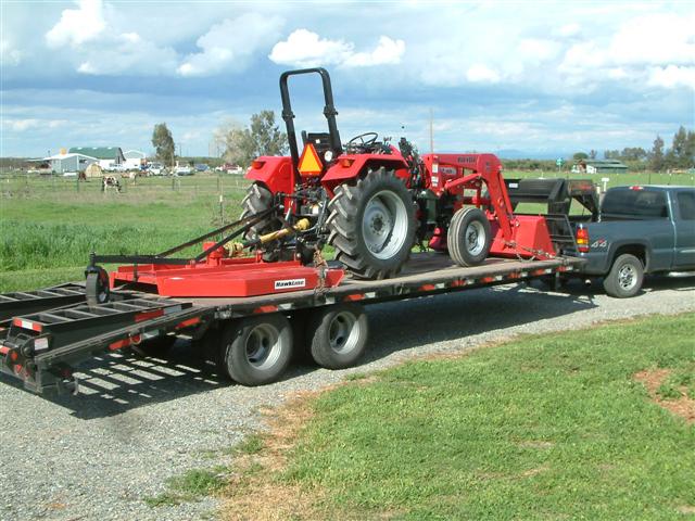

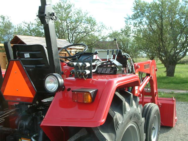

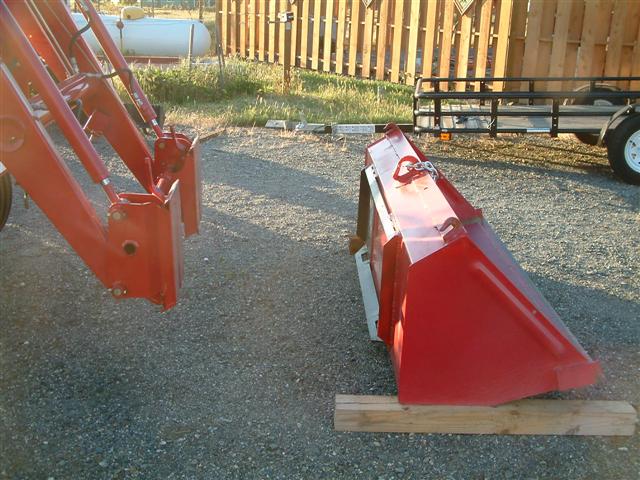

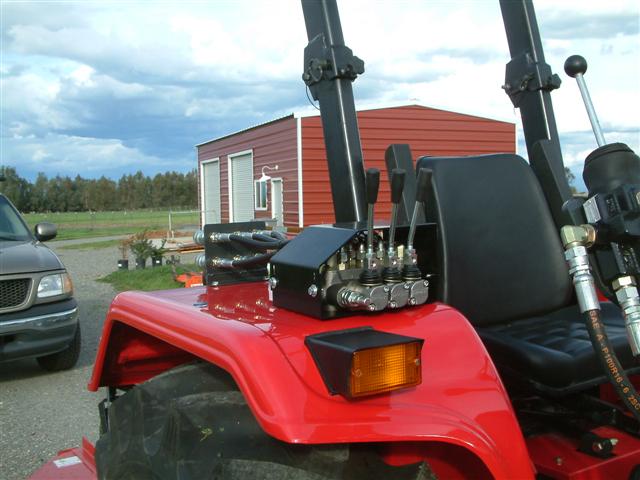

I'd look for a 35-45 hp (pto) tractor, HST, 4WD, power steering, FEL with 6-ft wide bucket (chain hooks welded to the bucket, skid steer quick attach is a really useful feature on an FEL), dual rear hydraulic remotes.
My everyday tractor is a 2008 Mahindra 5525 (54 hp engine, 45 hp pto, 2WD, power steering, gear tranny 8F/2R, triple rear hydraulic remotes) with the ML250 FEL (6-ft wide bucket, 2950 lb lift to 10.5 ft high, three chain hooks, skid steer quick attach). Cost: $19K (new). A tractor like this with HST and 4WD would be ~$25K (new).
DSCF0051 (Small).JPGRemotes 5525-1.JPGRemotes 5525-2.JPGDSCF0110 (Small).JPG
All of the major tractor brands have similar packages.
Used tractor? Since this is your first tractor, be careful. Take someone with you who knows tractors if and when you want to get into the used tractor market. Used tractors are like rental equipment--some of it is OK, some has been abused. The trick is to know which is which. Here's where experience is invaluable.
Good luck.
