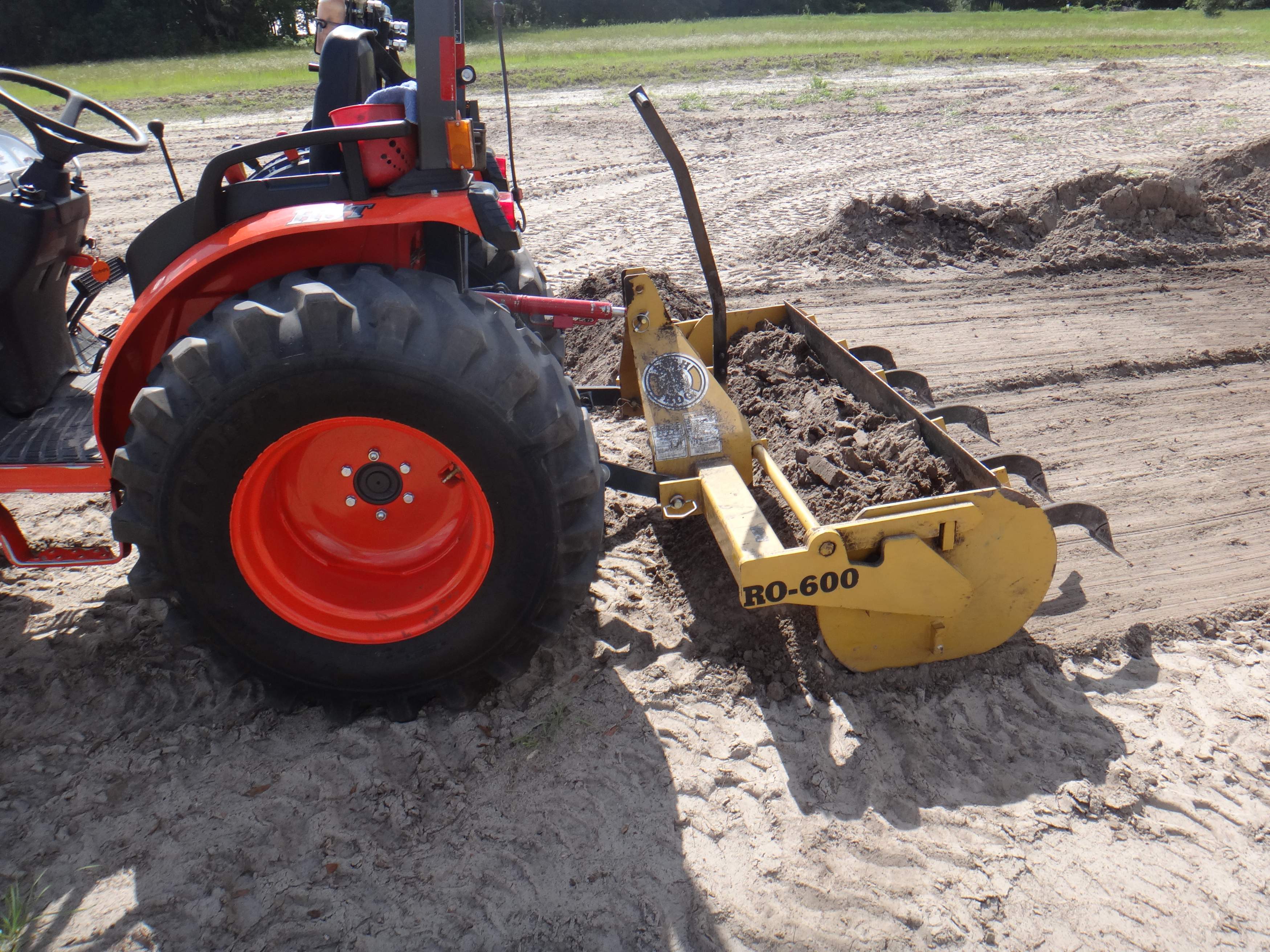

1. Box Blade, Rollover Box Blade or Rear/Angle Blade for these jobs. Ideally your tractor will have rear remote hydraulics so you can manipulate implements from the operator's station, rather than having to get on and off the tractor to adjust the Three Point Hitch manually.

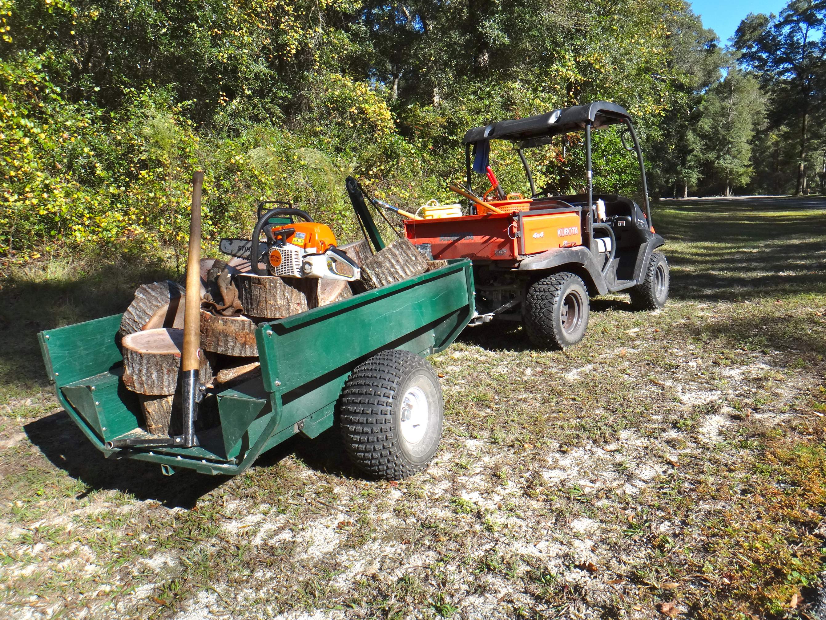

Consider an all-terrain trailer for your ATV.
LINK: MUTS - Multi-Use Trailer System for your ATV, Quad and 4 Wheeler - Welcome
