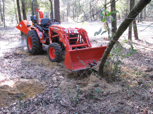

On your way down South, stop by and I'll show and tell my Kubota B 2920, 29HP with loader. Maybe not enough HP for you but after two years I like my tractor. Kokomo, IN. 46902. Right off HWY 31, at HWY 22. Stop by anytime, and just chat and coffee. Javahjoe, MIO, aka Don
I am currently looking at a B2620 with loader. I sure would appreciate any impressions you can share. Is the weight ok? Do you have filled rear tires? Do you use a weight box or implement when doing loader work. Would the B2620 pull a 5' bush hog or would 4' be a better choice with 19 HP at the PTO? Finally could anyone comment on price? I was quoted $15800 with loader and filled rear R4 tires (Methanol or Ethanol I think)
