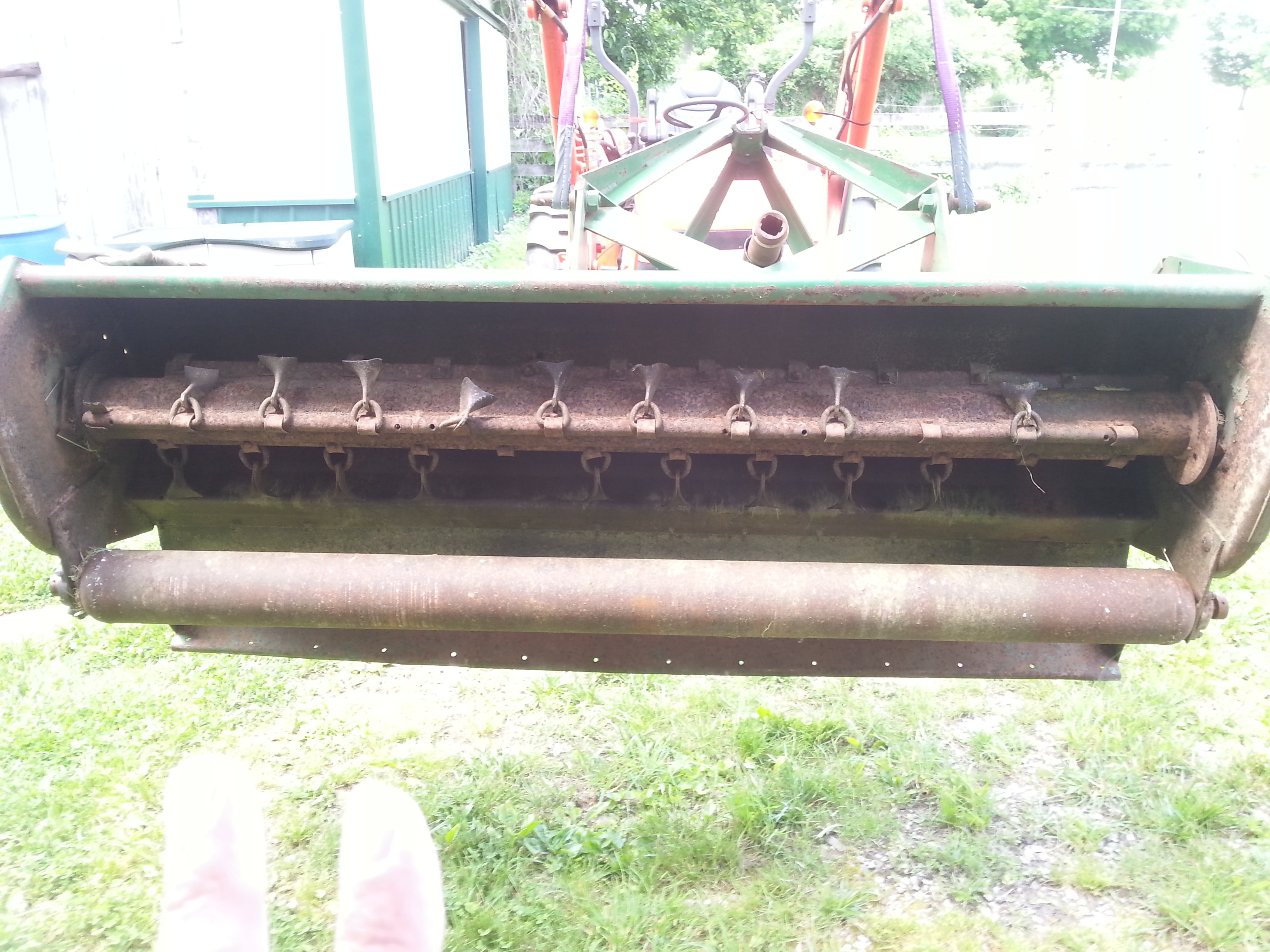

I just noticed something. The way my blades are oriented, the rotor and blades are apparently spinning the same direction as the tractor tires moving forward.
I thought they all chopped in the opposite direction and pulled the material up and over the rotor. ??? I didn't notice the direction when I saw it run. I was concentrating on sounds like bearing noises I guess.
   / New member. New owner JD 25 A Flail mower. Help! #39
I just noticed something. The way my blades are oriented, the rotor and blades are apparently spinning the same direction as the tractor tires moving forward. <img src="http://www.tractorbynet.com/forums/attachment.php?attachmentid=511322"/> I thought they all chopped in the opposite direction and pulled the material up and over the rotor. ??? I didn't notice the direction when I saw it run. I was concentrating on sounds like bearing noises I guess.
Normal, 25A spins the same direction as the tires.
