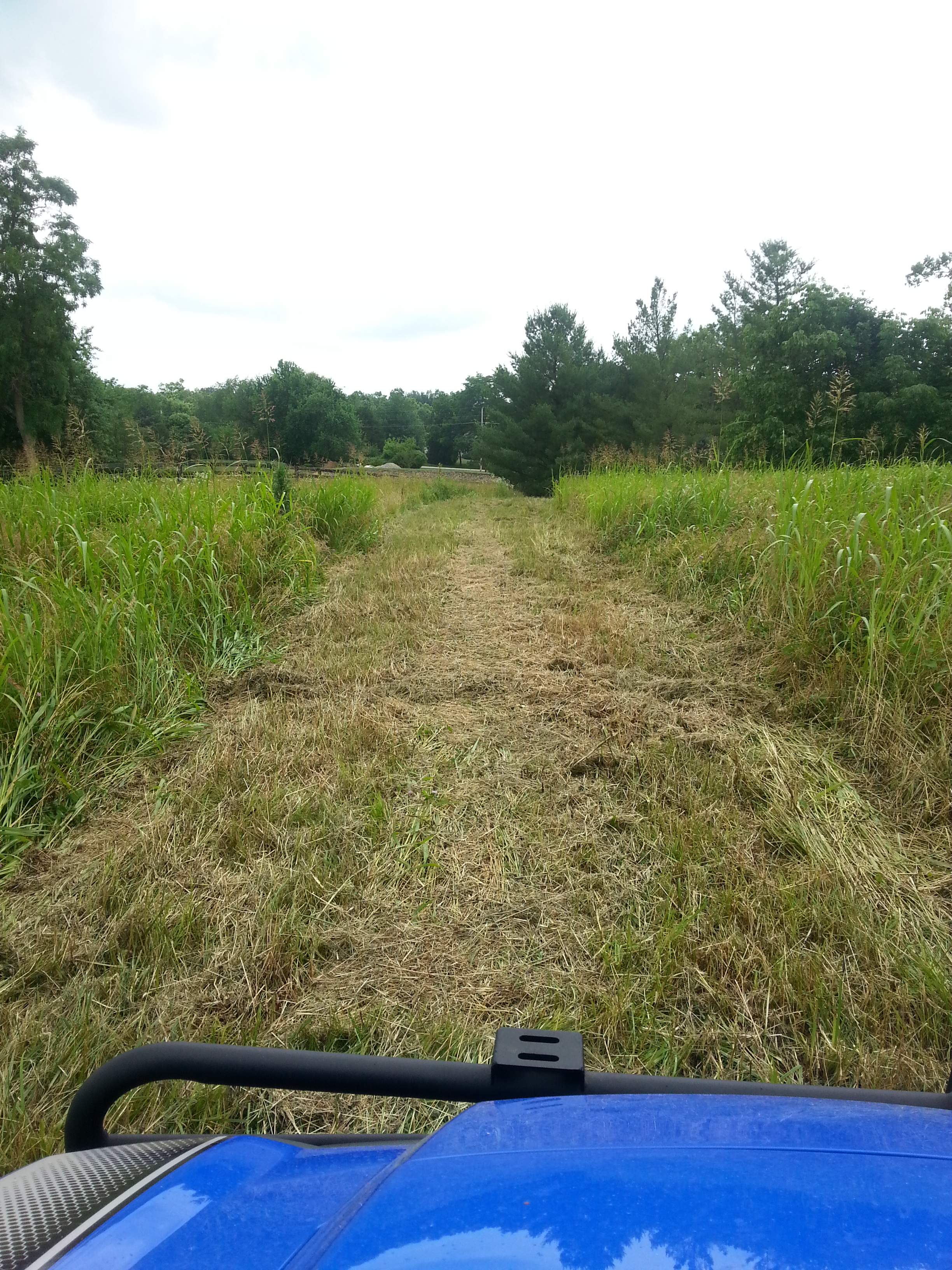

Here is a photo of the test run looking over the hood of the Mule. Set on the 3.5" setting and leveled out. Will be taking Shaeff's advice and dropping the blades down a setting to 2".
The long dead grass is from my last bush hog job in the fall. Hoping to avoid this in the future.

Thanks everyone for the responses. Here is a photo of the test run looking over the hood of the Mule.
Exactly what mine looks like set at 3.5". Drop that sucker down a notch or two and it'll cut much nicer. Especially with all those new knives you installed!
My 25A is trashed, bent up, twisted, the knives are all chipped and bent, dull, and it still cuts decent. (As seen in the pic above) I bet yours will cut beautifully once you get it set up right.
Remember to set it up on level ground and use a bubble level on the gear box. Setup is not as forgiving as a brush hog, but when set right should yield very good results.
