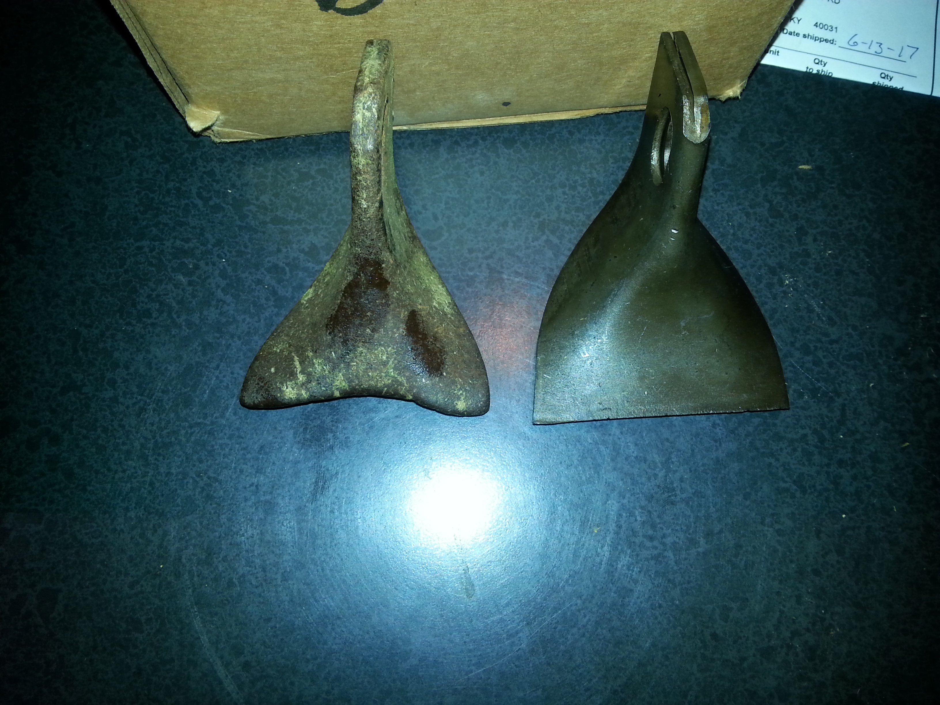

Old knife next to new USA knife from Flailmaster.

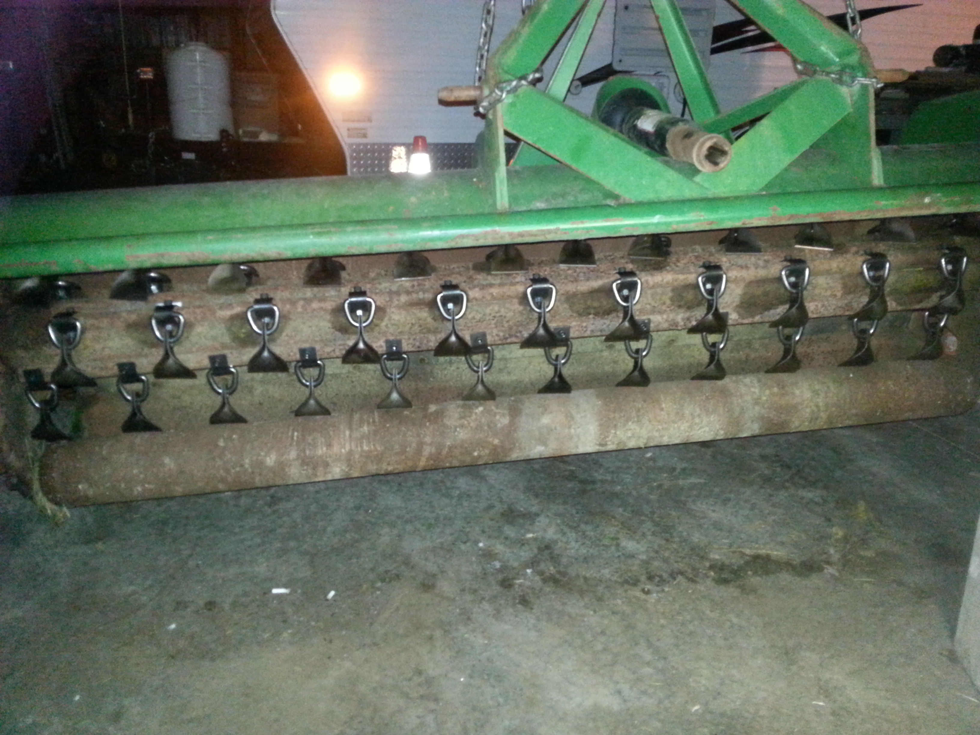

Here's her new smile
My neighbor came over today and we checked gearcase oil. greased the bearings, Set mower roller to 3.5" setting, leveled the gearbox with top link.We ran it out and tested it out.
Good news, she purred. Smooth and quiet. Not real impressed with cut vs finish mower. On the field I only cut a handful of times per year, much better results than bush hog, but slow ground speed was necessary. My neighbor cut and I watched since I'm still on injured reserve with my crushed pinky. More when I don't have to type one handed.

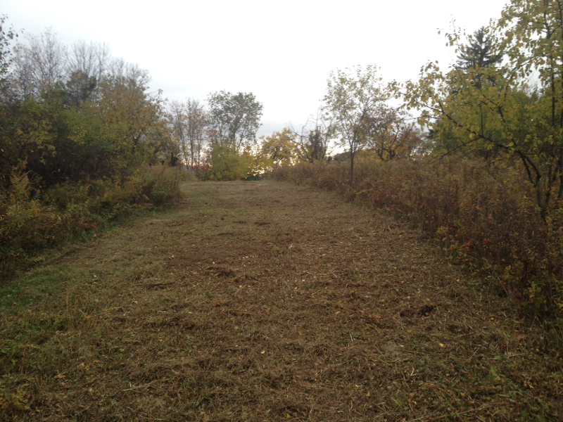

Try cutting at the 2" setting. I'm not impressed with mine at 3.5" either. Try it at the 1/2" setting too, you may be surprised. At 1/2" mine cuts probably 2.5" or so. Yours may vary but this is mine on the 1/2" setting. You can see how high the weeds were to start:
