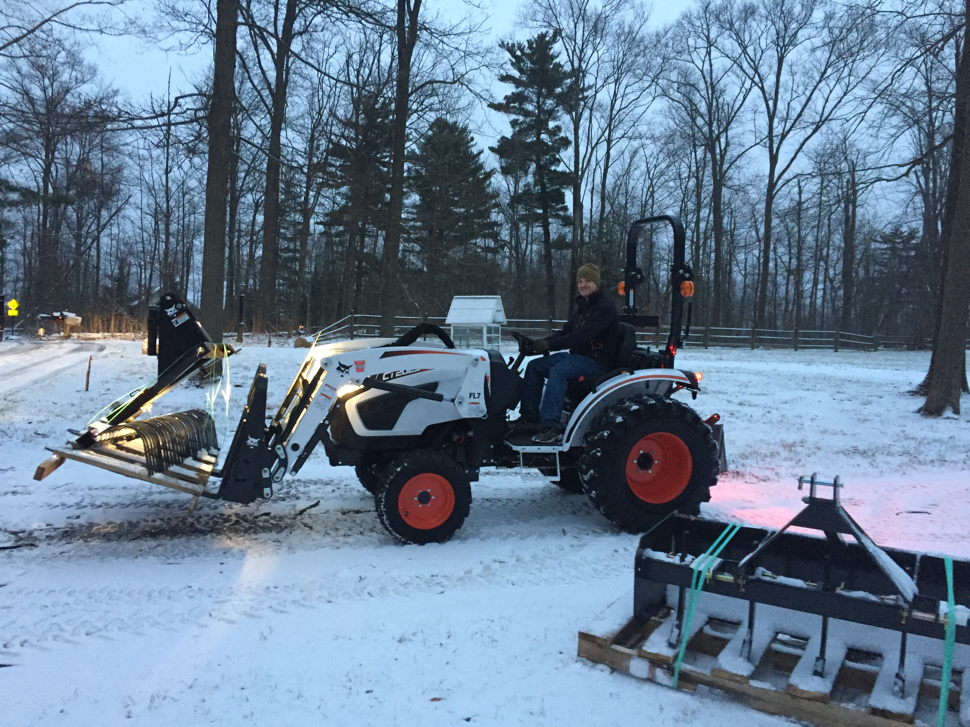

New member here, just got my new tractor last week. Bobcat CT2025 HST. I ordered it with R4 tires, front loader, 2 pairs of detent remotes, linked pedal, toolbox, 60 inch box grader, 2500 lbs forks, and a tine rake.
I plan on adding some LED work lights, a beacon (I run it down the road every now and then), cruise control, and a third function down the line, as well as some other implements.
I mainly will use it for moving things, grading, and eventually some snow removal.
I joined this forum to learn more as this is my first compact tractor. It seemed to be a good value and it was considerably cheaper than the Kioti CK2610H I was quoted. The dealer was also top notch.

I finally received a few more accessories and installed them:
The cutting edge included hardware, is reversible, and is easy to install.
The rear work light: It is literally an incandescent light that bolts to a bracket on the back of the fuel tank and plugs into existing leads. The switch to turn it on is built into the light housing itself. Had I known it was not LED I would not have paid about $100 for it. It was easy to install and seems to be bright enough.
Cruise control: It was about $200 for the kit. It is an electromagnet and wiring harness plus easily into the existing harness. Hardest part was removing the steering wheel. You will need a puller that has two very close holes, or a steering wheel puller. Works flawlessly and overall easy to install. Instructions are clear.
