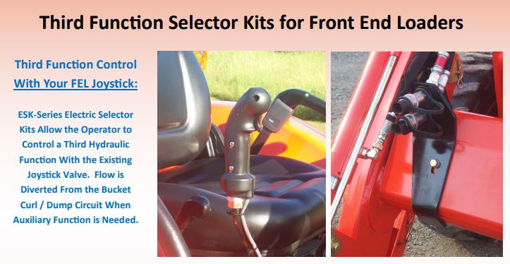

Unless your remote lever is in very close proximity to your loader valve.....forget using the remotes.
And even if it is close, I would think it to be very cumbersome to keep swapping your hand from loader valve to remote valve and back again.
Either a diverter or 3rd all you to keep your hand on the loader joystick at all times. Much more natural and ergonomically laid out....an productive.
Why are you so stuck on OEM not offering a kit? Aftermarket works well and is affordable and proven
   / New member ,new tractor! New grapple #13
The MIE Third Function Kits offer the following unique operating characteristics:
All MIE 3rd Function Kits use a proprietary Manifold with "Continuous Power Beyond". In other words, you do not interrupt the Power Beyond flow to the back of the tractor while using the Loader 3rd Function.
Because of the "Continuous Power Beyond" feature, you cannot dead-head the tractor hydraulic system with the 3rd function.
Our Manifold includes a pressure compensated Flow Control Valve. This allows the operator to adjust the flow to the 3rd Function so you can set how "quickly or slowly" the implement responds to the Joystick Control Button.
The 3rd Function Manifold also includes an separate Pressure Relief Valve dedicated to the 3rd Function Circuit.
Our kits are offered as "On-Off" with adjustable metered flow, or Proportional Control with the use of a Joystick Slide Switch.
We have listened to our customers and have developed a 3rd Function Kit that addresses the comments we received. We also offer our Electric Selector Kits, which have had a long history of solid performance for Grapple and front Snow Plow applications.

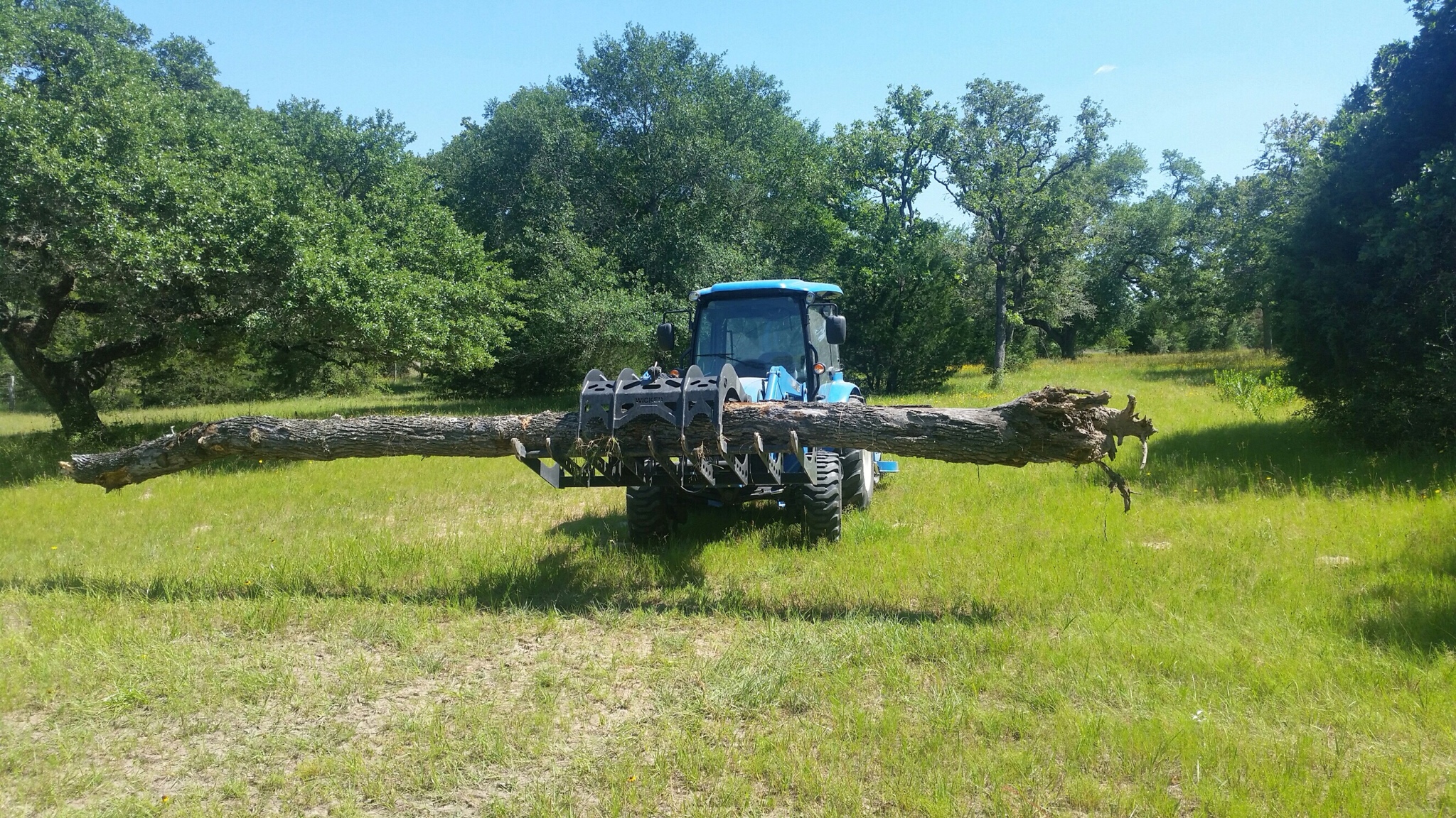

Unless you have NO plans for the rear remotes - a third function on the joy stick is sure nice. I have a WR Long third function(electric over hydraulic) on the joy stick for my grapple. Its a true pleasure.
   / New member ,new tractor! New grapple #16
I’m on my 3rd WR Long Kit and very satisfied. One on my New Holland TL100A, one on my LS XR4155HC, and one on my previous LS XR4046HC. I’m sure there are other fine 3rd function kits out there but the WR Long kits work very well.
I wouldn’t consider trying to use rear remotes for a microsecond. IMHO it would be unwieldy at best trying to move your hand from FEL joystick to finding the correct remote handle then back and forth. It would undoubtedly be slower operation. Many TBN members are doing it this way but, I suspect it’s because they’ve never had the opportunity to operate a true 3rd function. Your hand never leaves the joystick and operation of your grapple becomes muscle memory quickly.
