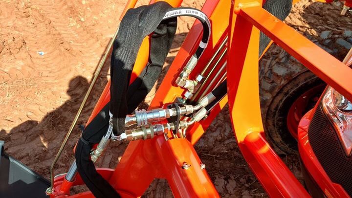

Wow it would be cheaper to grow a third arm to operate the rear remote. This thread got way off kilter,like I originally posted im using the rear remotes.got lines made up with pioneer couplers the other day.156.00 canadian total. Thanks to all those who offered advice , I had no intent for this to turn into a marketing scheme for others. By the way Travis I just got my grapple ,looks awesome!
