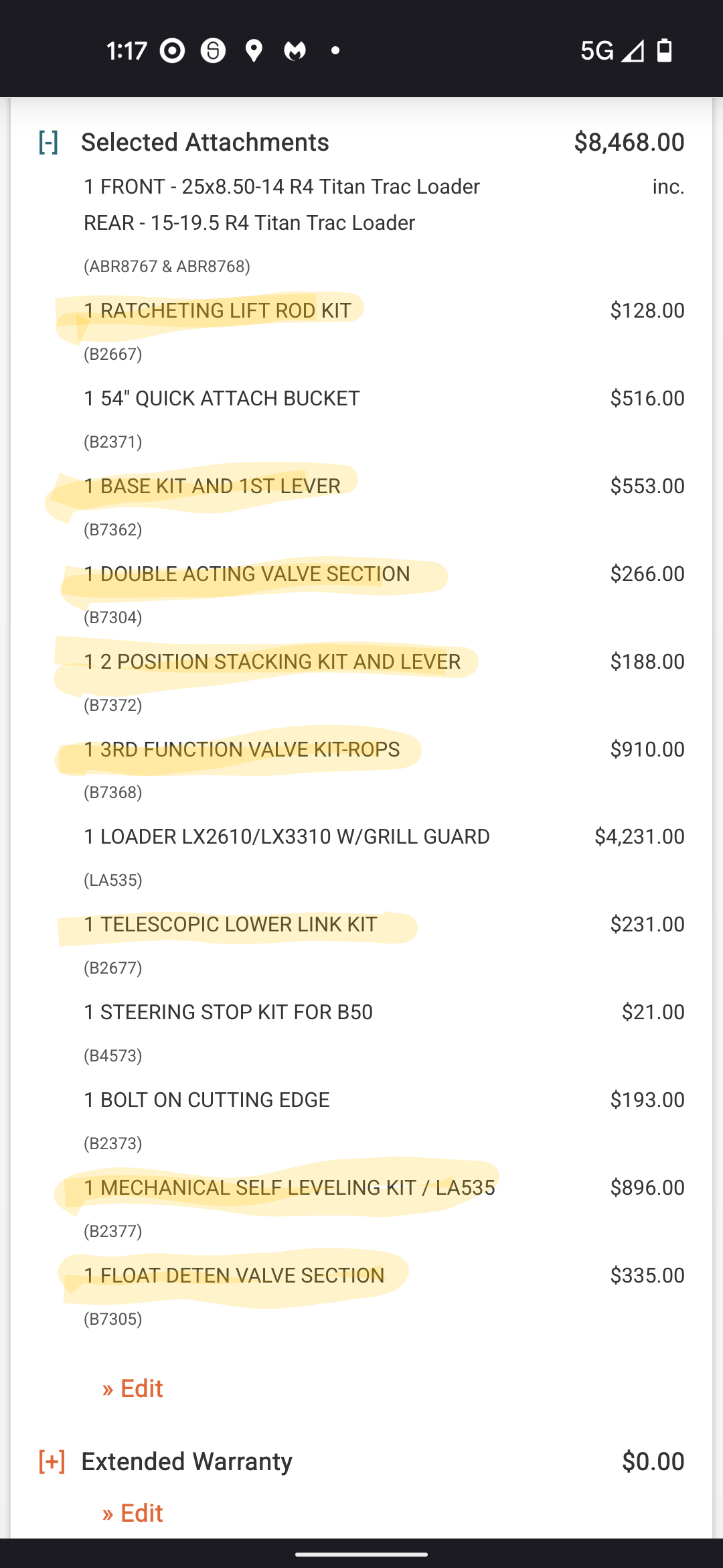

What I'm trying to figure out is, given these variables, are there any other advantages to the LX2610SU that warrant the $5k price differential between these two machines? They seem very similar besides the 3ph and maybe the footprint. I will take your advice regarding the L2501, it did seem overkill for my lot size and future upsizing and I do prefer the easier to reach loader joystick on the Yanmar and the LX2610SU.
I appreciate your insight on not wasting money on tillers and going with the toothed blade adapter for my needs. Also, point taken on the BH, I do have one I can borrow when I need but I will reconsider purchasing one since I can rent a mini excavator or trencher for gutters and whatnot. Also, please don't take my comments the wrong way as they may seem argumentative or all over the place, I am very appreciative of your help so far and just want to make sure I don't have any regrets post-purchase, hence the many questions and comments. So far, I am still leaning towards the LX2610SU.
Do you recommend any of the following highlighted items on this LX2610SU build?
