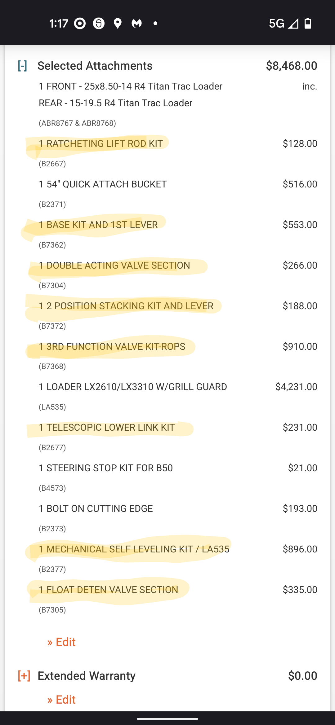

Thank you, agreed. The extra $3-5k is worth being able to use and adjust a wider range of 3ph equipment - especially an auger.
Regarding the LX2610SU, do you have any feedback on options/attachments?
I spec'd one online and selected the following, anything I may not need or may need - I'm not super familiar with some of these items.
About the limited 3PT travel, that can be easily compensated with an adjustable top-link. Thus, more 3PT equipment can be used. My original top-link was short. I upgraded to using the John Deere equivalent to my machine. Now I have no issues. See 3PT attachments in my signature. 3PT post hole auger is one of them too.

1 SWIFT TACH KIT WITH 1 LEVER QUICK COUPLER FOR ROPS TRACTOR $794.00 (B2386)
Watch this video. "SWIFT TACH" is an option distinct and separate from the SSQA bucket-to-FEL coupler.
Sorry. My error. I try to keep up with Kubota offerings.
VIDEO:
