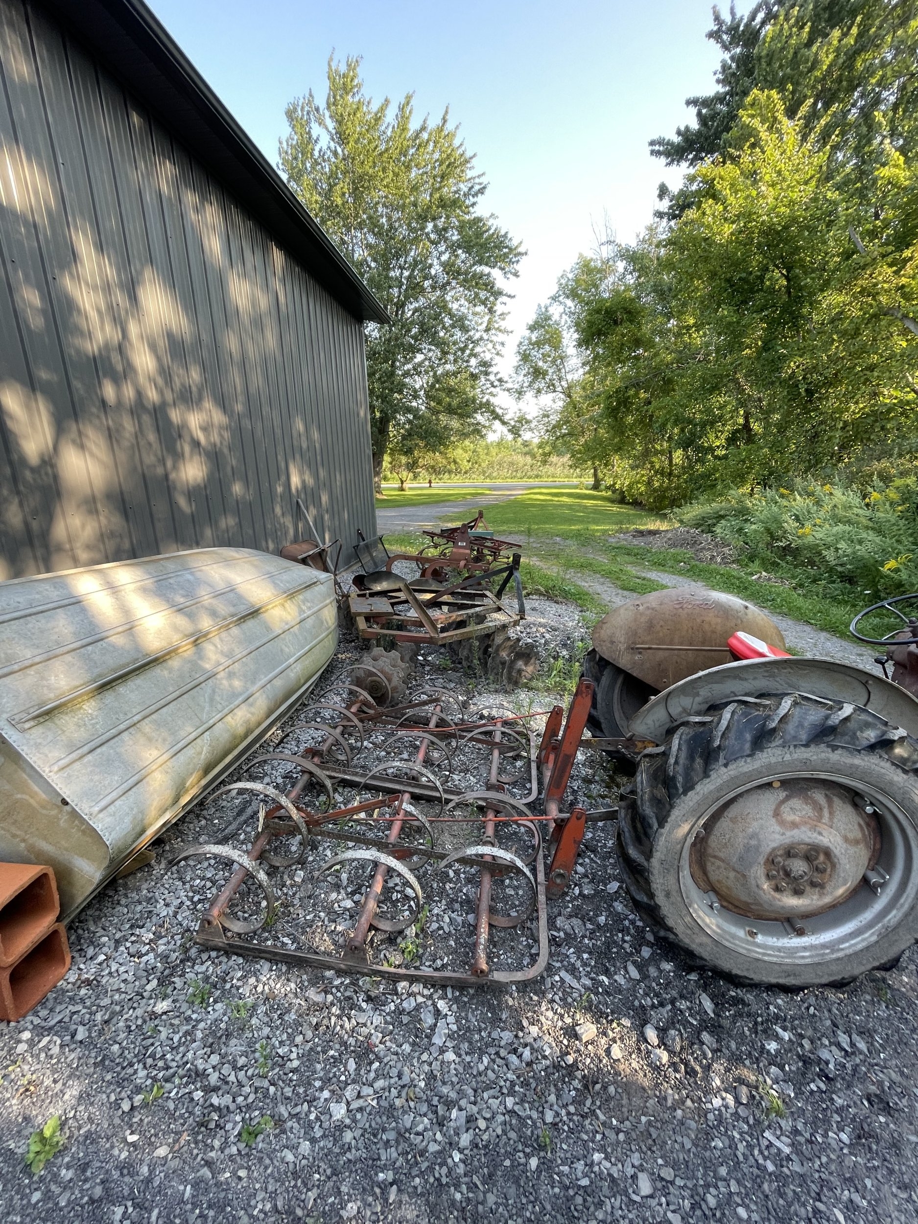

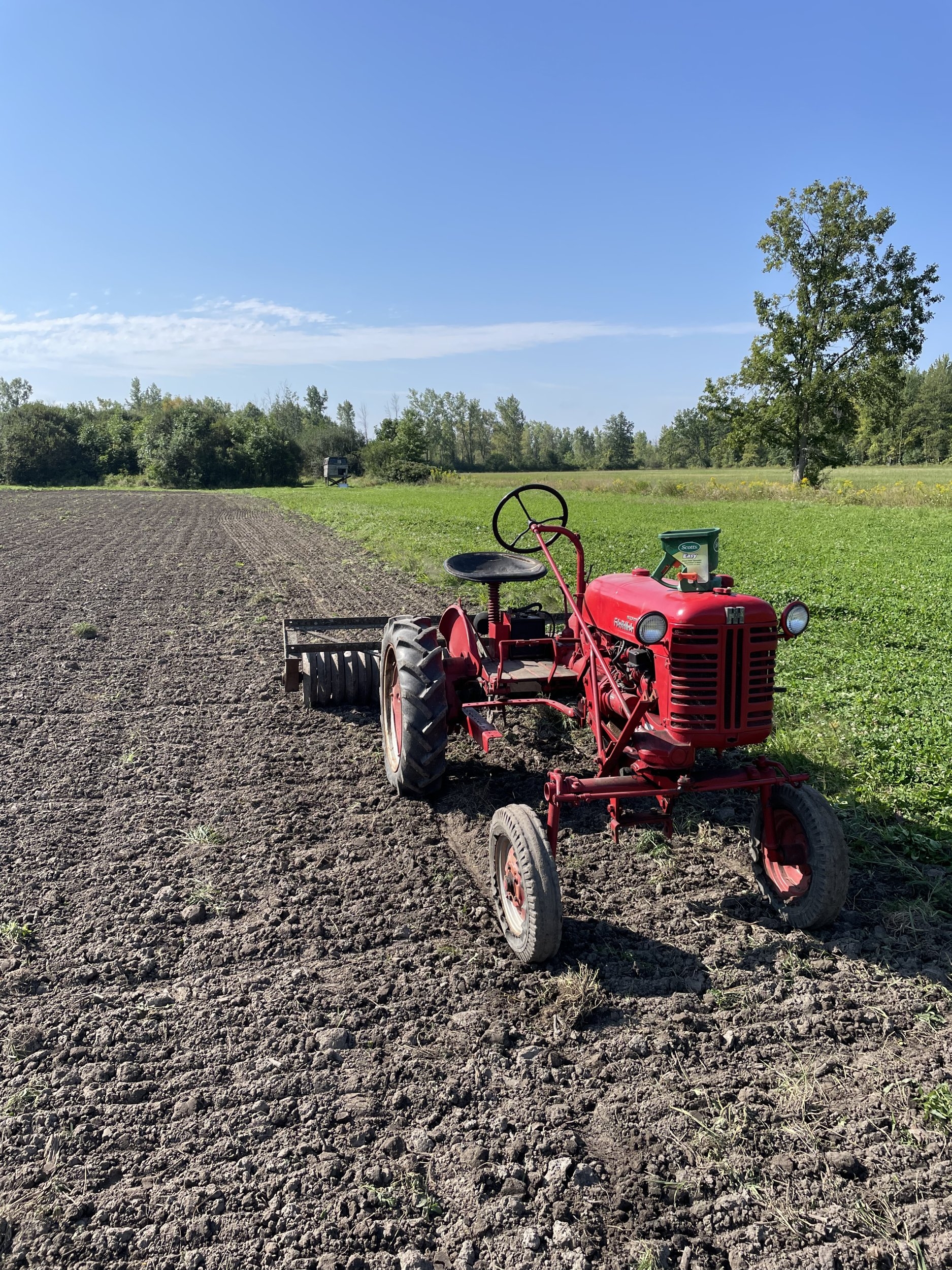

That’s why I recommended that half his budget go to the pole barn. Too many folks buy tractors, leave them outside, and hope for the best.
I have (2) tractors from the 1950’s that have always been stored indoors and both still have their original tires and are still in useable condition. Sunlight is very tough on rubber.
The fronts could stand replacement on the Cub. I had to replace that right side rear rim on the Ford 8n two years ago due to calcium caused rust rot of the original. Oddly enough, it plows better than ever, with just a loaded rim on the sod side, and the new unloaded one on the furrow side. The 1951 front tires are still very good on it too.
