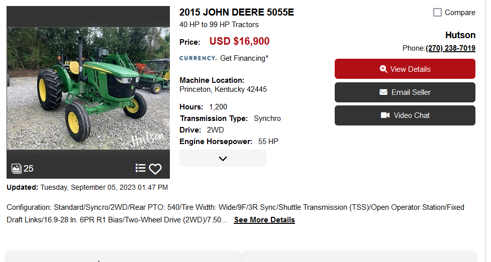

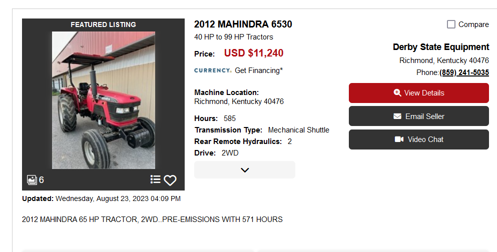

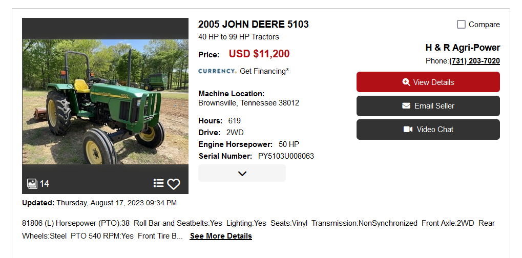

I’m loving tractordata.com helps a lot
Is there a certain amount of hours that would worry y’all? I see a lot with either inaccurate hours, 1000-2000, and some near 8k to 10k which worries me. The really high hour ones are the larger tractors 100hp. Some with rebuilds
