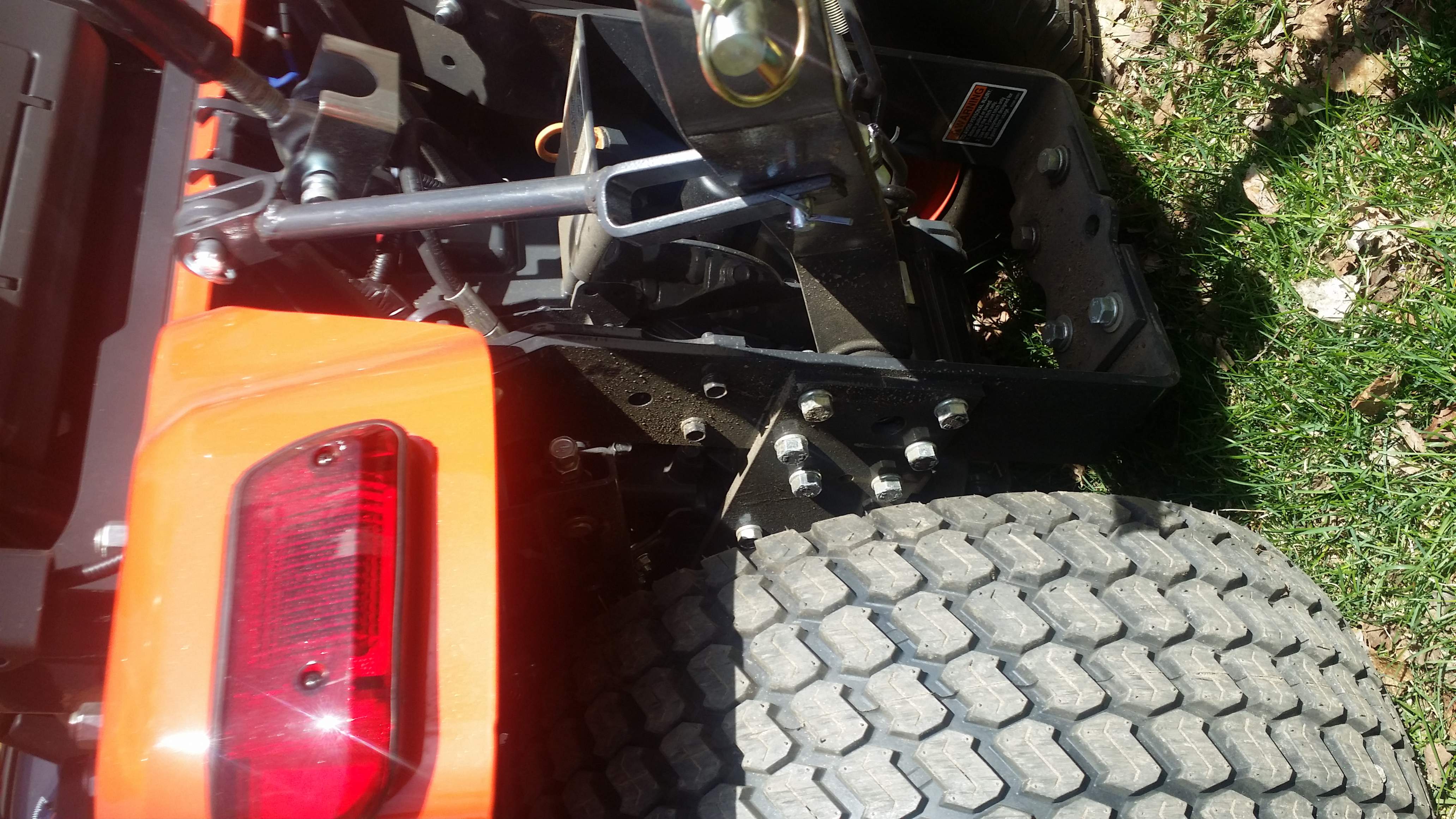

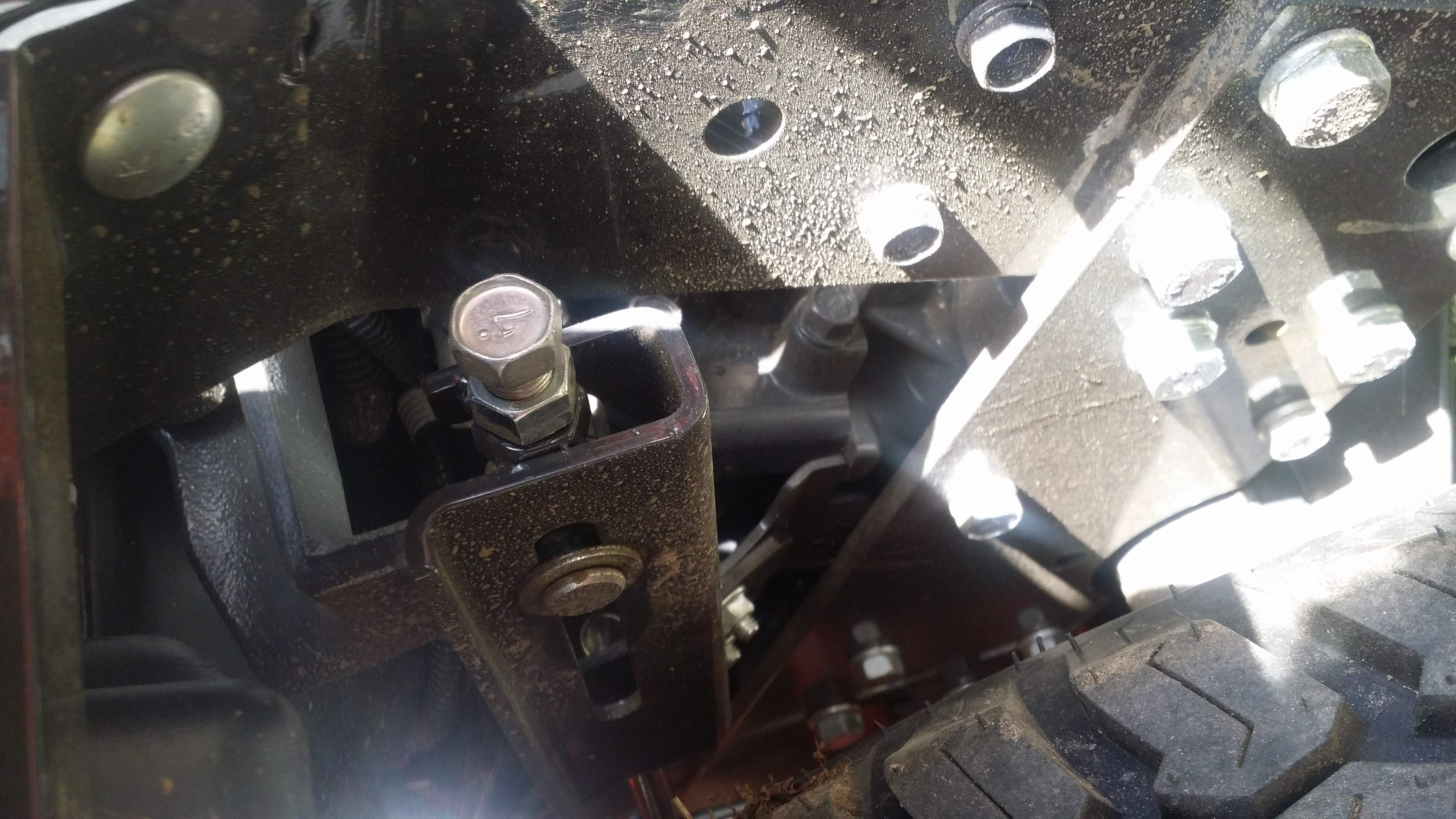

If you are lifting the 3pt all the way but the knob will not click into the Top position, it likely does need the small adjustment others have mentioned here. It is pretty common to need to make this adjustment. I've copied and pasted the best/simplest instruction for the adjustment that I've seen.
(Compliments to Harry at BXpanded.com)
I had this problem upon taking delivery of my new BX2370 yesterday. The salesman from the dealer couldn't get it to work right and was planning to dispatch a mechanic today. I am glad I saved them the trouble by finding the answer here. To help people who have this problem in the future, here is a picture of the location of the adjustment bolt, and a close up of the bolt itself.

   / New Member with BX2360 mower deck question #12
Appears that I am having a similar issue, I have adjusted this bolt/nut and have turned this in two full turned and this still fails to lock the deck in the raised position. So the procedure is: lower the 3 Point and MMD, adjust the adjustment bolt (so far in two full turns), raise the 3 Point and MMD and then turned the adjustment knob and attempt to turn to the TOP position, both clock wise and counter clock wise failed to click to the top position.......... Maybe its just a patter of me adjusting this bolt in more by turning it in?
Thanks in advance.
Dave

   / New Member with BX2360 mower deck question #16
I was able to correct this issue by adjusting the deck height bolts on the right and the left of the deck. Once I backed these off I was able to use the rear adjustment bolt and engage the the top position. Tightened all back up and was now properly adjusted.
