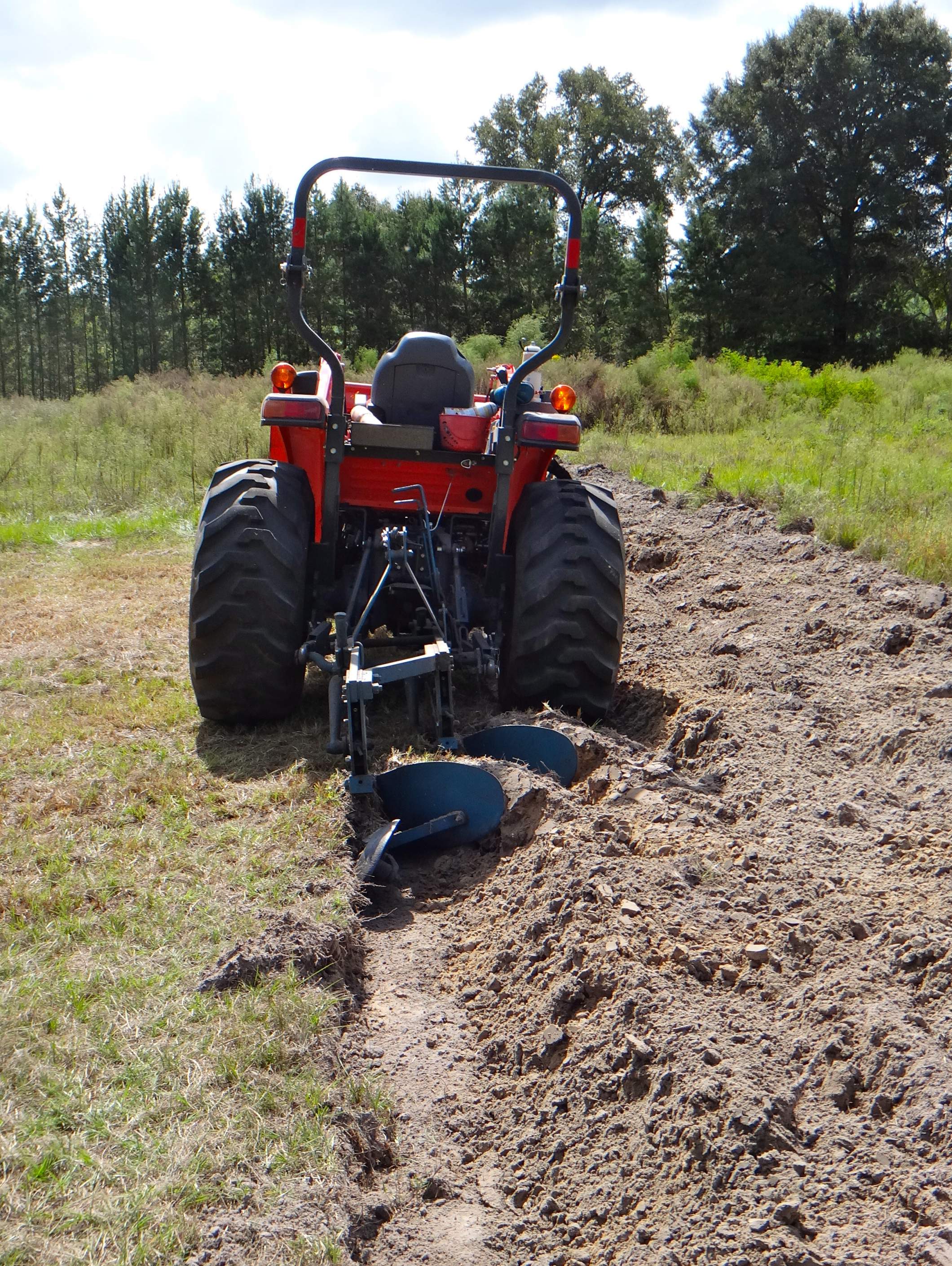

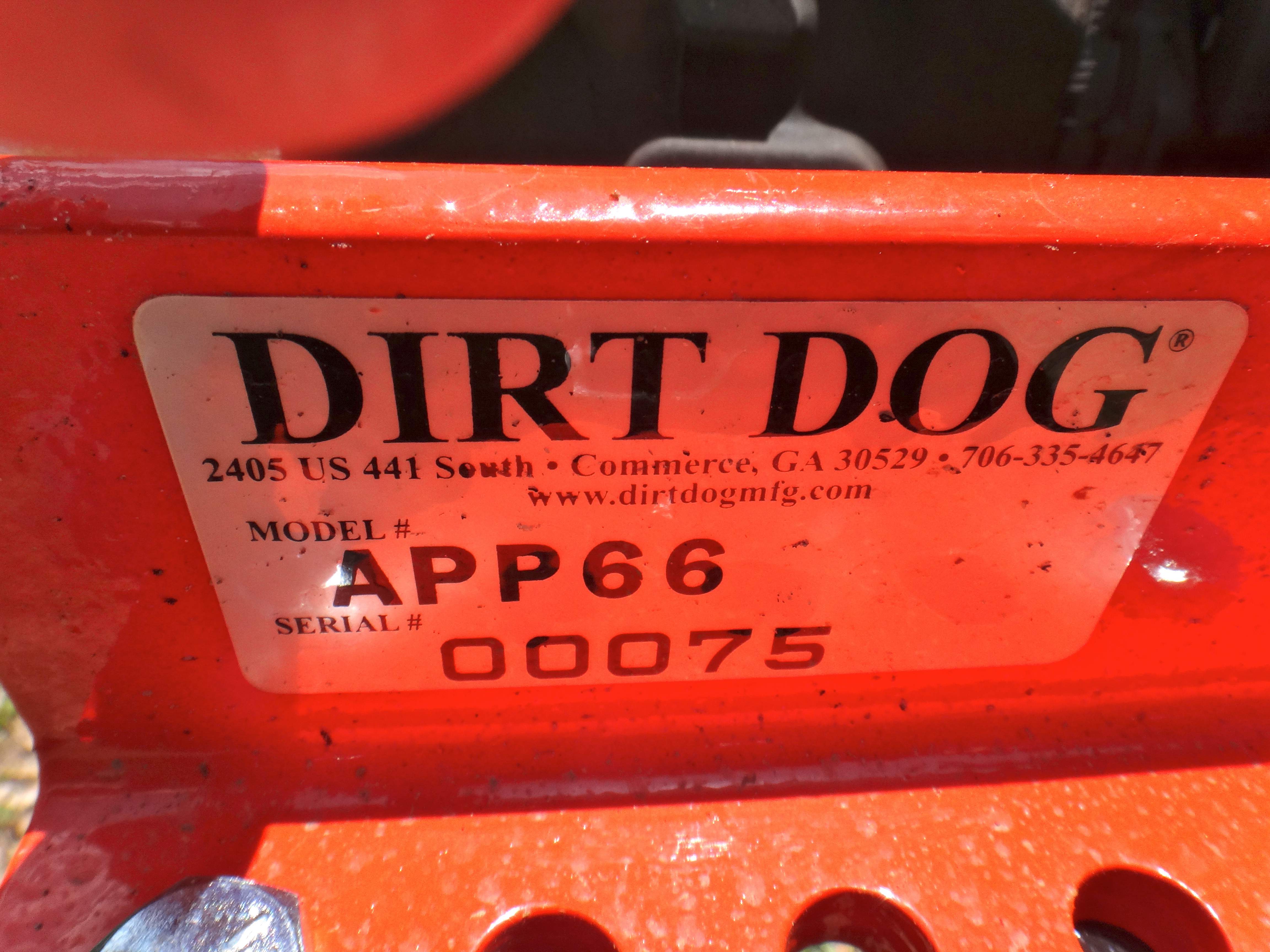

A moldboard plow, either a single 14" or a double 12" will turn up all roots. Another option would be a three tine or four tine Field Cultivator, which will comb out considerable trash. PHOTOS
MORE: https://www.tractorbynet.com/forums/attachments/339095-dirt-dog-all-purpose-plow.html?highlight=
You will probably need to use Southern Ag Herbicide's Crossbow, Rural King's Crossroad or Gordon's Brush Killer in a one gallon sprayer to kill regrowth after six months. These are combinations of 2,4-d and Triclopyr.
Then go over the plow rutted land with a PTO-powered Rototiller to smooth it in preparation for seeding. For the light tractors you are considering a Rototiller will be more effective than a Disc Harrow. A Rototiller is also heavy, compact Three Point Hitch counterbalance for heavy FEL lifts.

Moldboard Plow will INVERT the soil. Everything deep will be brought to the surface, with the deepest soil/roots on top. There the sun will dry out the roots, killing about everything. Almost nothing but trees have roots growing deeper than 6" to 8".
Downsides:
Land will be rough after plowing.
Dig a pilot hole to determine how deep your top soil is. You do not want to mix infertile subsoil into fertile top soil. Moldboard plows for compact tractors come in 12", 14" and 16" increments for this reason. 12" is the classic "sodbuster" plow. But if thin top soil is not an issue another 2" does not hurt.
It takes some experience to become a proficient plowman. Faster to learn a single-bottom plow than a two or three bottom plow.

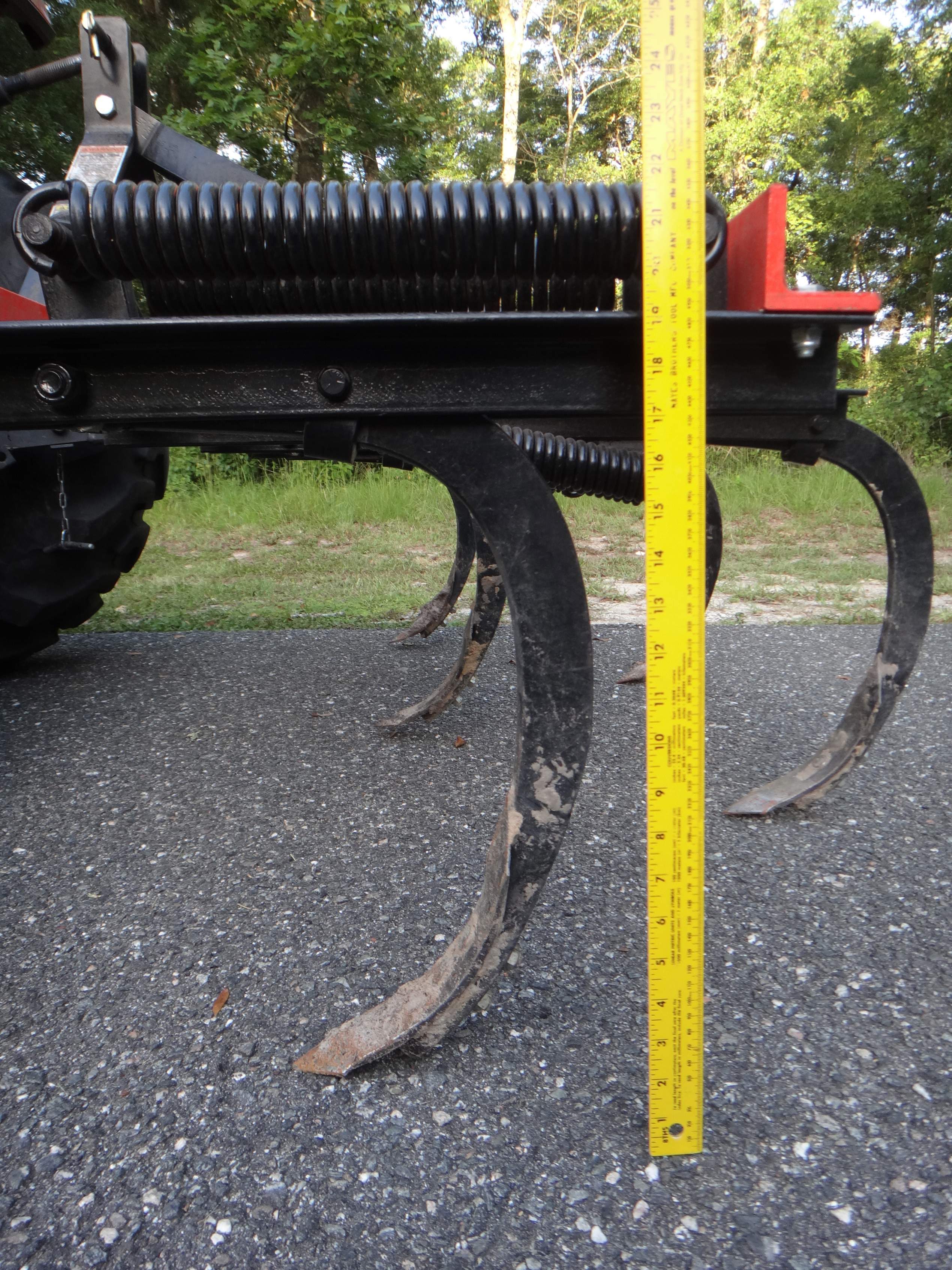

Ifh you get a box blade you can use it to rip out roots also by lowering the shanks and tilting forward ,not ideal but it will work and your only buying one implement.
/ New Member With Implement Questions #10
Ifh you get a box blade you can use it to rip out roots also by lowering the shanks and tilting forward ,not ideal but it will work and your only buying one implement. I would get clutches on tiller and brush hog much easier than shear pins. Older cultivaters around here are fairly cheap so that is an option.
/ New Member With Implement Questions #11
Exercise caution with box blade and down rippers to tear it roots. Bigger roots will tear up a light duty box blade. Something has to give... the root first... then the box blade
... then the tractor. (Ask me how I know)
/ New Member With Implement Questions #12

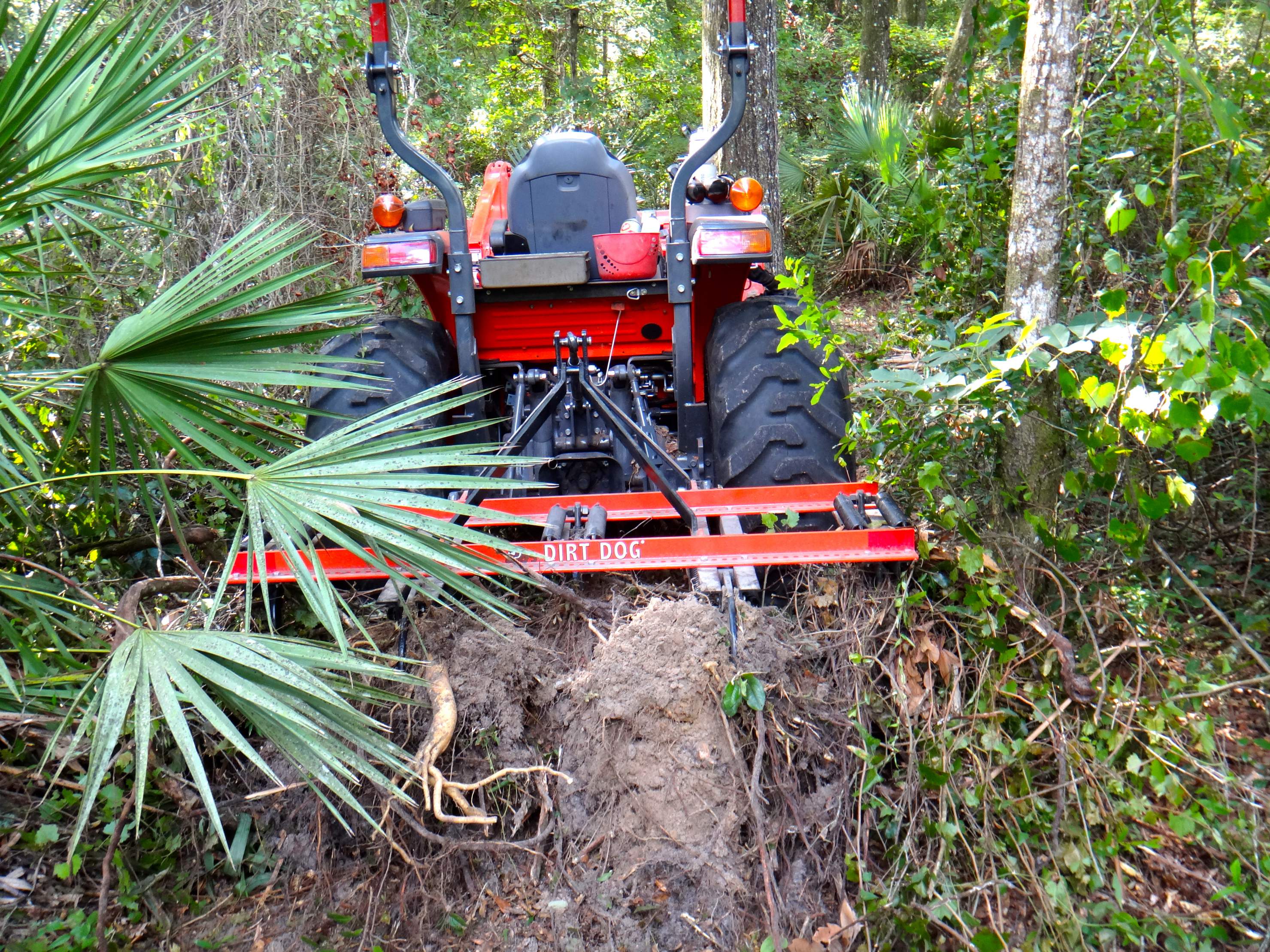

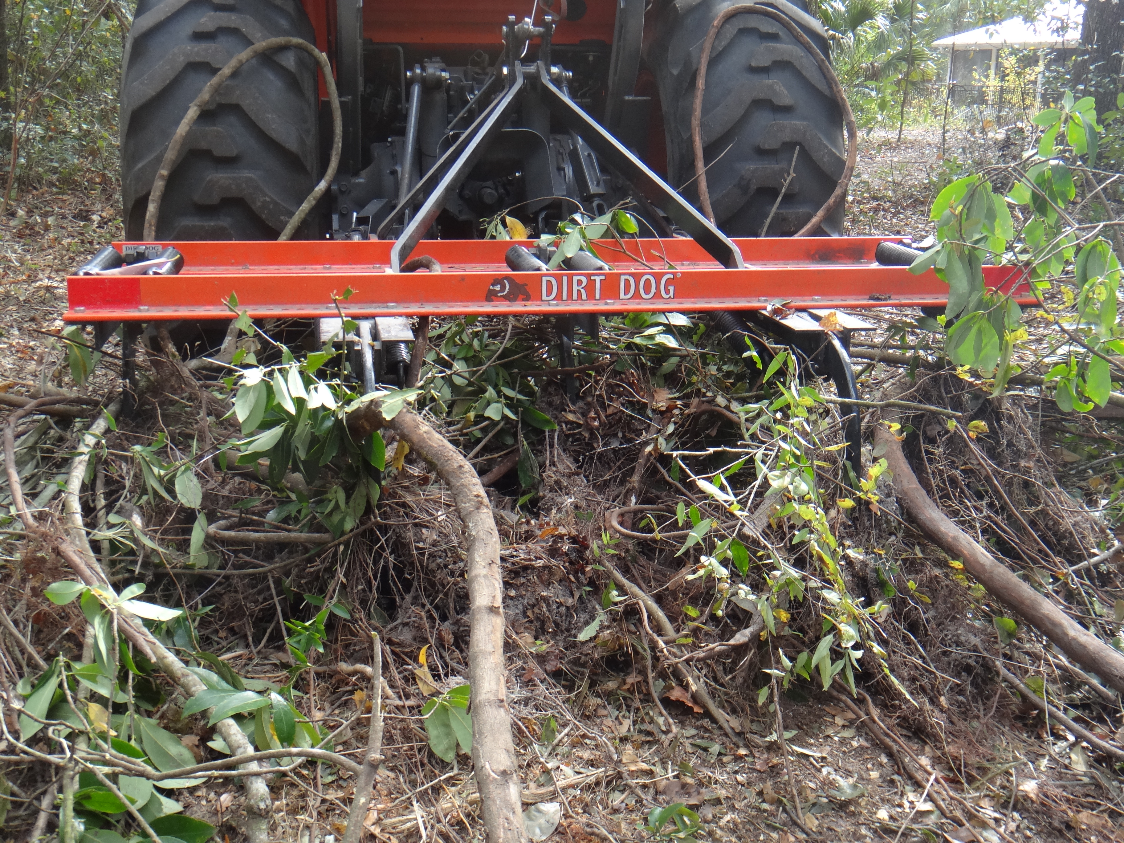

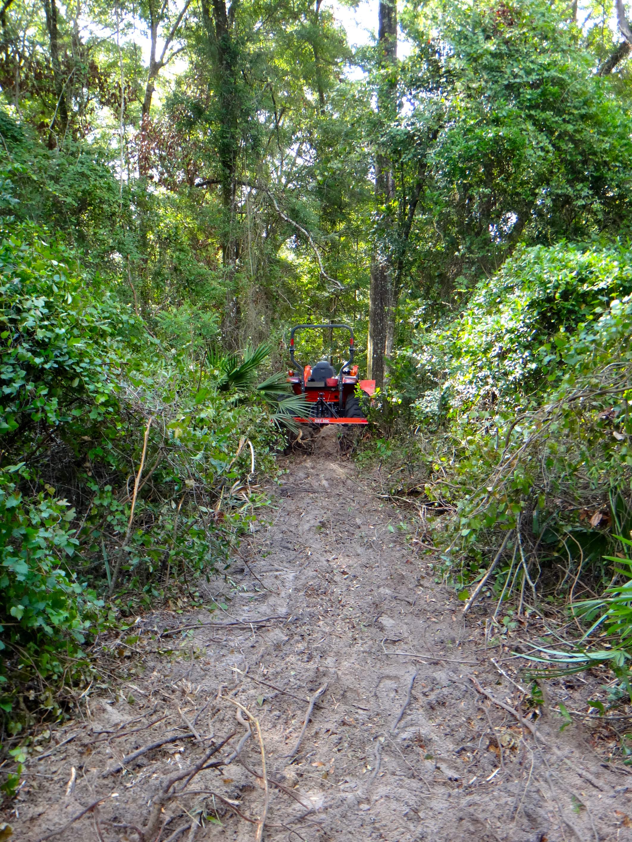

True & true.
However, Box Blade shanks behind a 2,700 pound tractor will penetrate only 4" to 5". Box Blade shanks "snap" many more roots than a Field Cultivator, which rakes more roots out. This is related to 45 degree angle and thickness of Box Blade shanks Vs. parabolic shape of Field Cultivator tines, which move through dirt in horizontal orientation.
RE: PHOTO #2; I broke off one Box Blade shank off doing this cleanup. You can observe the Box Blade dragged out a lot of roots but a spring-protected Field Cultivator removes more, partly because it penetrates twice as deep.
I have both implements and plenty of experience combating Yaupon.
