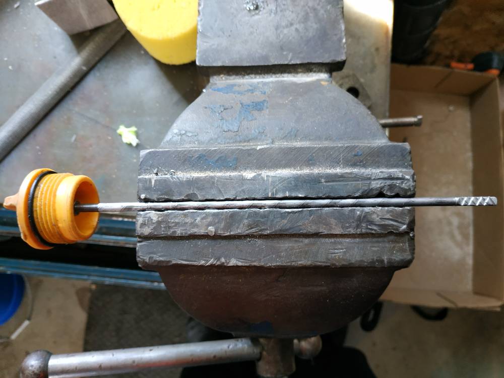

Maybe drill through, bulge the rod end, counterbore the 4mm drill hole from the top a quarter inch or so wide & deep, insert rod. backfill with silicon sealer?
Or easier yet, just put the rod in the Yanmar tool kit and take it out once a year to measure oil depth.
Thanks to careyo63 we have a good photo. That's simple. I've seen that too. Lots of old motorcycle tool kits had a calibrated rod right there in the tool roll.

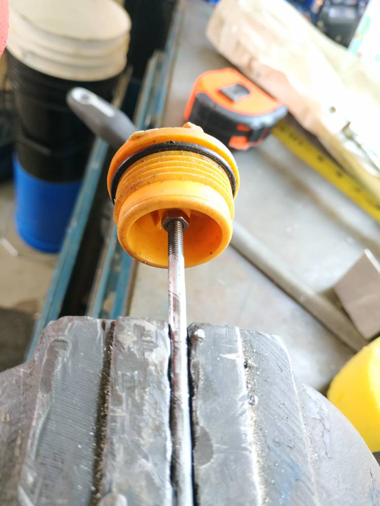

I wonder where the old rod is? Any chance it is lying down there there in the transmission sump? If so, you might get lucky and find it next time you service the cleanable sump filter. BTW, that cleanable filter is something that we should all take out and clean every decade or so...but few of us do.
The measurement of 0.156" is awfully close to being 4mm, so that's probably correct. I'd sure think about how to best affix the rod to the cap. Obviously knurling didn't work for the previous one. I like things easy and permanent, so if I was feeling lazy I'd probably drill right through the cap and take the rod all the way through & put a bulge on the end to hold it.

Ok, so I was wrong again. The DS in front axle is knurled and pressed in the yellow cap.
Tranny DS is threaded. 4mm x .07 if anybody wants to know. So I made my own. Super easy out of a welding electrode. Took the coating of course off, polished it and made threds. Filed flat end and crossed hatched some grooves. Works like slick.
