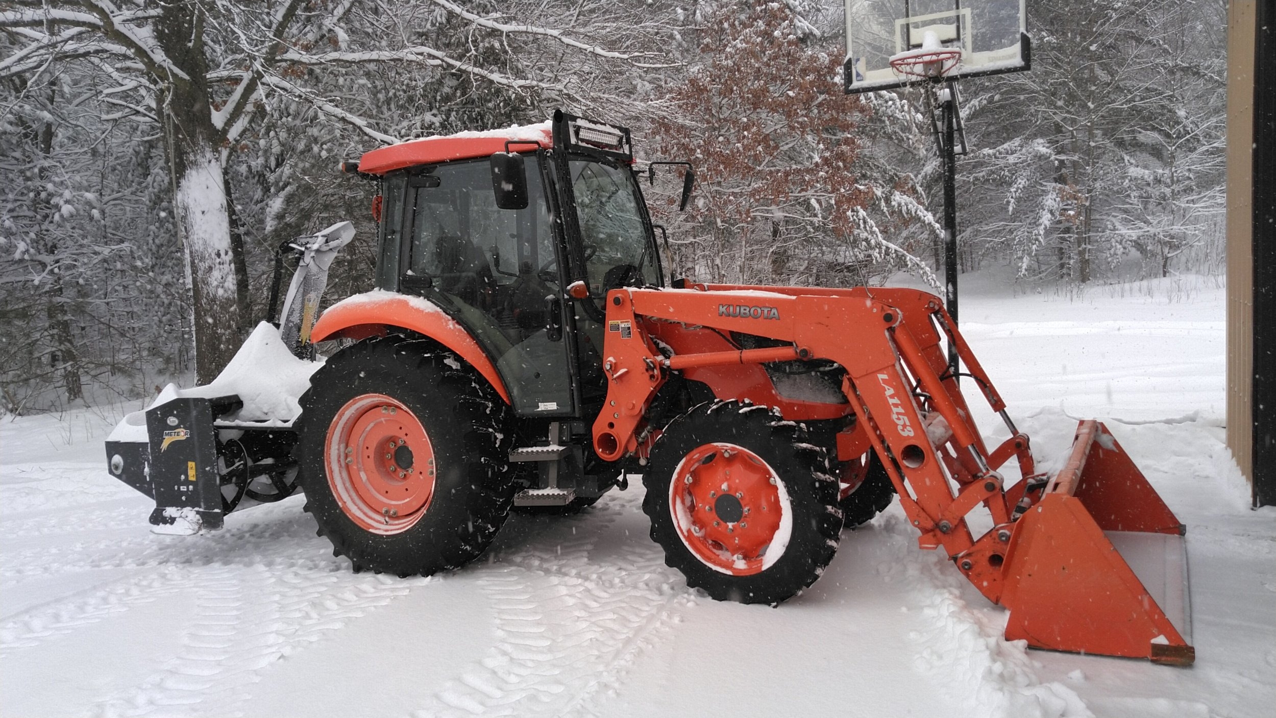

When buying a shear pin make sure not to get a harden bolt and make sure you know what’s under the snow when and where you are blowing things can go bad in a hurry. If you plug the chute make sure pto is off and have a cut off shovel handle handy. Good luck have fun
