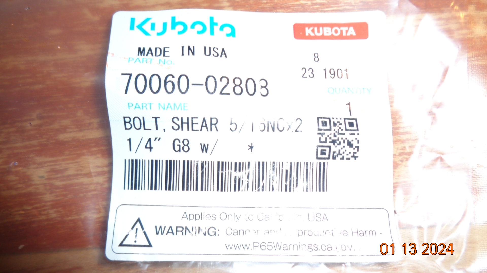

...And OOPS!
Blew the fan shear bolt today... didn't see that 1" diameter piece of branch that blew down today. A 12" long piece, it was buried in the 3" of wet snow we got.
Realized I was wrong above -- they take a 1/2" wrench & socket, not 7/16".
For those who may be interested, here's the Kubota part number for the impeller shear bolt -- a fair bit less expensive than the M-F part, but identical.
Interesting that the Kubota part says MADE IN USA, but the M-F/AGCO part says MADE IN CANADA.

Yes that's the same as my MF snowblower shear bolts:
Grade 8 shear bolt (gold) 5/16" x 2.25" long
Grade 5 shear bolt (silver) 5/16" x 2.25" long
