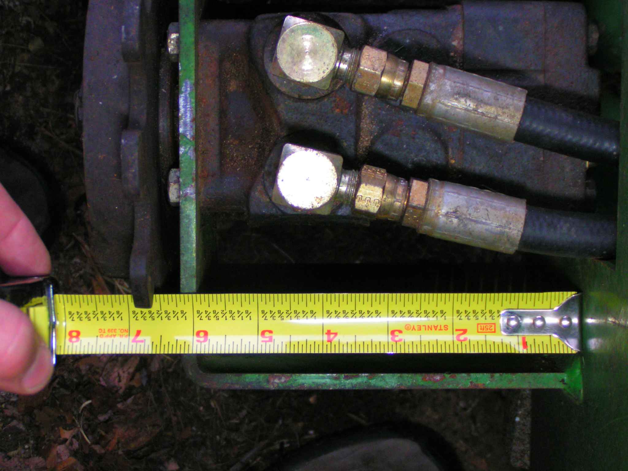

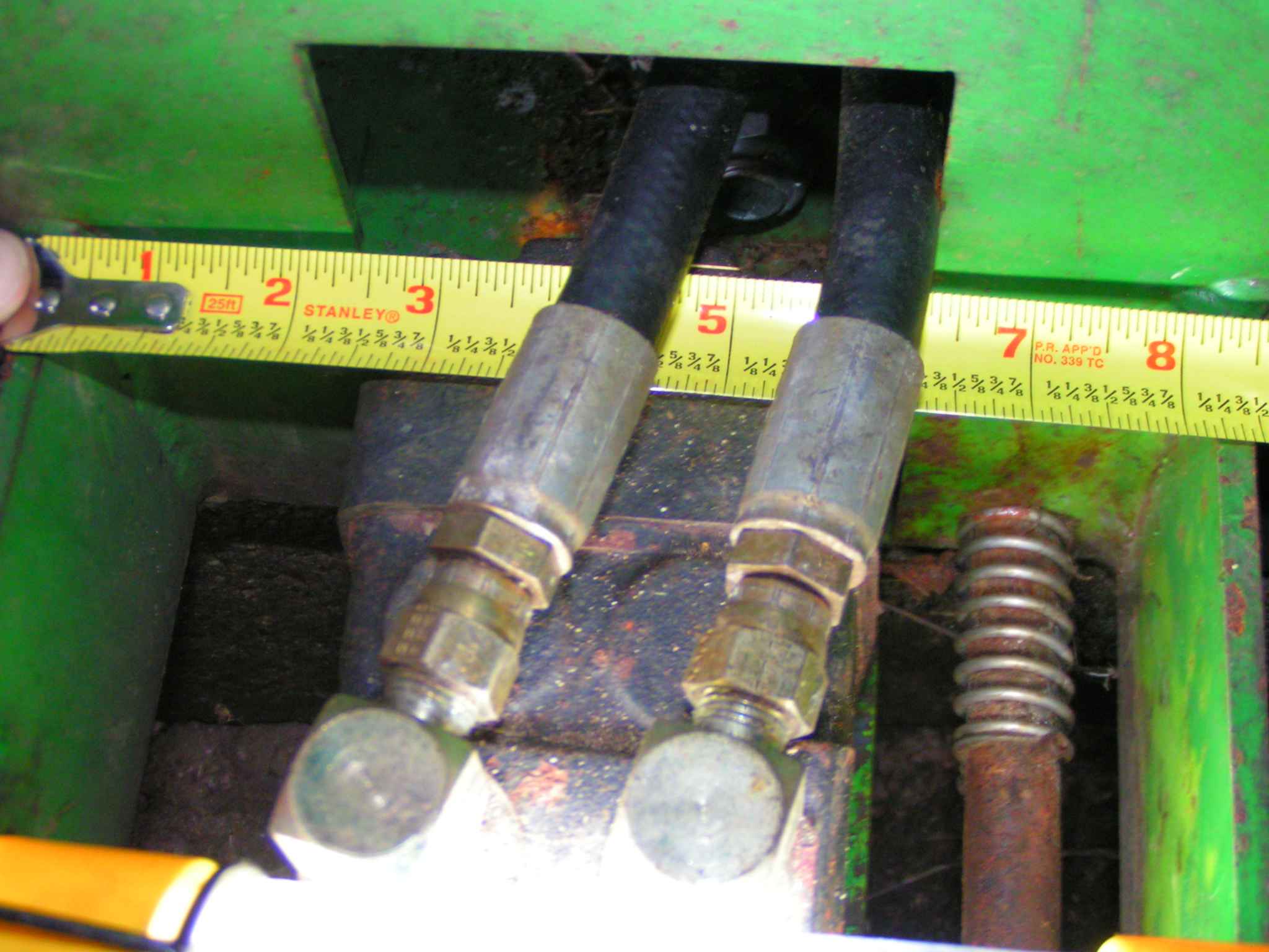

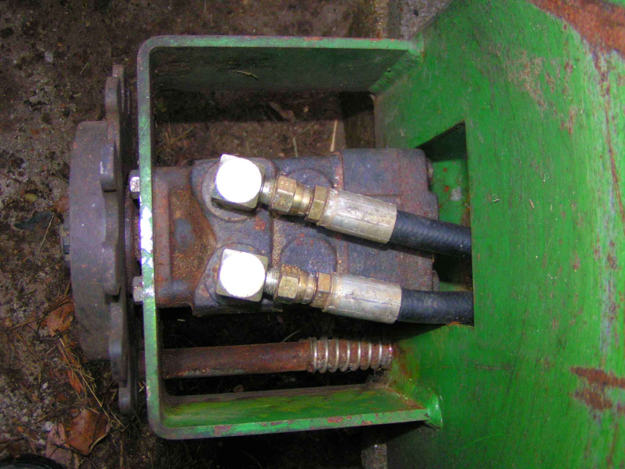

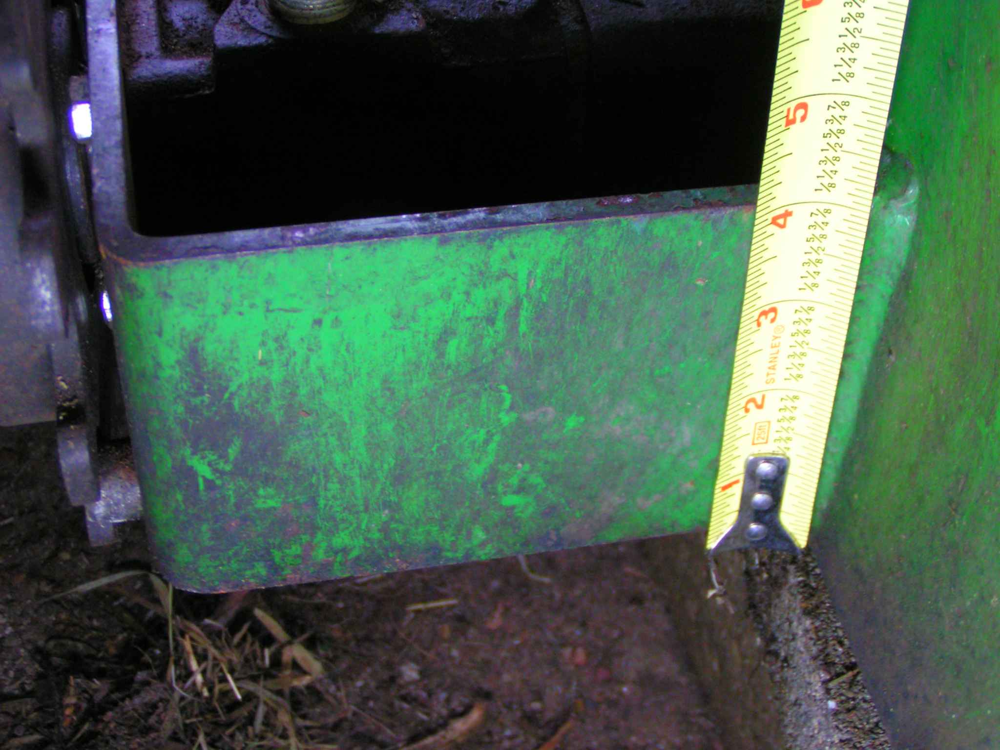

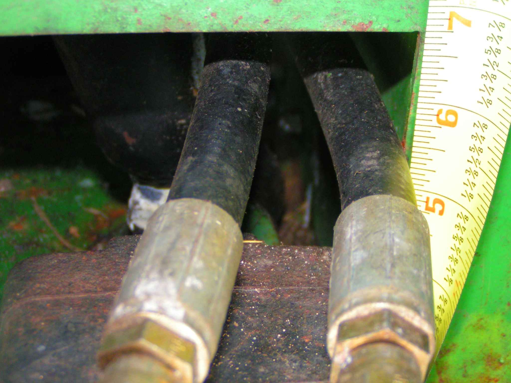

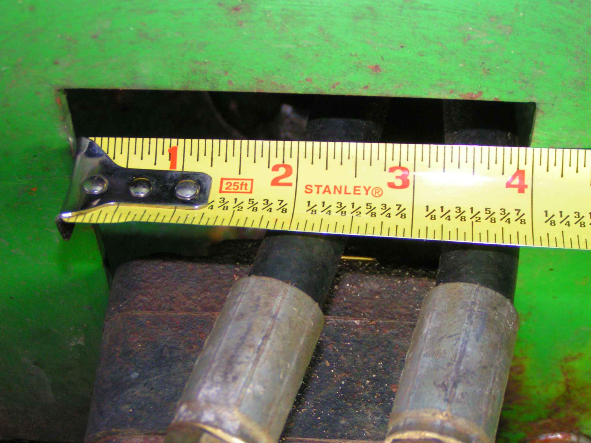

As requested, here are some pictures of my left, front wheel motor mount area on our 2001 model year PT425 with the old style wheel motors...
All of the steel for the motor mount appears to be 1/4" thick.
1. Depth of motor mount box is 6.25".
2. Width of motor mount box is 8.5".
3. Height of motor mount box is 4" and is flush with bottom of skid plate.
4. Shows the hole for the rear of the wheel motor and the hoses. The wheel motor box appears to be centered on the hole, 2.25" from either side.
5. That makes it 4" wide.
6. And 6.75" high.
7. Looking down, shows wheel motor, parking brake pin with locking spring at the bottom, and wheel hub with notches for parking brake pin.
8. Side view of wheel hub. Note parking brake pin at bottom right, engaged.
9. Closeup of engaged parking brake pin.
That's it. Hope it helps.;)

Thanks a ton, MR!:D That was very, very helpful. It confirmed what I was thinking/remembered. My PT was delivered new in December 2000, so I think it is the same spec as your 2001 model.
I couldn't remember how tall those boxes were, but I'd guessed them to be about 6" deep and pretty wide. If they were about 2" taller, say 6" or so, then both the White CE series and the Char-Lynn W series would fit. Note that both of these wheel motors are heavier duty than the original ones, with 1.25" tapered shafts. They are "fat, stubby" wheel motors that have a tapered thrust bearing in front, in a nose/extension around the shaft that's 3" in diameter, for handling much higher bearing sideloads. But, their 4-bolt mounting pattern is 5.25" on center -- too large for the 4" high boxes, especially since you'd have to enlarge the hole that shaft goes througn to handle that 3" nose. That's too bad since I got a $277 price quote for the 18.5ci Char-Lynn model W motors. I think the new PT-425s use one of these two motors (likely the 15 ci versions), since they are definitely "fat and stubby" ... That much I remember from my Tazewell trip, checking them out...
Your measurements also confirm johari's comment about how much the hole in the body needs to be cut/ground out, if I buy Char-Lynn Model S wheel motors. Since he had Danfoss wheel motors, I didn't "trust" Tazewell to make the same size square holes. But, it looks like they did...
It looks like Char-Lynn Model S motor is 4.25" in diameter. The 18ci version is 6.66" long, so about 2/3 of an inch will need to stick back in that hole in the frame.
