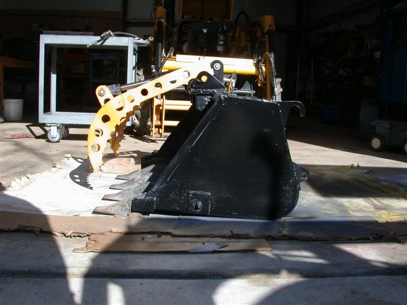

Now that the filter minder installation is done, I started working on the grapple relocation.
The problem was the OEM bucket bowed and tore at the top corners. The grapple tips ended up too far away from the bucket bottom of the bucket. The other thing was when we made the grapple, it was designed for a bucket without a tooth bar. So the grapple jaws are a little short to reach out to the tips of the toothbar. Loretta does not move much dirt with her tractor but it's used more for brush and log moving and maybe some compost. Her key is to be able to pick up stuff clam shell style or driving into a pile/log/rock and grasping it.
I moved the grapple base about 4 or 5 inches forward.
Instead of just cutting the jaws and adding a section to them, I needed to beef up the bucket anyway so this is what I came up with. I also spent a couple hours re welding the entire bucket top lip inside and out and all the corners. But you can see what I want to do and the problem I will have since it is now cantilevered out over the top bucket lip. There are comparison photos of it's original location showing it sitting back farther and also of the teeth up from the bucket lip.

You can see the problem with moving the grapple forward is that now there will be even more pressure trying to pry the bucket open. I'm going to try gusseting the inside of the bucket. Along the back side of the bucket, where the top QA hooks are, there is a 1/4" thick plate about 6" wide that runs across the entire back. I figure if I make the inner gussets heavy duty enough, and if I can attach them to that back plate, then the entire top lip would be tied into the back of the bucket.
So here's my plan.
I got some old busted up scarifier shanks that are 3/4" thick x 2-1/2" wide. (I never threw them away) Then I sawed them into a shape to fit the inside of the bucket. I had to weld some pieces together to get the shape I wanted. What they do is attach to the underside of the grapple mounting plate, to the inside of the bucket top and also to the inside of the bucket back.
Burning the weld through to the back plate took a little more heat than I thought.
When I tried to pry the grapples backward, they were pretty stiff. Before when I did they I could feel the bucket flex. Now it's better. I think it should hold the back and top together now, but of course I will test it out first.
Rob-

OK, now you can see the grapple jaw tips are closer to the toothbar tips when open.
When closed they actually "interlock" with the toothbar. I believe this position will make it easier for Loretta not only to clam shell pick stuff up, but also drive into logs or rocks and the grapple jaws should snag the object. BTW, if the bucket still flexes, I will add a tube all the way across the top lip and and use angle iron at the ends to weld it to the bucket sides. I'll try this way first.
