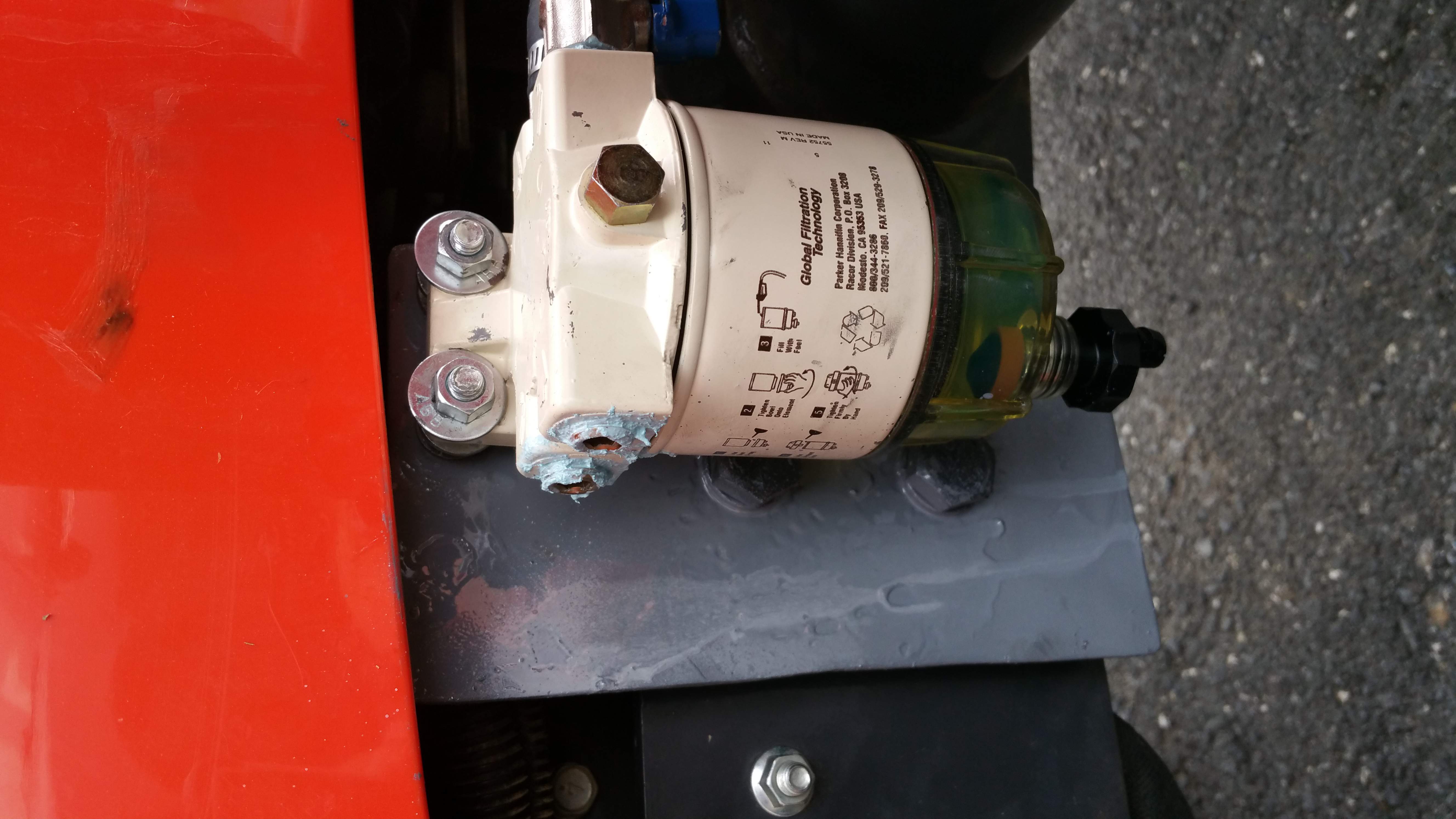

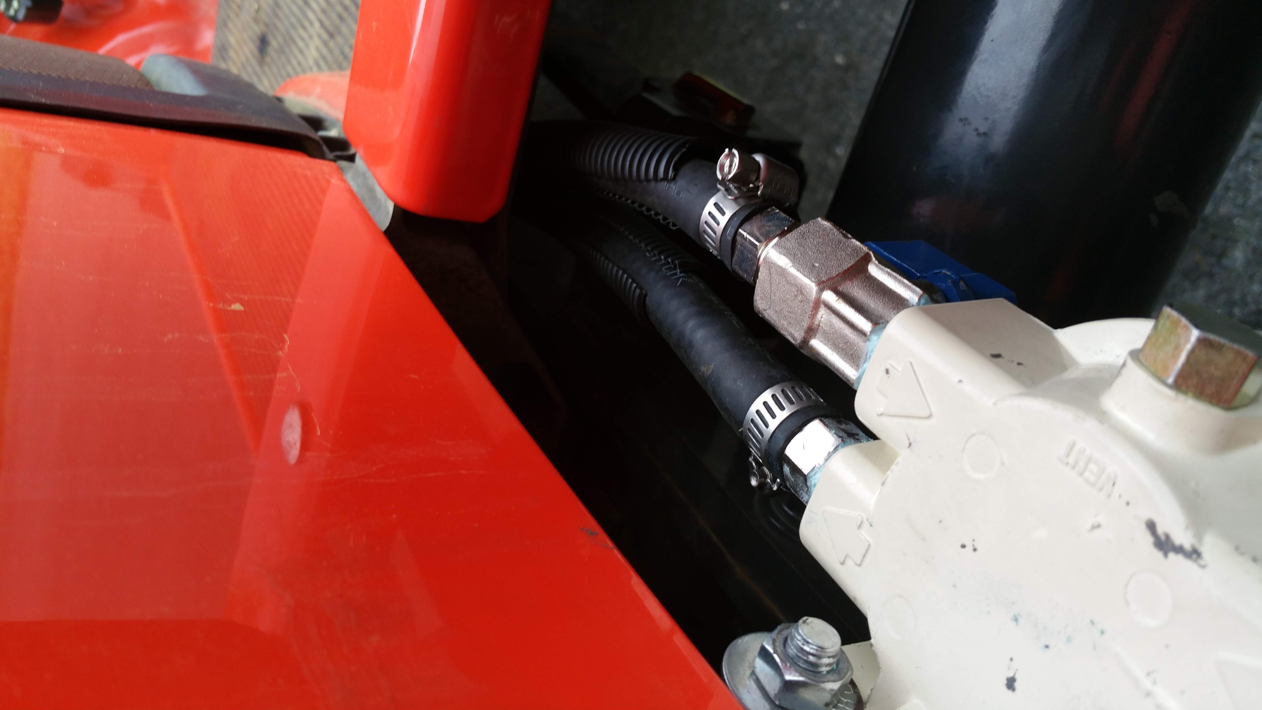

Biggest advice I can give is to make sure you mount it back far enough that it will not interfere with your front tire went turning sharp AND when on a slope causing the front tire to swivel up. Had to move mine back to clear the front tire. I checked for the turning angle on level ground, but didn't think about when the whole front axle moves vertically. Also, I think one of my pic's shows a fuel shut off valve. No issues with mine, and NO fuel clogging issues either so far. On the whole, a great upgrade from OEM.
I did the same thing when I mounted mine.

The location and part of the plumbing of mine. No interference issues..., yet!

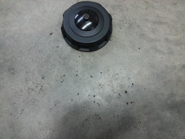

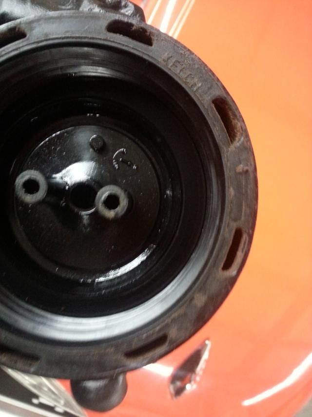

I have been thinking about the factory filter setup on the BX. I think it is mounted in a poor location. It is right in front of the hydro fan so there is some air running across it. That is not a good thing in freezing temps if there is water in the filter especially since the factory filter is so small. According to Napa the Wix replacement for the factory filter is rated 50 micron.
I had the filter off the BX today and someone mentioned putting a plastic bag on the fuel filler then put the cap on to keep fuel from leaking. I tried that and it still lets fuel out, so you will need a pinch off tool. I know Jason has said the fuel cap may let dirt in the tank. When I took the plastic bag off this is what I found.
What happened was there was dirt in the vent portion of the cap and the bag rubbed the dirt off. I bet when the cap is taken of the BX a small amount of dirt falls out of the fuel cap every time.
Here is what the cap looked like.
After some tapping and picking dirt out with a screwdriver.
So you guys may want to check and clean your fuel caps periodically.

Thanks for the compliments and good observation Roger. Personally I believe that the cap is the cause of many of the BX fuel issues.

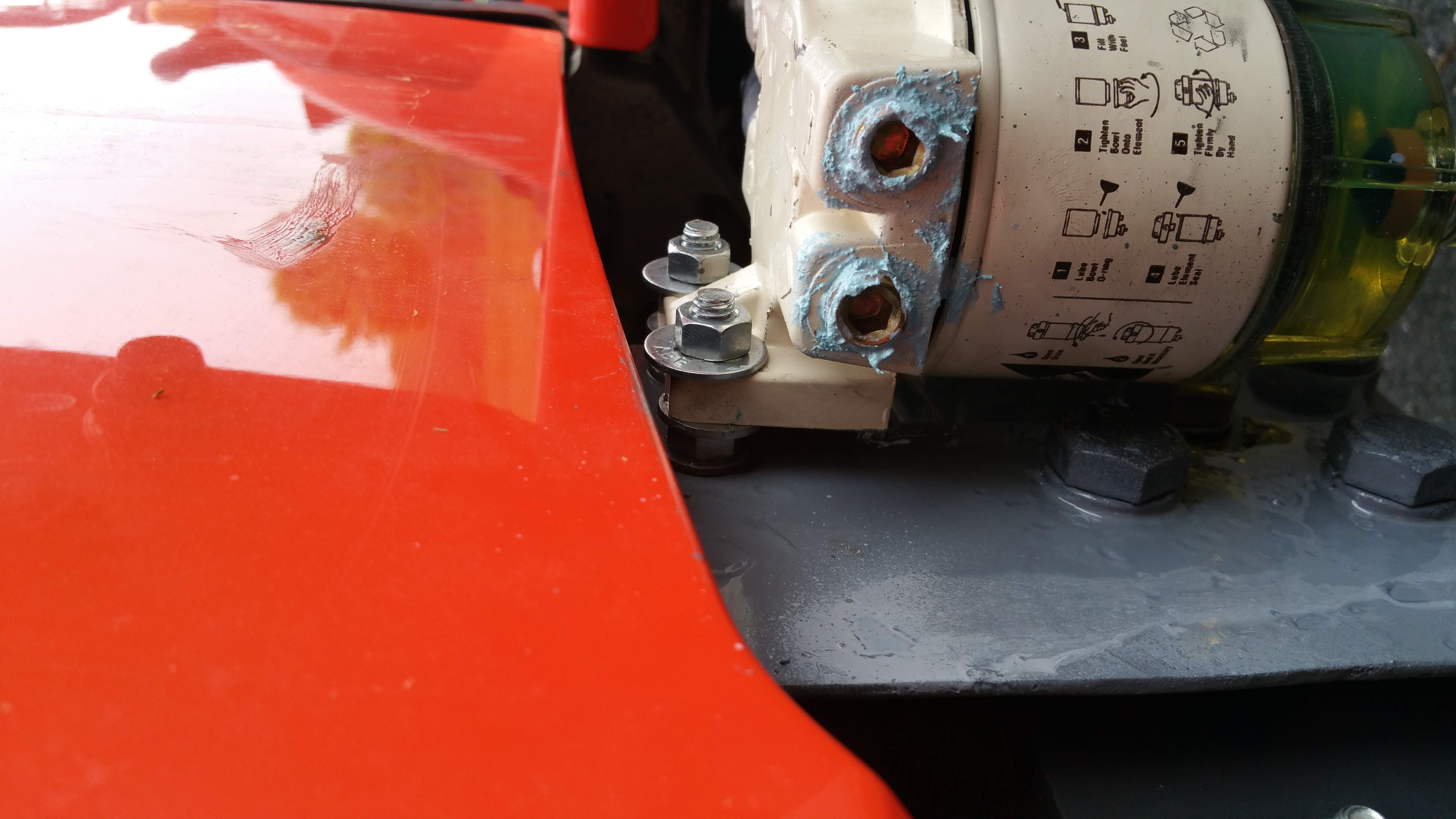

I finally decided when enough was enough and added my filter. After a second clogged factory filter, it was time. The only issue I ran into was the filter being too close to the tire when turning all the way to the left on hill. 20150508_232753.jpg20150509_073109.jpg20150509_073116.jpg20150509_073122.jpg

Good install.. You'll be happy you did it. You really got to try to get the filter as close as possible to the loader support tube to clear the tire, thats really the only thing to watch out for.
