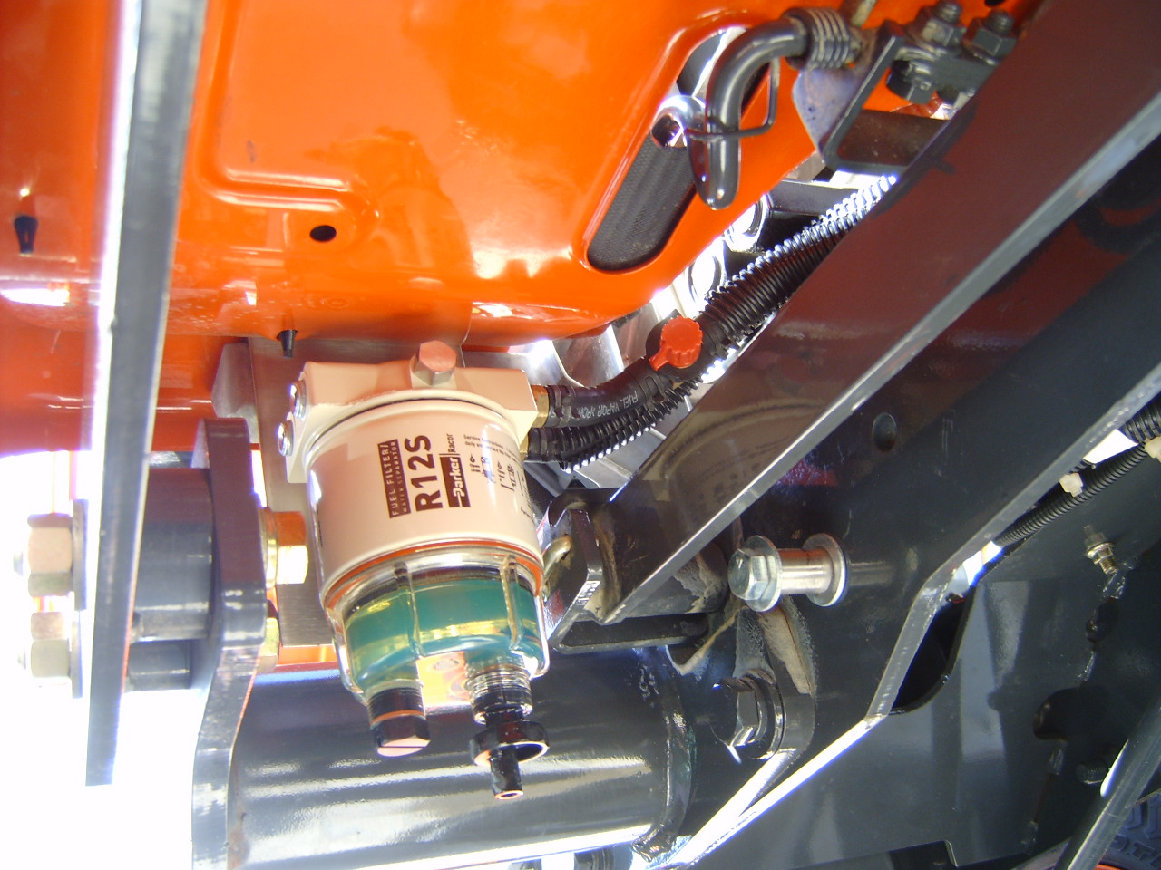

Here is my Racor. I made a stainless steel bracket that slides in between the front left floorboard mounting area. Just take out the one carriage bolt holding the floorboard, slide in the bracket, and but the bolt back through and tighten it.
nice! been wanting to add one of these for a while - this looks like a good protected location. tough to find free space on those little machines.
Not sure if that would work for the newer 70 series as they have the brake on the left. But it works like a charm for my 60 series BX25. Tucks in high and tight BEHIND the loader arm. No tire interference issues at all.
