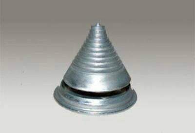

I use an inexpensive balancer like this.
The grinder takes off very little material so it can be sharpened a lot.
