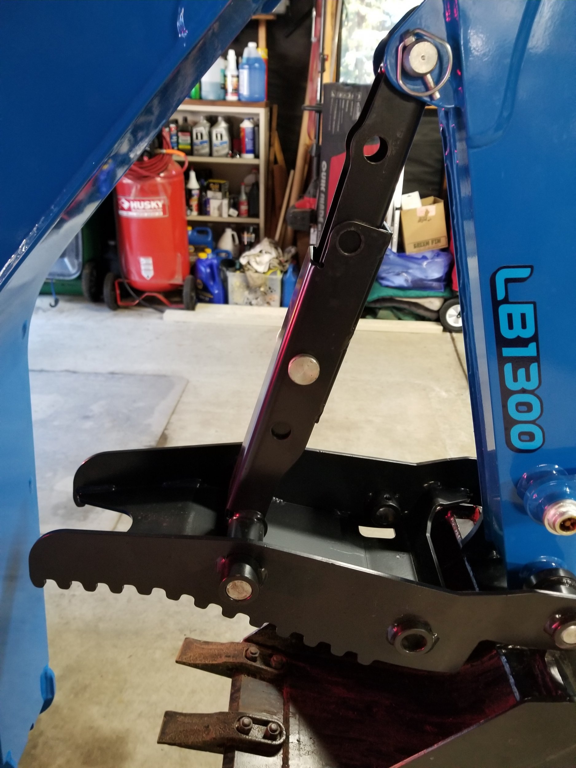

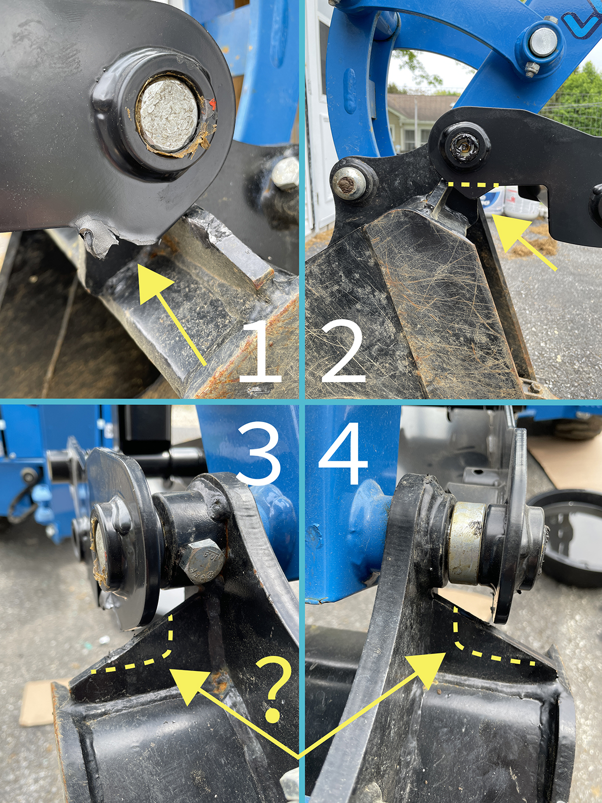

OK... Went easy until I curled the bucket to align for the pin. I started hitting the thumb with the bucket gusset and when I went to back off I moved the control the wrong way and started shearing the bottom of the thumb (See #1).
Please take a look at this composite image. Is your thumb and bucket fabricated the same as mine? I am trying to decide if I want to modify the the thumb or the bucket. I don't think either will affect the strength but what do I know. Opinions?
I am leaning toward grinding on the thumb. (the Left side is almost done already anyway).

I would grind the thumb... lots more pressure / stress on the bucket. My neighbor has the 225-S, the dealer ground the thumb when they ran into the same issue.
It was one of the first thumbs that came from LS, I believe they changed the manufacture of newer thumbs due to the same issue...

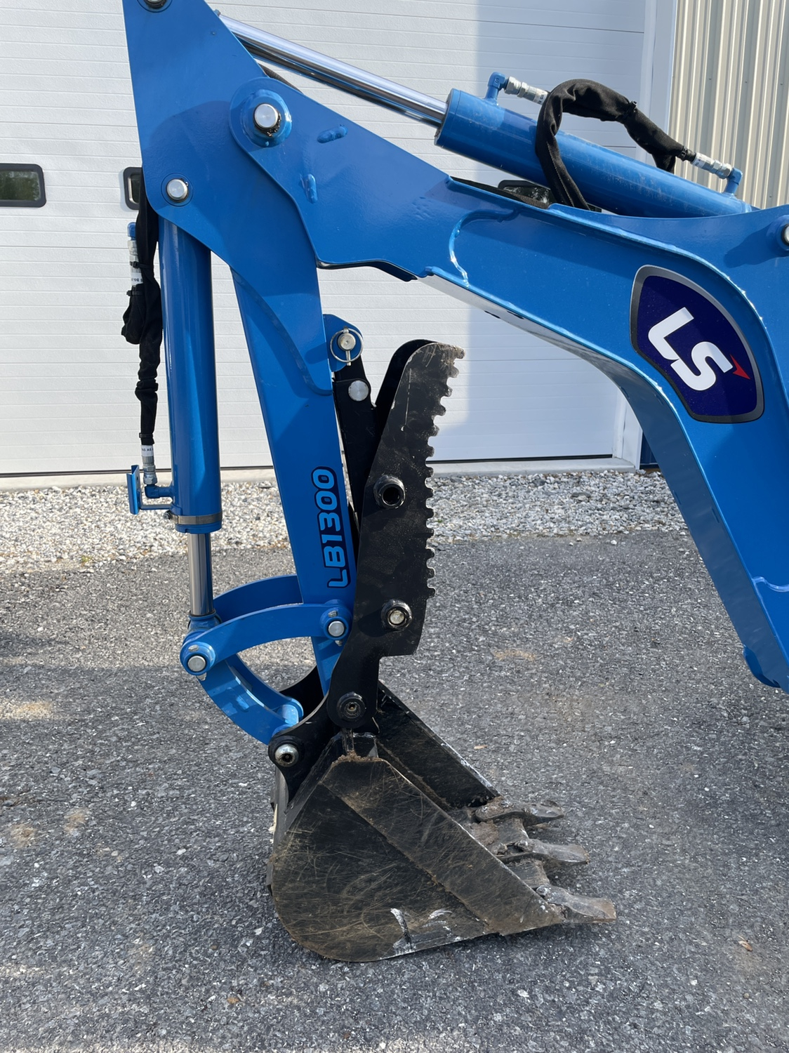

I wound up grinding on the thumb and a little bit off the bucket gusset. I can always weld something back in if the bucket appears to weaken. I also ground off the tabs on the adjustable brace so I can use the close pivot and store the thumb up against the dipper when it’s not in use.

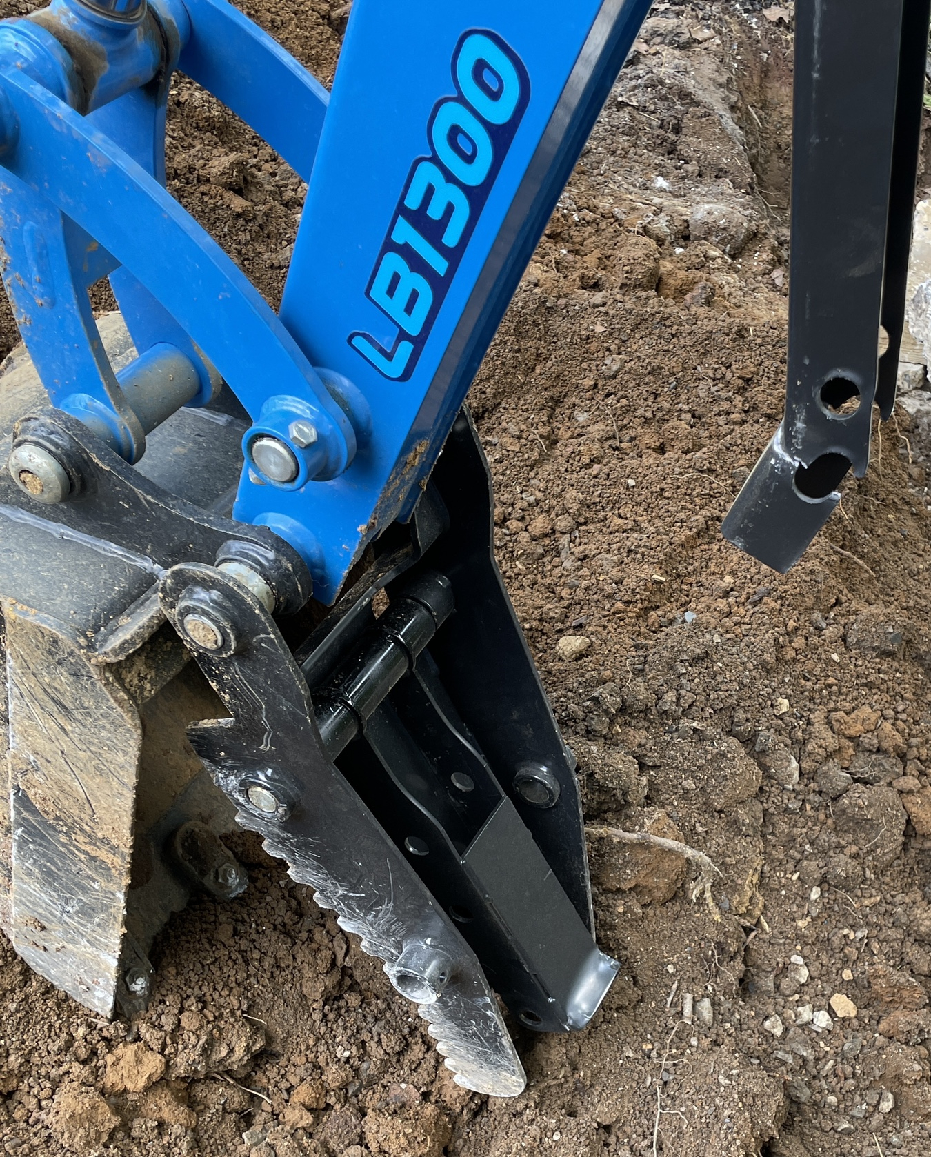

Holy crap. I move the main pin to the center of the thumb to get that triangle config for strength....seems to work.
