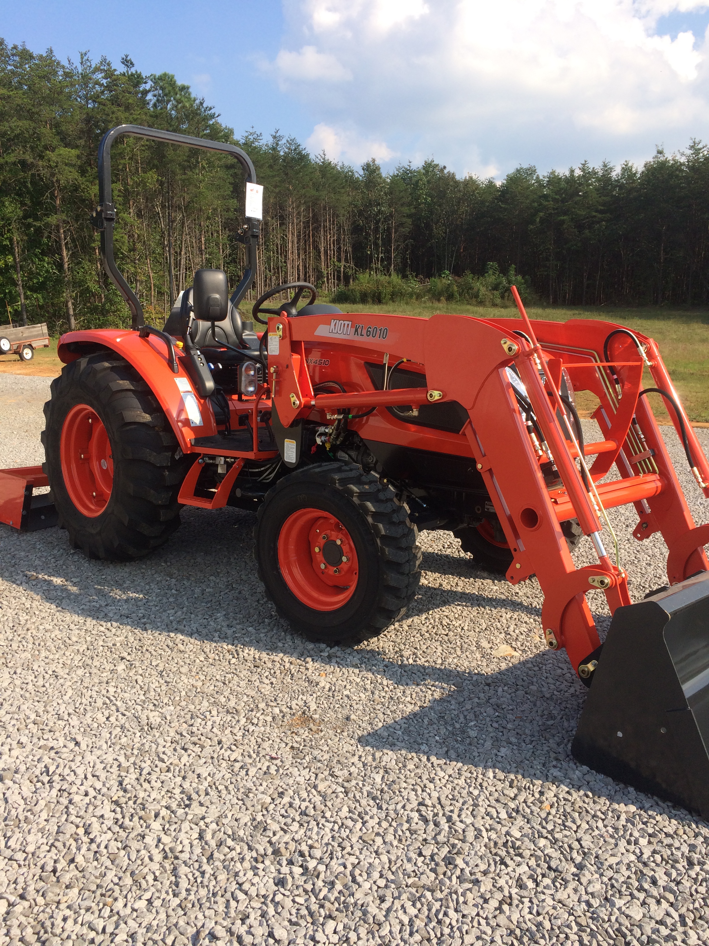

Called and ordered a Kioti NX 4510 HST on Tuesday of this week. The dealer delivered it Friday afternoon and I spent most of today testing it out. I ordered it with 2 rear remotes, a 3rd function valve and hoses, a 6 foot cutter, a 6 foot land planer/grader, and Rim Guard filled tires. I'm going to be looking for a grapple soon and I've got plans to turn an old bush hog into a custom 3 point ballast/tool carrier. Seen some good ideas on this forum.

- These were all pretty nitpicky issues but I do have one a little bit more serious. When we unloaded off the trailer Friday afternoon I spent about an hour tooling around before parking it in my shop. This morning I wake up to find a small puddle of oil underneath the engine and another small puddle of hydraulic fluid near the rear of the tractor. The rear leak turned out to be a loose bolt on the remotes that were added. The oil leak unfortunately appears the be coming from the front seal. I'm going to do some more investigating tomorrow to see if I can confirm. Hopefully I am wrong because I really want to continue playing with this new machine.
I'll get some pics posted up of it also in the next few days.

I forgot to add that the transmission fluid and the front axle oil were barely touching the stick after sitting overnight. Anybody else had any problems with fluid levels/leaks?
/ New NX4510 HST Initial Thoughts #4
That's pretty normal with any tractor. The L3940 here was the same after using it the first day, both were a bit low on fluid.

I have about 10 hours on the tractor so far. I have been very pleased with the performance with the limited time I have spent operating it. I still have a very slight oil leak. I called up my dealer last week to inform him and he was very helpful and reassuring. I am very optimistic about the service I will receive from them while getting the bugs worked out. With the leak being so small I was not in a rush to have it hauled back to the shop or anything so we decided I'd put a few more hours on it and evaluate it in a week or two.
This past weekend I had an electrical gremlin show up that I was wondering if any of you may have experienced. Saturday morning I noticed what seemed to be like a slight miss in the engine a few times and at one point the instrument panel went blank briefly before immediately returning. The engine never stalled completely out, just acted like a slight miss. On Sunday evening, I went to hook up to my bush hog and as I pulled away the instrument panel went blank, the tractor came to a stop, and the engine died. I was able to start it right back up and it ran with occasional misses for about 15 minutes while I was mowing. Then it died out completely again and I was unable to restart. I wiggled all the electrical connections I could find and then I was able to restart. It died several more times before I was able to get back to my shop, each time with me wiggling several different connections to get it going again.
Turning the key to the on position is supposed to light up the instrument panel and dash but now I cannot make that happen even by wiggling all the wiring harnesses, connections, etc. It is like it has completely lost all power or maybe a ground. I called my dealer back and they are going to schedule a time to come pick it up and carry it back to the shop for troubleshooting. I thought if I have the time this weekend I would disconnect any ground wires I can find and make sure there are good connections in all those locations. I already checked all of the hot wires that were obvious to me like the battery cables and starter connections and wiring harness under the dash. Does anybody have any other ideas?
Fortunately I feel very reassured that I bought from a very reputable dealer that has expressed their commitment to stand behind their product so I'm really not worried about the whole situation. I'm sure it is something relatively simple. I am still happy with my purchase and I would definitely recommend my dealer (Larry Stovesand Equipment) to anyone in the southeast looking to buy a Kioti.

I checked the battery and it is good. I'm leaning toward it either being a computer issue or a grounding issue. I did notice there was a healthy coating of paint nearly everywhere on the frame and undercarriage of the tractor and I'm wondering if a grounding wire is not getting a good connection.

Yesterday I was able to spend some time looking the tractor over for any loose connections, wiring issues, etc. I started at the battery and worked my way backwards towards the ignition and the computer and I didn't find anything obvious. Right as I was about to throw the towel in I found the problem by accident. On the "passenger side" against the firewall there was a wiring harness connector that may hand bumped up against. I had left the key in the on position to help me know when/if found the problem. When I brushed my hand across this connector the tractor's dash lit up and the fuel pump cycled on briefly, which let me know something was loose. After looking into it I noticed that the harness connector was not fully seated, and it looked as if it had never been fully locked into place as a zip tie on the engine block made the harness about an inch too short. I snipped the zip tie, connected the harness until it locked, and all is now well. I'm back to putting the tractor through its paces.

Best kind of wiring issues to run across!
On these tractors one has to watch out of wiring connectors and fuel lines. These things just beg to get messed with by brush and whatnot.
Be sure to let your dealer know so that they can relay it to the factory rep, and so they can put it in their prep check-list to double-check such things.
