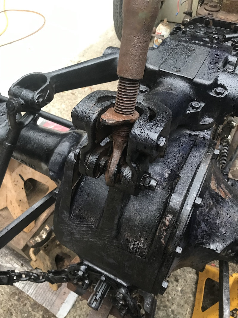

I tried to remove the center threepoint yesterday and it will not budge. I don't think there is some special trick to get the pin out? Probably stuck unless I am missing something? Hate to put the torch to it if there is some special way it comes out.
here's is a picture of it...

Hullo Gulkana, To remove the top link pin, remove the lynch pin as you have done and the pin should slide straight out. If it does not slide straight out, get a hammer and punch.
   / NEW! / old Massey Ferguson M35 diesel.. Could use a little help. Rear rims rusted out and other fun things #36
By the way Gulkana ,behind the top link pin, further in is a rubber boot, similar to the gearstick boots. If it is perished/split, change it as dust can get into the gearbox. It gets overlooked when people do the gearstick boots.

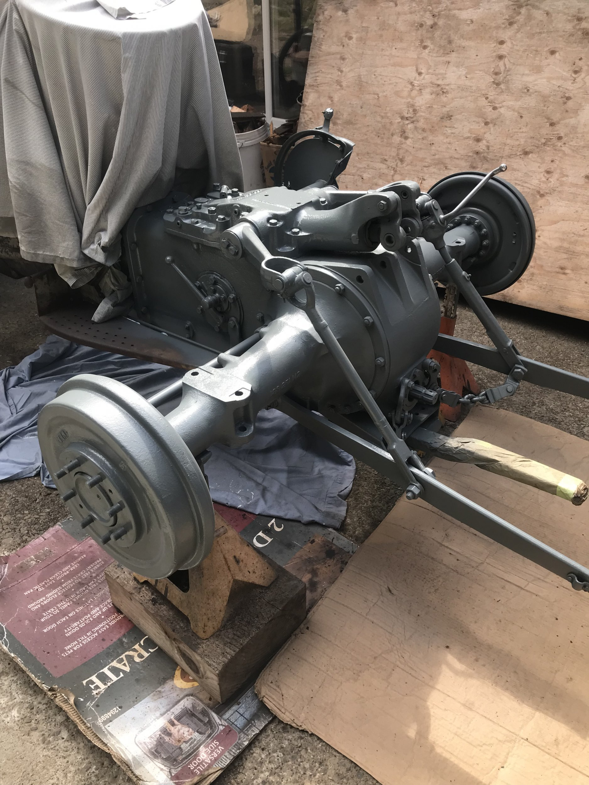

Update on the M35
I ended up cutting the pin on the 3 point. I couldnt get it to budge. I even put the torch to it and no deal. I had a credit at Tractor Supply so I'll get a new setup.

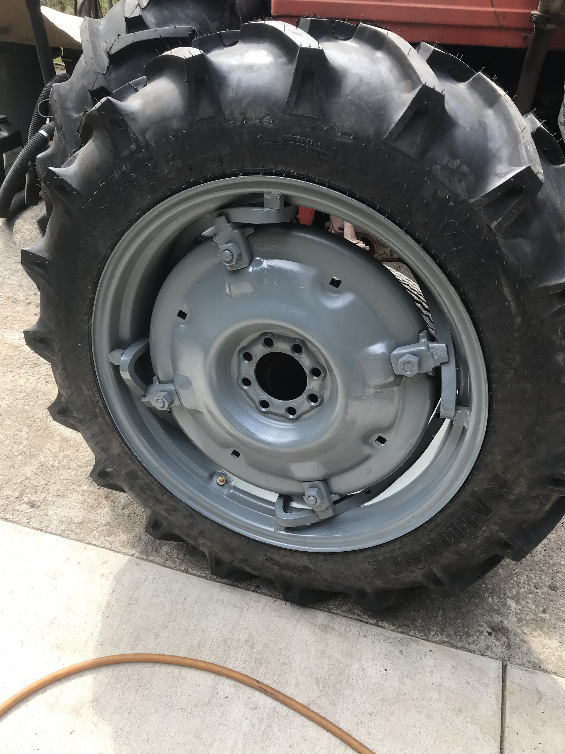

NEW TIRES!! YEE HAW!
Found a rim at Cross Creek Tractor. Reasonable cost and the shipping wasn't too bad. The rim is in great shape! Took about a week to get to me. I think they are in Alabama.
I painted the rim and back half of the tractor while I had the wheels off. I'll sand and paint the front later on. And that leads me to my questions. Does anyone have the paint code for the M35 (the red color on the hood and fenders? My book doesn't have it and the local paint store can't find it. I need the code or the name of the color. I know there were as many as 5 different colors on those. Mine is the Perkins Deluxe M35
