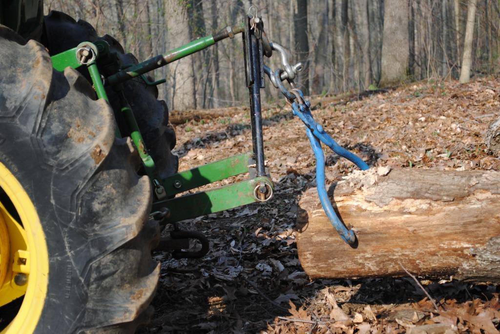

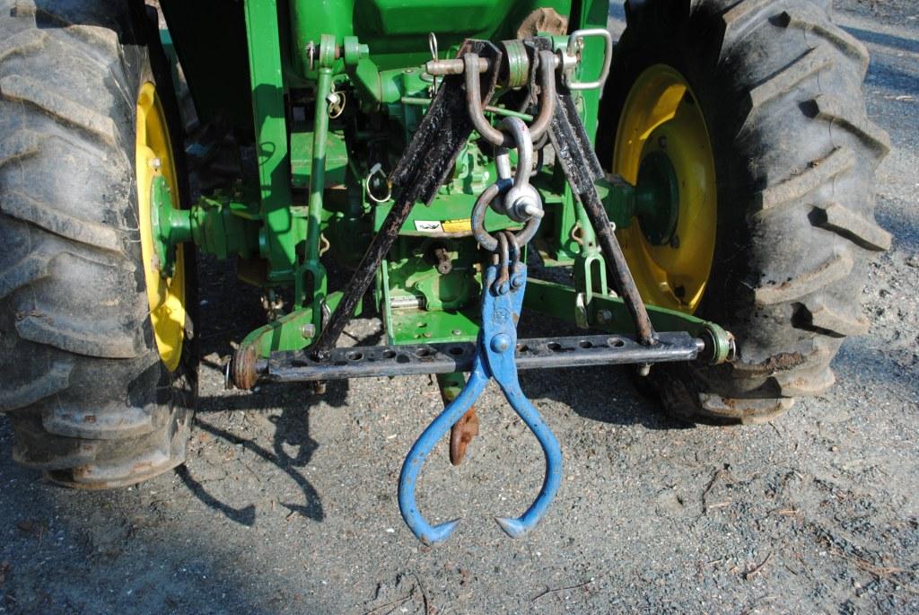

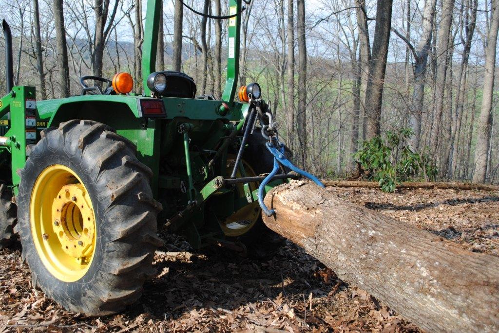

I pull logs out of the "bottom" with my 870 and had a pretty severe learning curve. Initially I pulled them with the drawbar but by the time they finished rolling around in the dirt the bark was stuffed with mud and that was murder on the chainsaw. Also the front of the log digs in and really cuts down the size of log you could pull. I came up with this gizmo to pick up the front of the log a bit.
But like most things, there is a downside-
My tractor pulls like a mule and the temptation to pull too big a log is always there. A load that's fine on level ground will quickly bite you in the behind going up a hill. Don't even think about going across a sideslope. If one of these guys decides to start rolling your tractor probably will be right behind.
Don't pick the log too high. 3-4 inches is plenty (early on, I found myself looking at clouds when the front end got light.) I usually cut a 5 foot log to put in the bucket to help keep things where they belong.
Wear your seatbelt and take your time.
Don't overload your tractor. I'd rather make a few more trips than pay for $$$ drivetrain repairs.

The 870 is rated at 28 HP and weighs 2670 lbs.
The 3038E is rated at 37.1 HP and weighs 2087 lbs. (Both w/o FEL.)
All things being equal, (through the magic of gearing), the heavier tractor will usually pull a heavier load. (Not busting your machine, of course.)

That'll work. Anytime you're stressing one end of your tractor it's a good idea to throw some weight onto the other end.
I like to kill 2 birds with one stone.
Rather than pull an 18 foot log up the hill, I saw 5 or 6 feet off and put it in the bucket and drag the remaining 12 footer up the hill.
Same amount of timber delivered, much easier on the tractor and safer.
Keep that loader as low as you can.
Adjust your wheels so that they are at the widest setting that is feasible.
Low gear is your friend.
