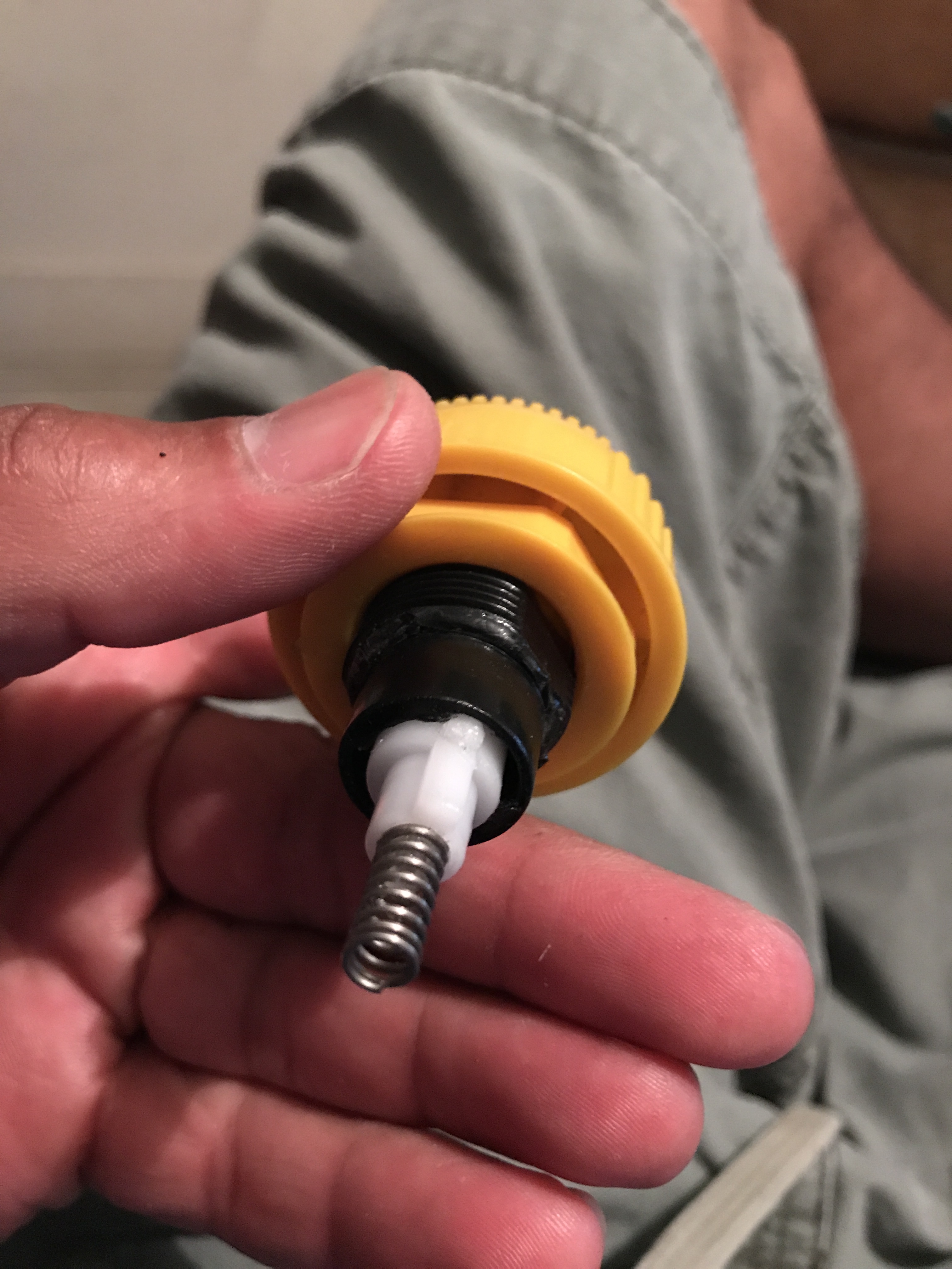

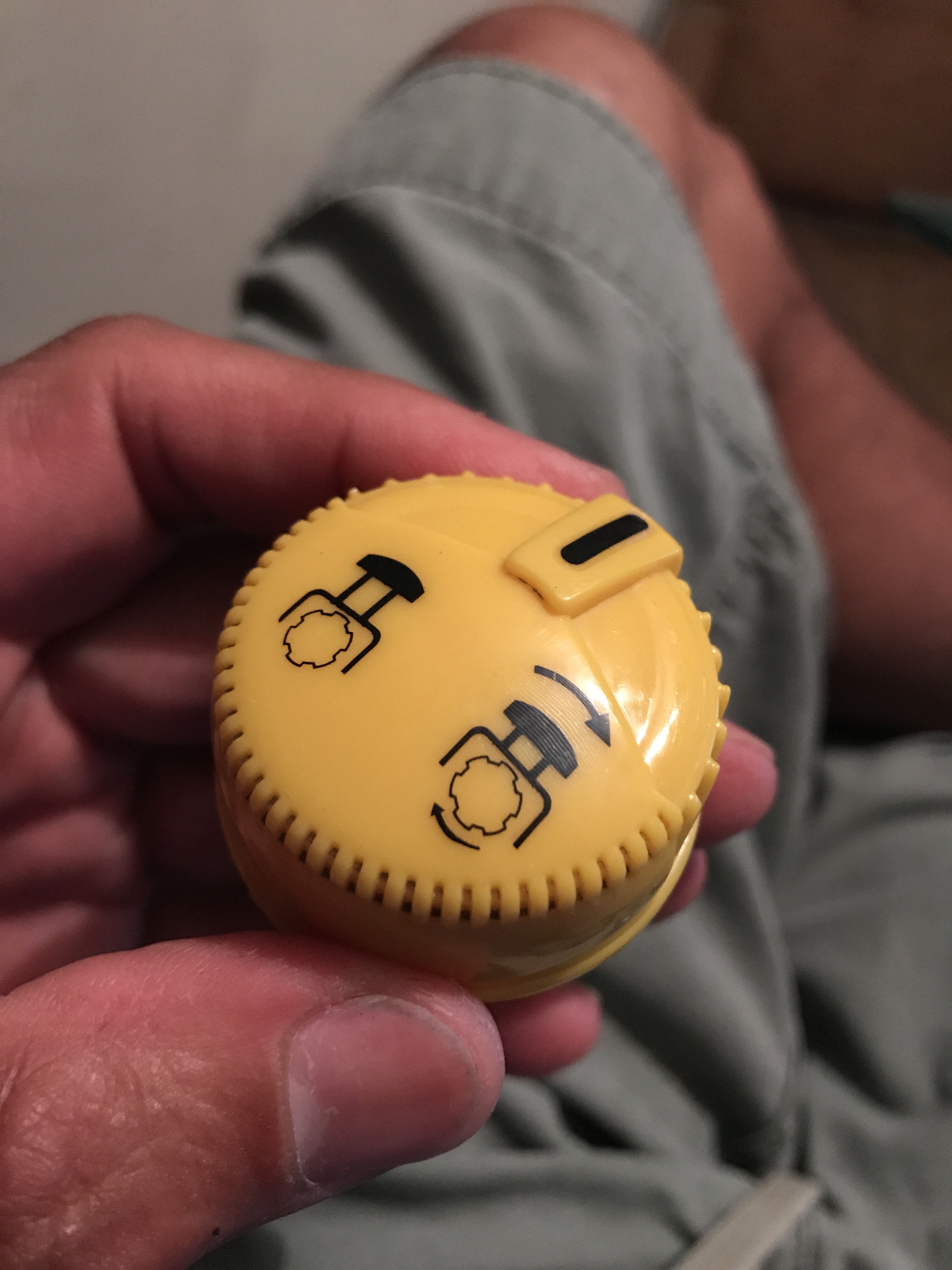

Did a quick search and didn't see anyone with my particular issue. Hope this thread serves as a catch all for issues and that someone can help me.
New DK5010 purchased in January and now with 101 hours. Mostly loader work and haven't used the PTO but a few times. Went to switch it on the other day and the whole knob just fell off. Anyone seen this and know if it's broken or if I just need to turn a few wrenches and re-attach it? IMG_7047.JPGIMG_7046.JPG
