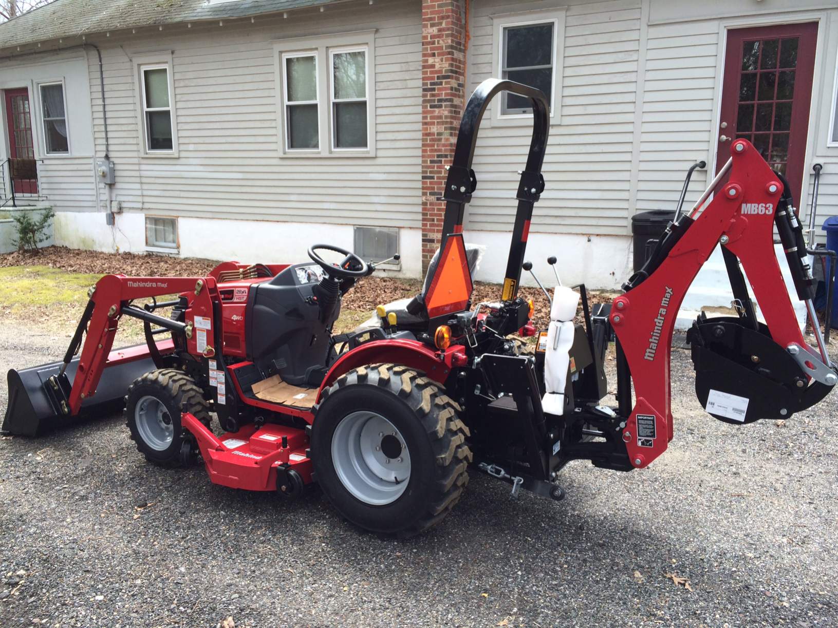

How is your deck suspended with the backhoe on? Also did yours come with mmm/backhoe/loader all installed from the factory?
Yes, all installed from the factory.
The deck is raised to it's max position and pinned at the rear frame. Since it needs the links installed to raise and lower it, it's fixed at one height. It operates fine if you like your lawn at 4in;) I might design a pair of small actuators to raise and lower it via the pivot points that would usually use the lift arms...who knows...lol, project for another day;)

Hi all - not to hijack thread here, but I too have new Max 28, no MMM but do have BH. It is very probable that I am missing the boat, but I am surprised that the lower (3-point) lift arms must be removed to mount / use BH! Once I cut the zip ties from lower arms I thought Hum.... where's the moutning point for these while BH is on! I even noticed one of our fellow Max 25 friends on here had the lowers and BH on - perhaps the difference between the 25 vs. 28? Am I missing the obvious or have you MAX 28 guys found a creative method!?!? THANKS!

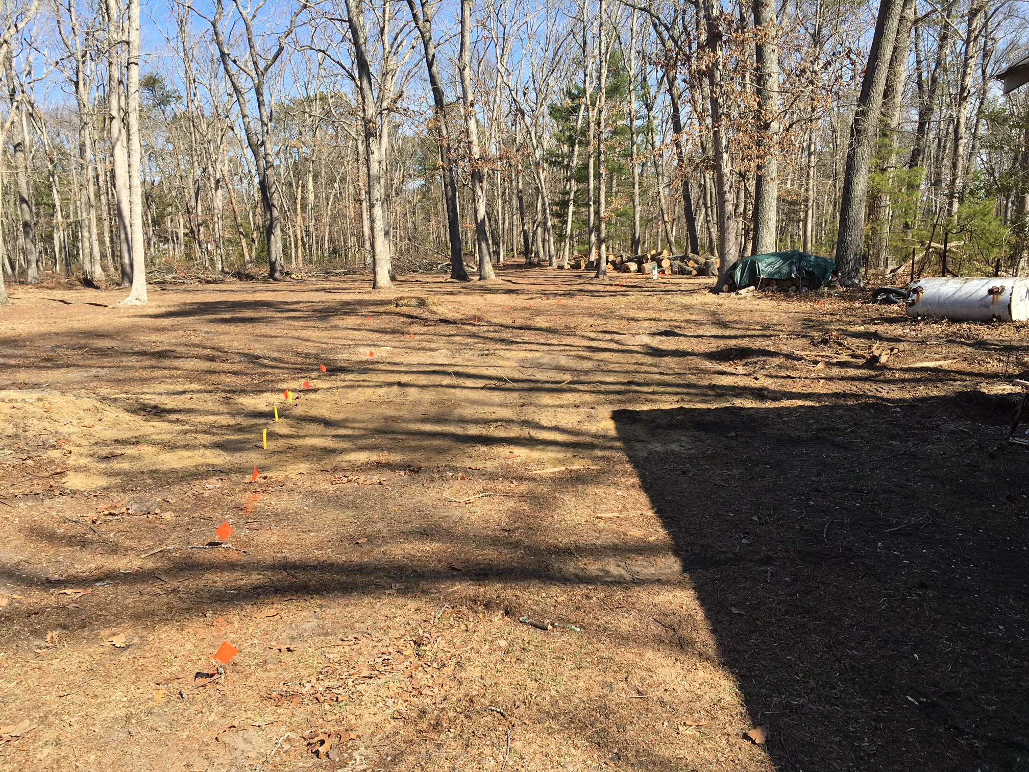

Realize this post is almost 2 years old, but if you're still on TBN, can you provide some more insight on how you groom that driveway? I just got a 26XL with a FEL and box scraper and would appreciate any insights you have on maintaining a long gravel driveway... have a 1/4 mile, sloping and twisting one myself that's fairly rutted from rain the past few years.

I just took delivery of a max26 last month and must be some new stuff. There is a "cross T" if you will that pins to my tow bar for the lift arms to pin too for bh. Mmm height is controlled via the 3 point lift arms

Take the tines off the box blade, the key is to use the top link to adjust the box blade for the correct cutting edge pitch. Most will have two cutting edges, one toward the inside of the box facing forward and one trailing edge facing back. Adjust the tilt until the blade on the front facing forward is just slightly above the ground, talking like 1/4in or there abouts. You want the rear blade to do the smoothing. So when it's set up correctly, the front facing cutting edge shaves the high spots and the rear cutting edge smooths and fills the low. Be careful of pushing with the box blade in that position because it will gouge the ground when going in reverse, not to mention it will put a great deal more stresses on the 3-point as it's designed for pulling not as a dozer.
