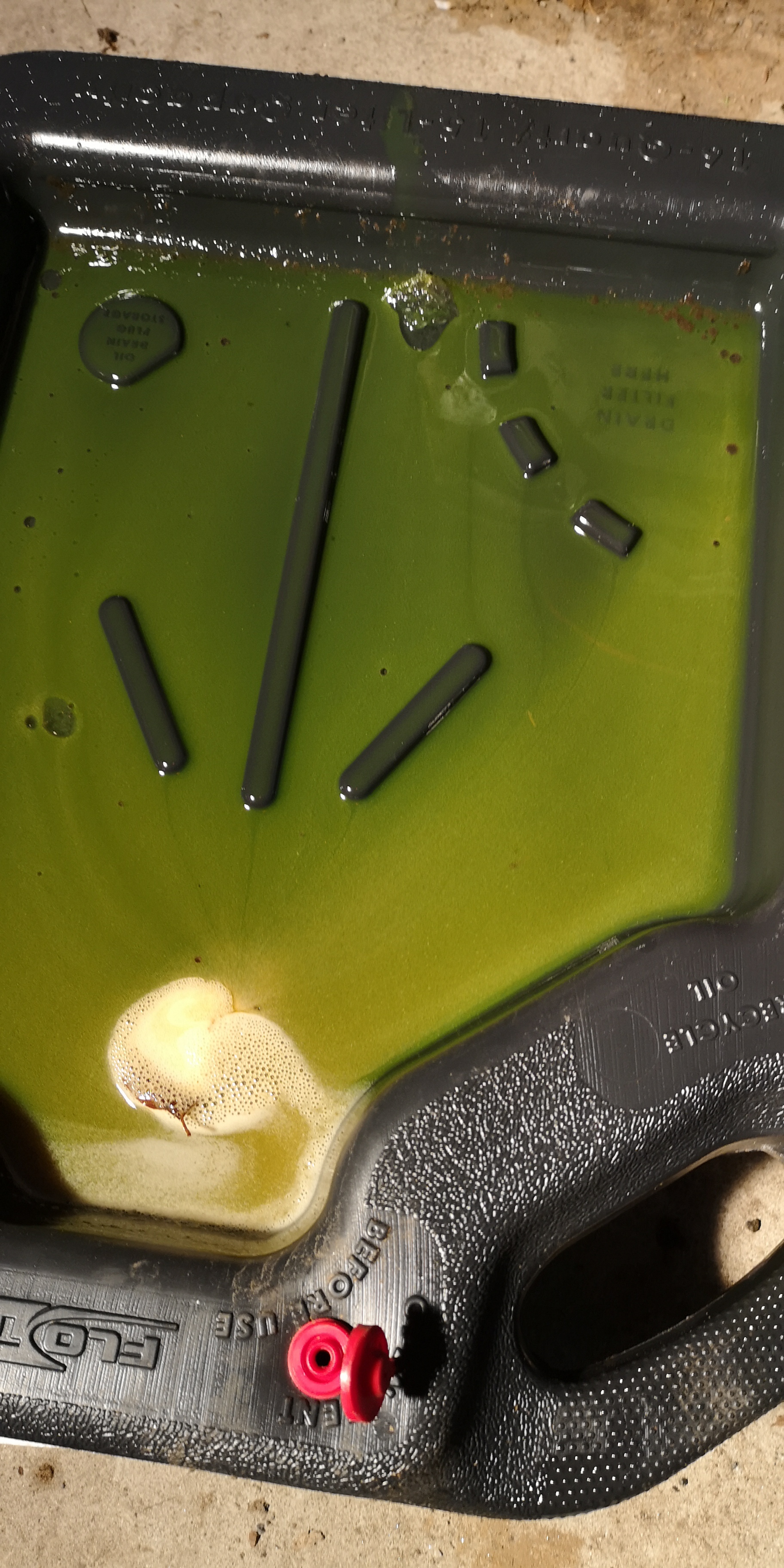

Congrats on the new toy! I also have the 1626h and absolutely love it. Just turned 65 hours and have loved every minute of it. I have noticed a tiny leak around the oil pan. I致e read about it multiple times on this model. I doubt it would be a problem, but I can稚 stand a leak on a brand new tractor. So, I will be taking it back to the dealer when I get a chance.
In regard to the water getting into the tranny, did you see obvious water come out when you drained it? My original hydro fluid was also 殿ntifreeze neon green? I was a little confused, but apparently the dye is added to certain brand hydraulic fluids to help identify leaks. I work for an asphalt company and our foreman told me that most of our new equipment is coming with green hydraulic fluid now. Looks just like a coolant leak out on the road.

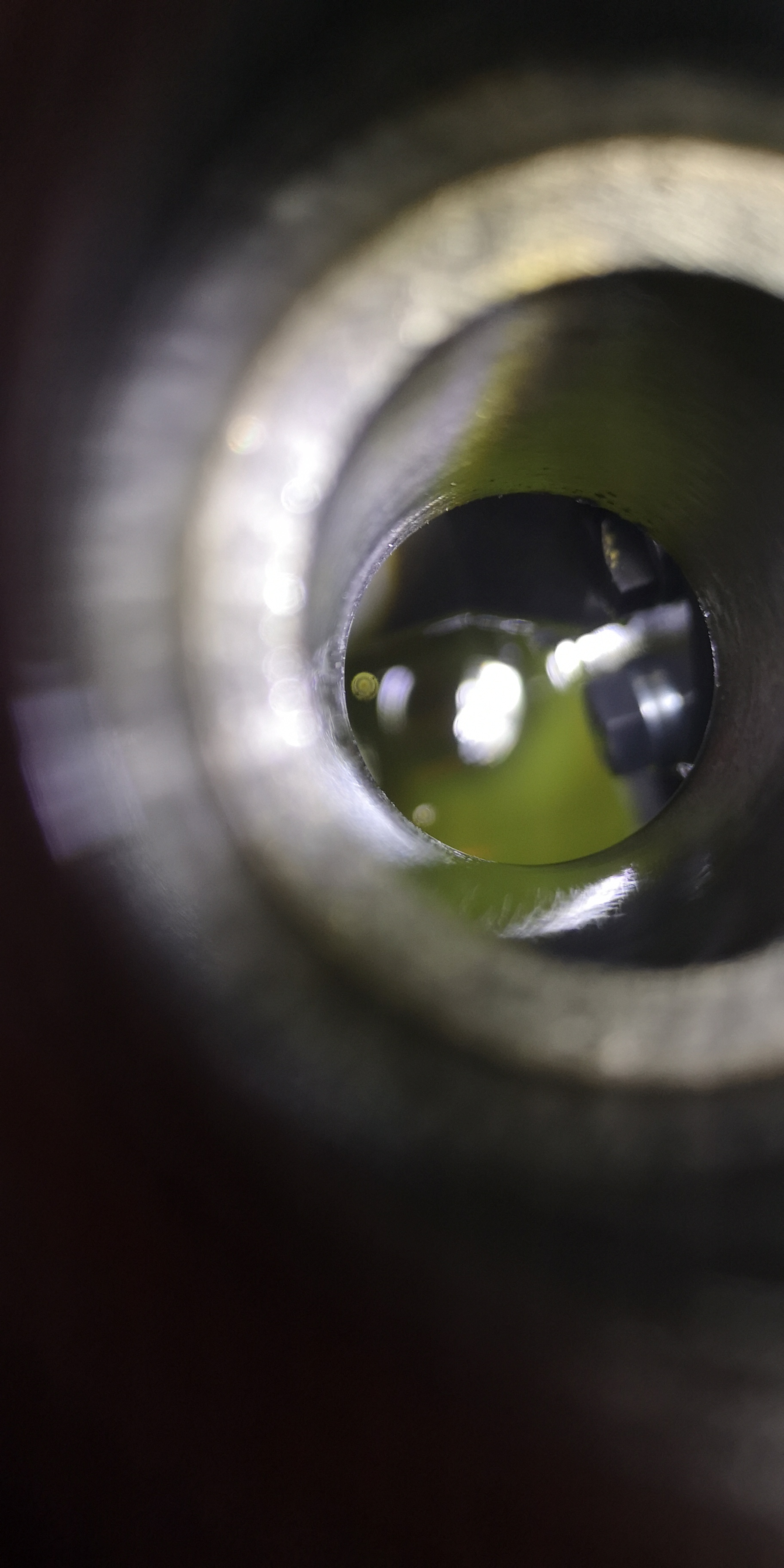

I am glad to hear you say your colour was the same. I still believe there was water because it was dyed green but also had a sort of white milkly look in some parts of the fluid ( like there was different liquids in it) i will post pics. I can tell my tractor sat for a while based upon the rust around the gas cap and rust around the tranny hole. Also battery terminals have some corrosion. So far with the new fluid my shifting from differemt ranges seems to be alot easier. I am going to change out the fluid once again after doing a seafoam treatment. it is too bad because itbis costing me and extra 300$ or so in fluids but i am **** about fluids and plan to keep the tractor forever so dont mind spending the extra tp baby it. I will post pics of the fluid. Also i am up in canada where condensation and temp chages all the time.

The service manager said the fluid was a weird colour but agreed that this did not look right. I have been texting him all the steps so it is on record if i need any warranty.the only thing i am a little concerned about is possible rust in the tranny which i will inspect at the 50 hour service but i am not overly concerned.
