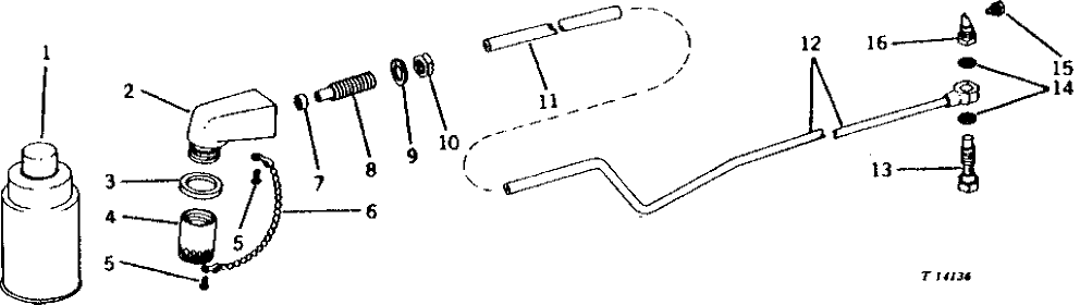

Hi, not sure anyone replied to your questions on PTO Speed or starting? But the 1020's didnt all come with two speed PTO's. If yours is so equiped there is two levers on the left side of tractor behind left foot area on main body. Rear most lever is to engage PTO, the forward one is to control speed. As for starting? Early model 1020 in winter you need to have a block heater to aid in starting. They did not come with glow plugs or ether injectors. Some of late models are said to have glow plugs, but I have never seen one, nor are they listed in my parts manual. Good luck, thats a good old tractor
Myraddin
I'll correct a few of your incorrect statements.
No block heater offered on a 1020 as there was no hole to install it. One must use either a tank or hose heater. No glow plugs ever offered on a 1020. 1020 had an ether starting aid,see attached photo.

You are correct about the block heater not offered, I meant to any type coolant or oil heater to aide in starting during colder weather. As for ether unit? not all the 1020's came with them. Mine is a 1966 model and did not come with one. You may be able to find one and retro fit it to your tractor though. Best Wishes, seems alot of people like this old tractor
