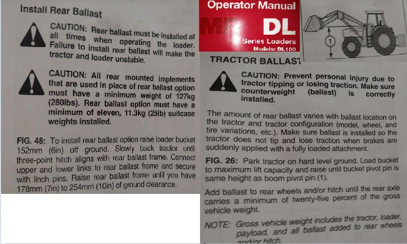

Here is what was in my MF DL 100 loader for Ballast. It does say you can use an implement as an alternative as long as it meets the minimum weight.
