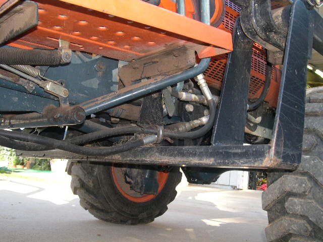

Here are some photos of the TC30, a TC33 with a 15LA and another with the 7308 loader, plus a photo of my tractor with the 16LA loader. You can clearly see that if there is no backhoe installed on the TC30 and TC33, no subframe is mounted. When the TC30 has a backhoe, the subframe is added. However, on the TC45 with the 16LA loader and no backhoe, there is still a subframe. The subframe on the TC45 and all Class III Boomers is very beefy. Is this the info you were looking for?
Yes, Those are great pictures. My TC-29D is just like the TC-33, there is no subframe, I love the subframe on your tractor, wish mine had one like that.
The subframe on the Woods bakhoe attaches to the loader frame with one long pin. The holes that the pin go through are not machined for a close tolerance fit, so there is some play in that attach point. My guess is that the backhoe subframe is designed to support the backhoe and not to reinforce the loader.

Jim-Do you know of a loader for the TC30 that comes with a subframe?
I don't know of a loader with a subframe. If you want a subframe on a TC30, you have to have a backhoe. Actually, I think it is highly unlikely that you would ever do damage with that Rhino 2408. It has a lift capacity of 1335 lb at the pins. Once you add a bucket and go out about 19", the lift capacity is well below 1000 lb. I think the likelihood of your ever having a problem is very slim. There have been TC30s with casting problems in the bell housings and some with loose bolts that put extreme stresses on the other bolts. I just don't think the TC30 is prone to breaking anymore than a Deere, Kubota, or any other tractor. Use your tractor sensibly and it will last for a long time.:thumbsup:

Very interesting pictures.
I definitely agree, our TC40/45's have a really beefy subframe.
I would note that my old Kubota, when I added the Bushhog loader, had a beefier subframe mount than the 7308 loader, with multiple mount points spreading the stresses.
I wonder how hard it would be to make a subframe add-on for something like the TC30...?
