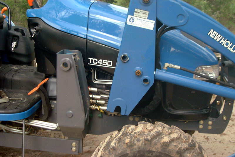

Could You explain exactly what you mean by "sub frame". My TC-29 has the 7308 loader and it mounts to a frame that crosses under the tractor just beneath the bell housing. I also have a Woods backhoe with a sub frame that attaches to the loader frame.

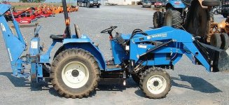

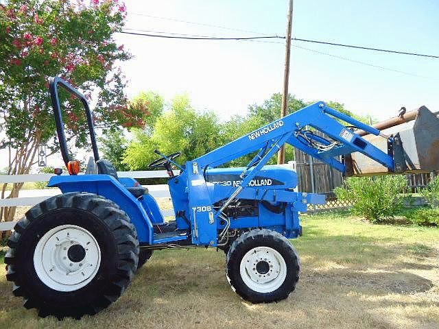

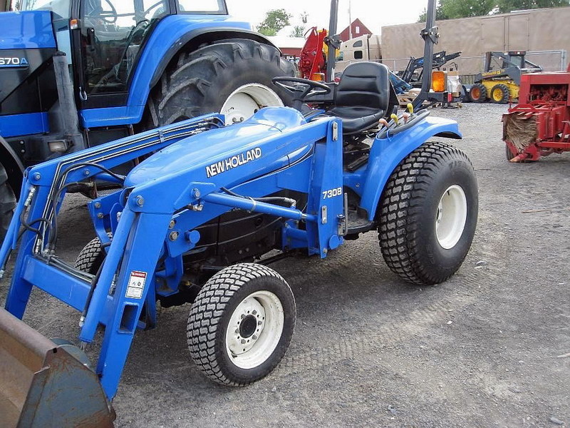

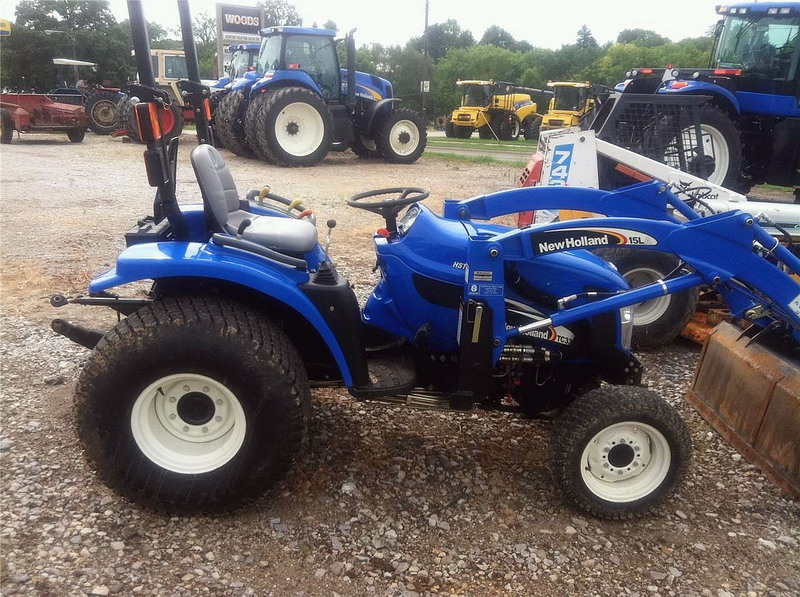

Here are some photos of the TC30, a TC33 with a 15LA and another with the 7308 loader, plus a photo of my tractor with the 16LA loader. You can clearly see that if there is no backhoe installed on the TC30 and TC33, no subframe is mounted. When the TC30 has a backhoe, the subframe is added. However, on the TC45 with the 16LA loader and no backhoe, there is still a subframe. The subframe on the TC45 and all Class III Boomers is very beefy. Is this the info you were looking for?
