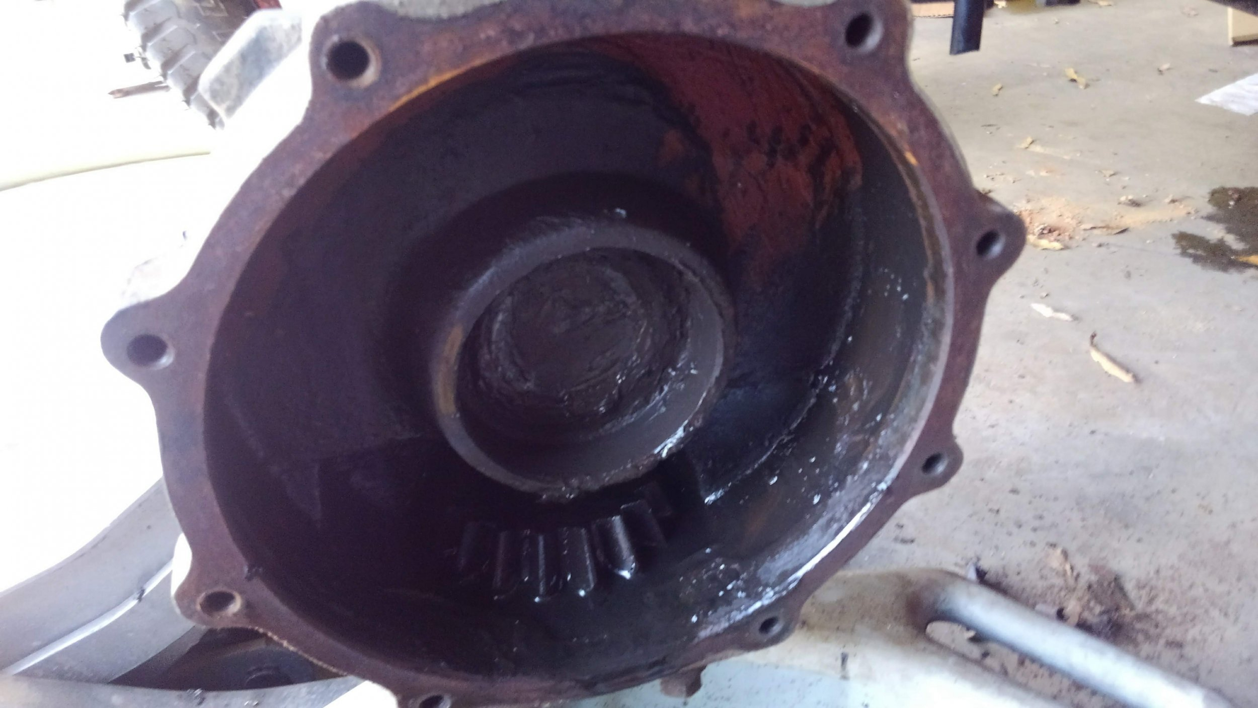

Had to rebuild the whole left front final drive assembly after I got it running. The lower housing was full of a water/oil sludge slurry. Someone had been in there before and put several parts in that were obviously not for this application. I'm surprised it drove at all like that.

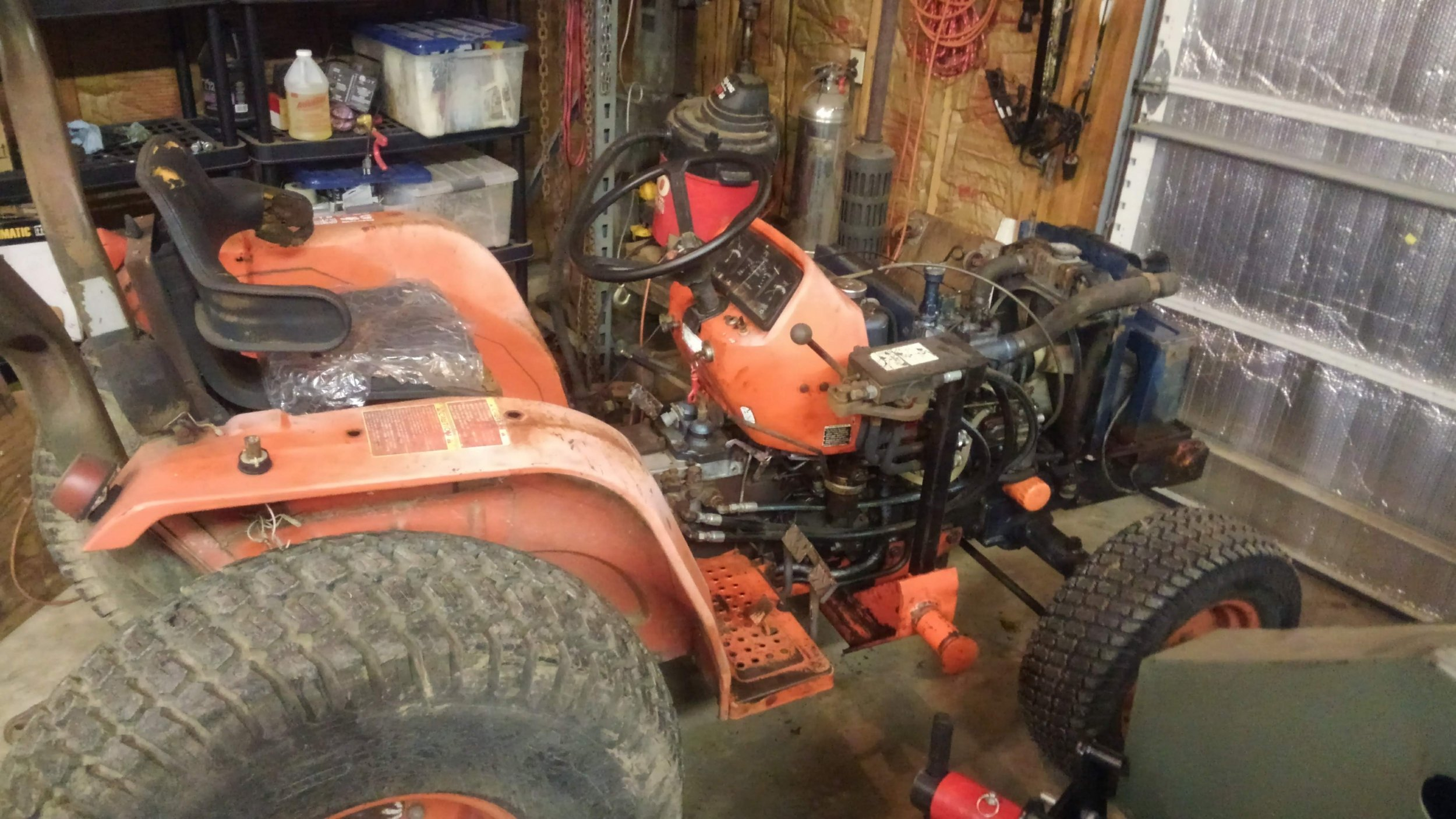

Found problems with the steering linkage once I put that back together. The drag link and the hydraulic slave were both bent, along with every rod end on the hydraulic assist being completely worn out. The main steering rod that actuates the hydraulic cylinder was out of adjustment and the rod ends were so siezed I had to get them red hot with the torch to get them to budge. Ace hardware actually carries the rod ends that needed replacing but of course because of the supply chain issues right now, only one of the 5 area stores I went to had any in stock, and they only had one of the 3 I needed. I straightened out everything that was bent on the press and cobbled the old rod ends back together to temporarily run it until the new parts arrive. I kind of want to stop talking about what needs fixing on this thing because the list keeps getting longer lol.

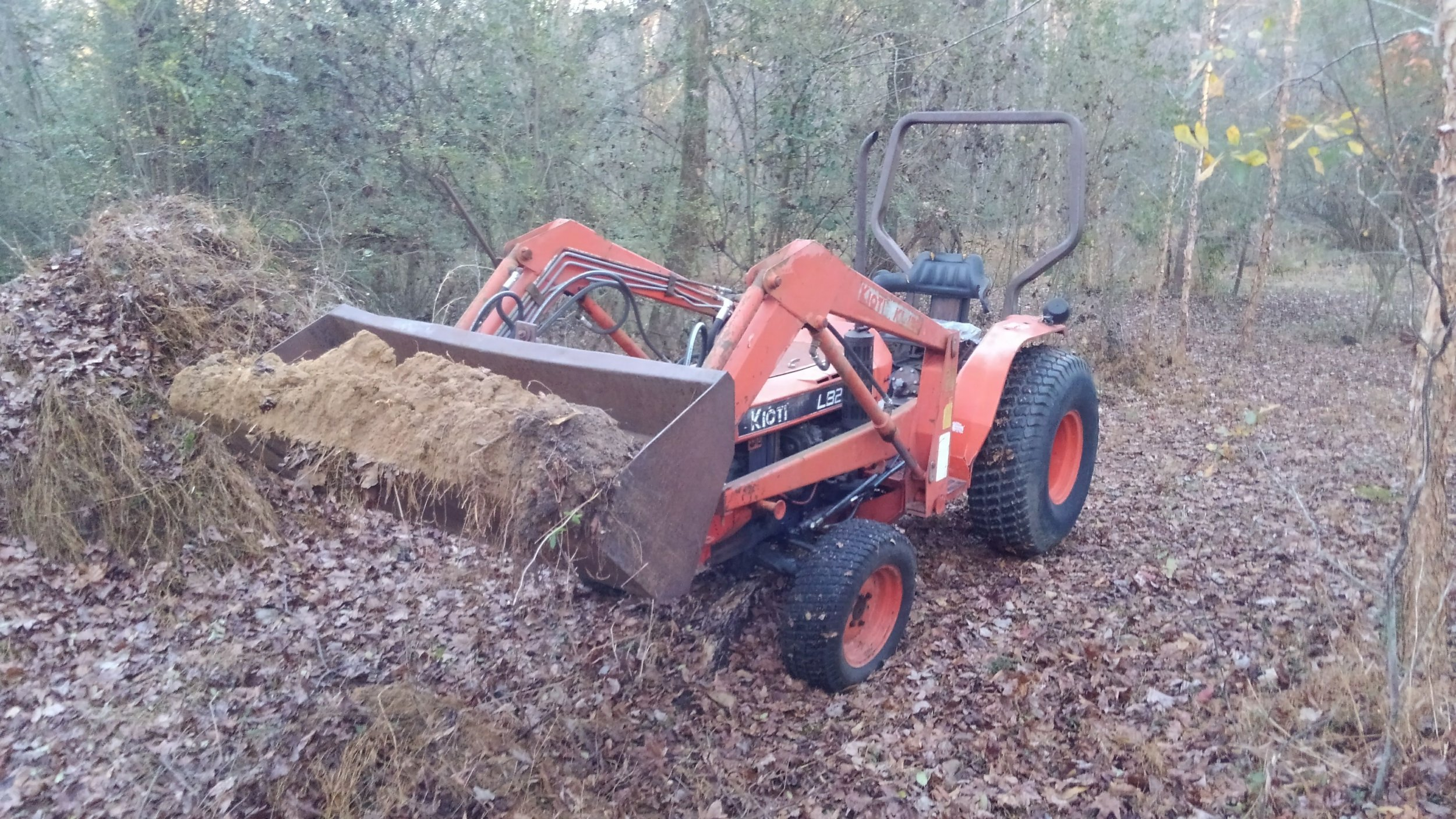

Anyway, I did get the front end in sufficient condition to mount the loader on the front and I moved my first dirt with it! Even though the hydraulics are F'd and running dog slow I was able to slowly actuate the loader and knock down this huge pile of dirt a bit that's been bugging me since I bought the place. Even limping it along I moved more dirt with the loader in 20 minutes than I had in a day's work by hand previously. Well worth the trouble to do the rebuild.

By the way, all the finale drive bearings and seals are the same as the L245. I used generic ball bearings because when I first pulled it apart I didn't have any part numbers and just went off of measurements. The seal assemblies are uniquely engineered for this application so I needed to get the proper parts specific to it from the dealer. I got ahold of the LB2204 parts book and even the part numbers are Kubota numbers just like the engine. I would recommend measuring still on the bearings because the inner hub bearing was actually different than the Kioti parts book. It called for a 6206 ball bearing in that location and it actually needed a 6306. Who knows, maybe this final drive housing is off of another machine. There's no casting stamps so no idea whether it's original to this machine. I walked into the Kubota dealership and ordered seals for a later model L245 and they worked save for one thing, the collar that presses onto the bevel gear shaft. My shaft was so worn that the new collar was loose on there. The old collar was just flopping around on it and had worn the shaft undersized probably about 0.050" so there was no way it could work. I made my own up on the lathe to the same specs but undersized the ID a bit so it could be pressed on with some sleeve retainer. No leaks and the wheel has zero play with everything bolted together. The other side is weeping a little bit so I'm going to put that on the list, but at least it doesn't need a full rebuild, just seals.
