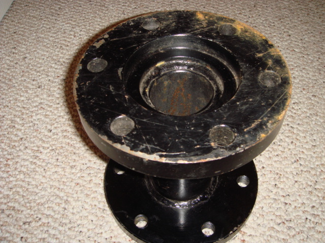

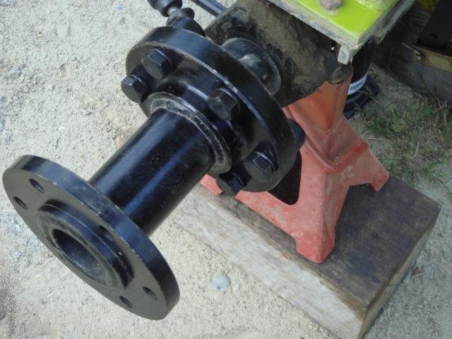

Svcguy, you wouldn't have a picture of the hubs axle side would you?

Attached are three pictures, one on the axle and one of each side.

Svcguy,
Thanks very much, I'm glad you took the pics during the mounting process. Thsi will really assist the maker.

I always thought those were for dual wheel setups.
Bruce
   / New owner old Yanmar #28
The parts book calls that one 'Extension, rear shaft' then a few pages later shows a longer one called 'Spacer, double tire'.
   / New owner old Yanmar #29
I thought they were dual wheel spacers when I bought them with the tractor, but after calling Yanmar I was able to confirm they were axle extensions to increase the width of the rear wheels. I don't believe they were common to Japan, but available for certain North American models. Japan tends to favor a more narrow configuration based on their agricultural needs.
Good observation Bruce and probably important for folks to realize these were manufactured for the YM240 (YM2000), but not necessarily engineered for all tractors. Axle extensions put a lot (a lot more than we would think) strain on tractors. Unless designed to use them, they are not recommended for obvious safety reasons. Losing a rear tire from a axle fracture could result in a roll over.
