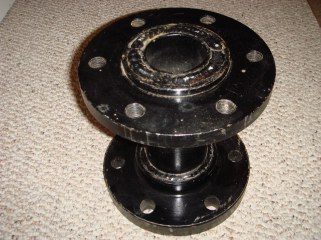

Another possibility are the extensions originally manufactured for that particular tractor in the States.
YM240D hub extensions:
Flanges are 6.855 across, .867 thick.
Hub is 6.905 wide, outside to outside (including flanges). Accuracy .001
Axle side hub is drilled, other threaded for lug nuts.
Axle side hub recessed to accomodate axle flange 3.716 x .564 deep.
Flange for rim, 3.721 x .289 high.
Inside diam of pipe 2.108
Outside diam of pipe 2.740

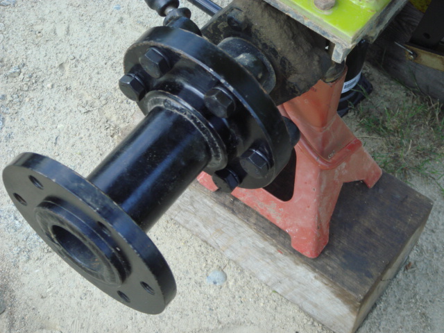

In the original parts book, this is part of the 'adjustable rear system' with a reference to it as a 'extension, rear shaft'. I have them mounted on my YM240 and they really help. I do not run ballast in my tires, but made large wheel weights for mine.
Attached are three pics, one of the hub, one mounted and the tractor.

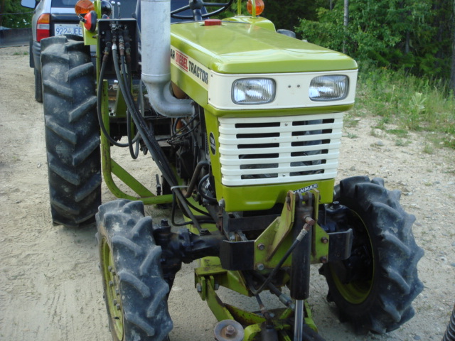

Man, thats neat.... Oh, your last pic (showing front of trac) shows front wheels in narrow stance.I think, swaping left/right wheels should widen front stance too?
Just my personal opinion - I think for the front it is a good idea to keep the wheel centered over the inner and outer wheel bearings, to keep the stresses where the designer intended.
I don't think the front is going to help much in resisting a rollover. By the time the chassis (engine block) comes down to hit the top of the axle, you would be tipped pretty steep, maybe beyond the point of recovery.
Then snapping an overstressed spindle would tumble you over for sure.
I see those rear wheel spacers in YM240 Operation, and YM240 Parts, under Optional Equipment at the back of the book.

LMTC - Information is from the 'Yanmar Diesel Tractor Operation Manual' Model YM240 / YM240D. This is the actual operation manual delivered with the new tractor in 1979. The axle extensions are pictured in the parts pages (page 17) and labeled 'Adjustable rear system' as part number 15, listed as 'Extension assy, rear shaft'. I called Yanmar America and asked if the extensions were safe to use and they confirmed the rear axle / housing /bearings were engineered for them - no problem. Yanmar did confirm that the original extensions are out of stock. I think the only recourse now would be to build them and assure they are dead accurate. Mine are within a thousands of an inch runout.
For the front tires, the comment to NOT reverse the rims is correct. Yanmar confirmed that the front rims should not be reversed for a wider stance as the spindels could fail. While the rear axles are built to allow for reversing the rims for a wider stance (including the axle extensions), the front spindles are not engineered for reversing the front rims.
