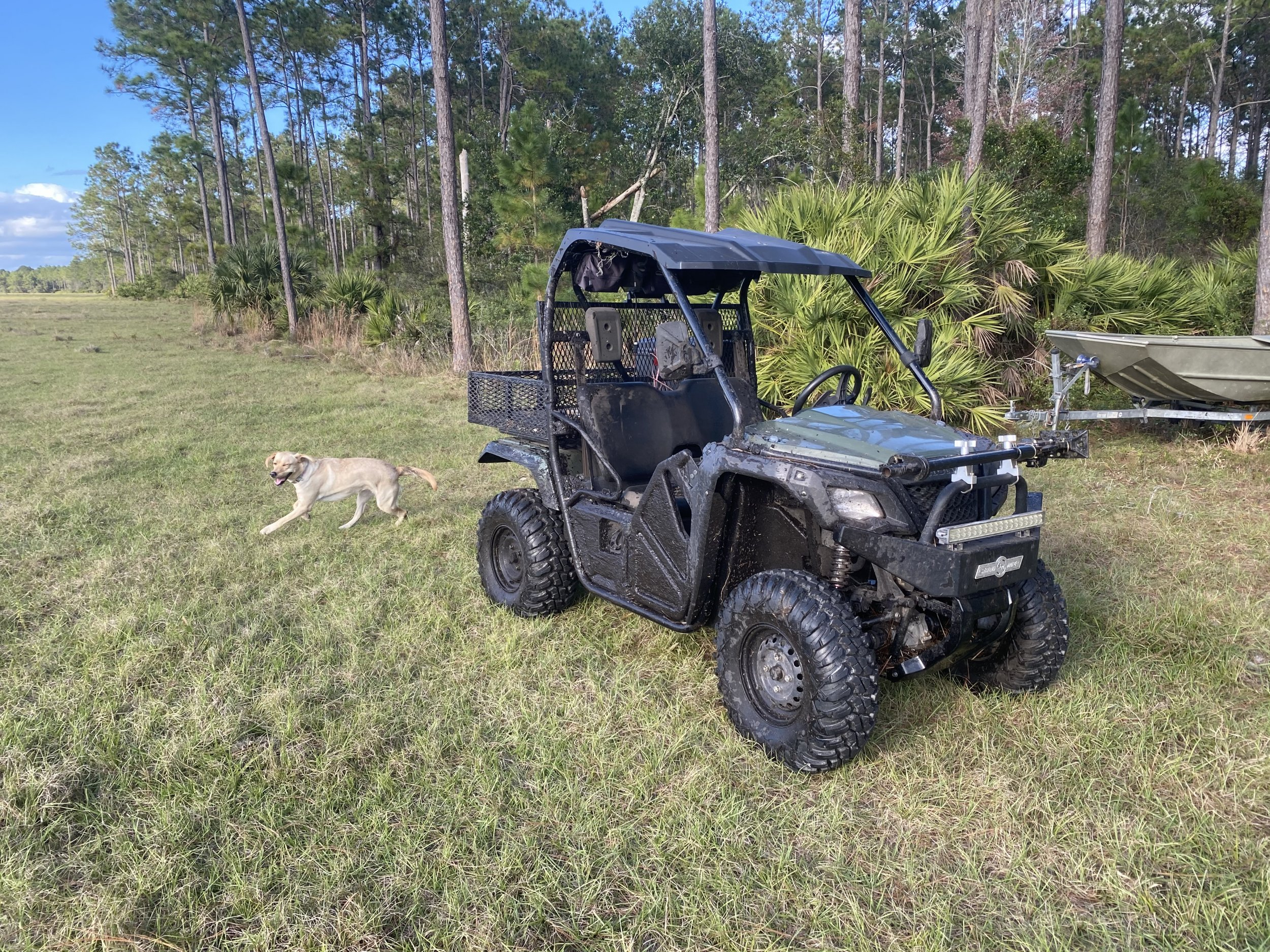

I’m considering adding taller tires. I’m not looking for mud tires since most of my driving is around the property and on trails. I’d like to get 27’s or maybe 28’s if they’d fit. However, I would like to maintain the width if at all possible. Anyone have any suggestions?

I think the 520 has plenty of torque in first gear. I don’t mind giving up some power and take off speed in first. It would be a shame, however, if I could no longer do donuts, lol
My biggest complaint with this machine is the gearing. The gearing is too low…it would be great if it had 6 forward gears…or slightly higher gearing.

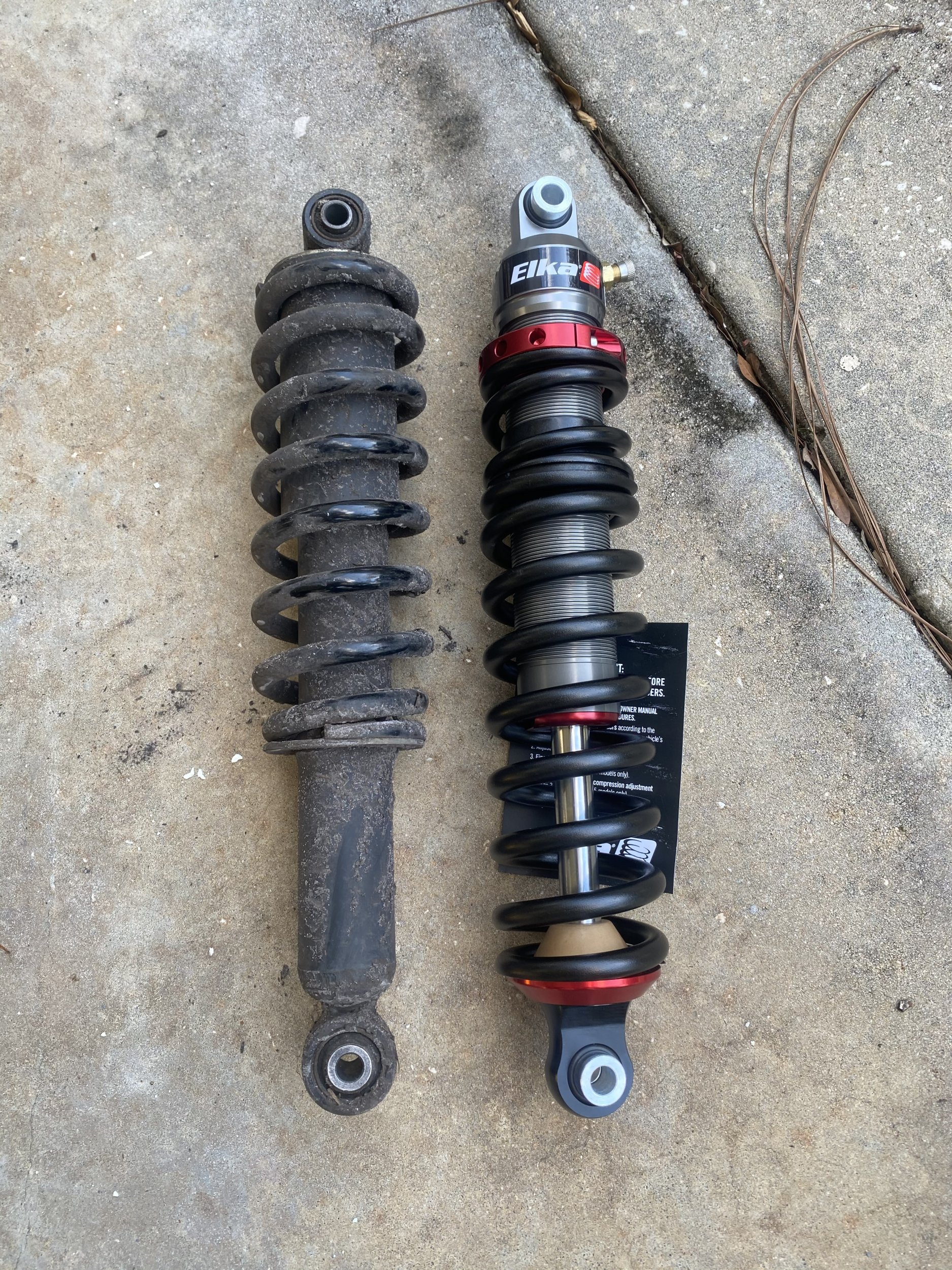

I run 27x9 and 27x11 Tusk Terrabite radials on my 2015 Pioneer 500. It was a great upgrade! The radial tires ride much better than the stock bias ply tires. The 27" size looks like it belongs on the P5 and I did not notice much of a power difference at all. These machines do not boast huge power ratings but their gearing is so low it really doesn't matter (not for 27" anyway).

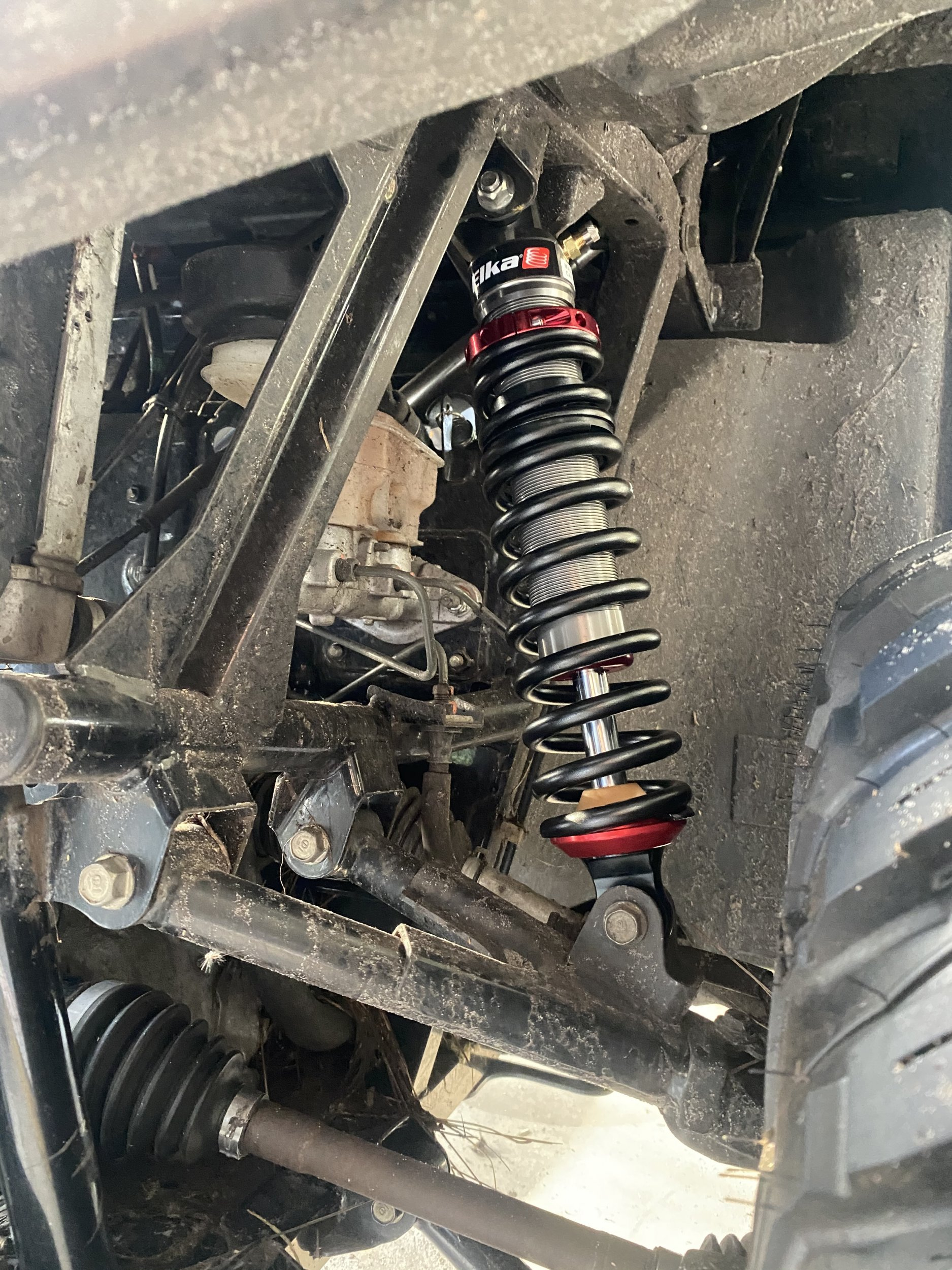

I would say the Tusk Terrabite's are the second best thing I've done to my P5 because the Elka Stage 1 shocks has been my favorite upgrade! They really help the limited 5" of travel improve ride quality and rebound.

Good question! If the budget is tight I would do the tires first. Plus, tires are readily available and the shocks will take ~8-12 weeks last I heard. Both are a big improvement though

We both noted on the last adventure that the suspension is quite unforgiving. So, I was thinking maybe springing for the suspension first, then go for the wheels/tires since they're readily available.
