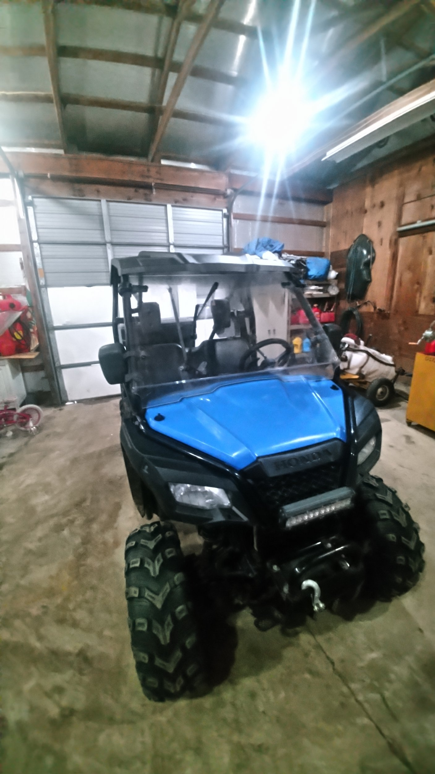

I have had Terrabites for about 3 years now and am very happy with them.
I do not go on trails. Mostly gravel, dirt, and grass. these are 27 x 11 x 14s with ATI wheels on a 700-4
Rare use pushing snow with a plow but worked well with snow/ice mix.
DOT approved if that matters to you. Guessing you can get them in 12" wide if that is stock for a 520.
It was very popular for SXS owners to put a lot bigger tires on small wheels but with low inflation, they were popping them off the rims on hard impacts in rough terrain. So watch out for old info online that may send you in the wrong direction.
I think 27s work fine on 12" rims (I think that is stock?) but that's me. good luck.

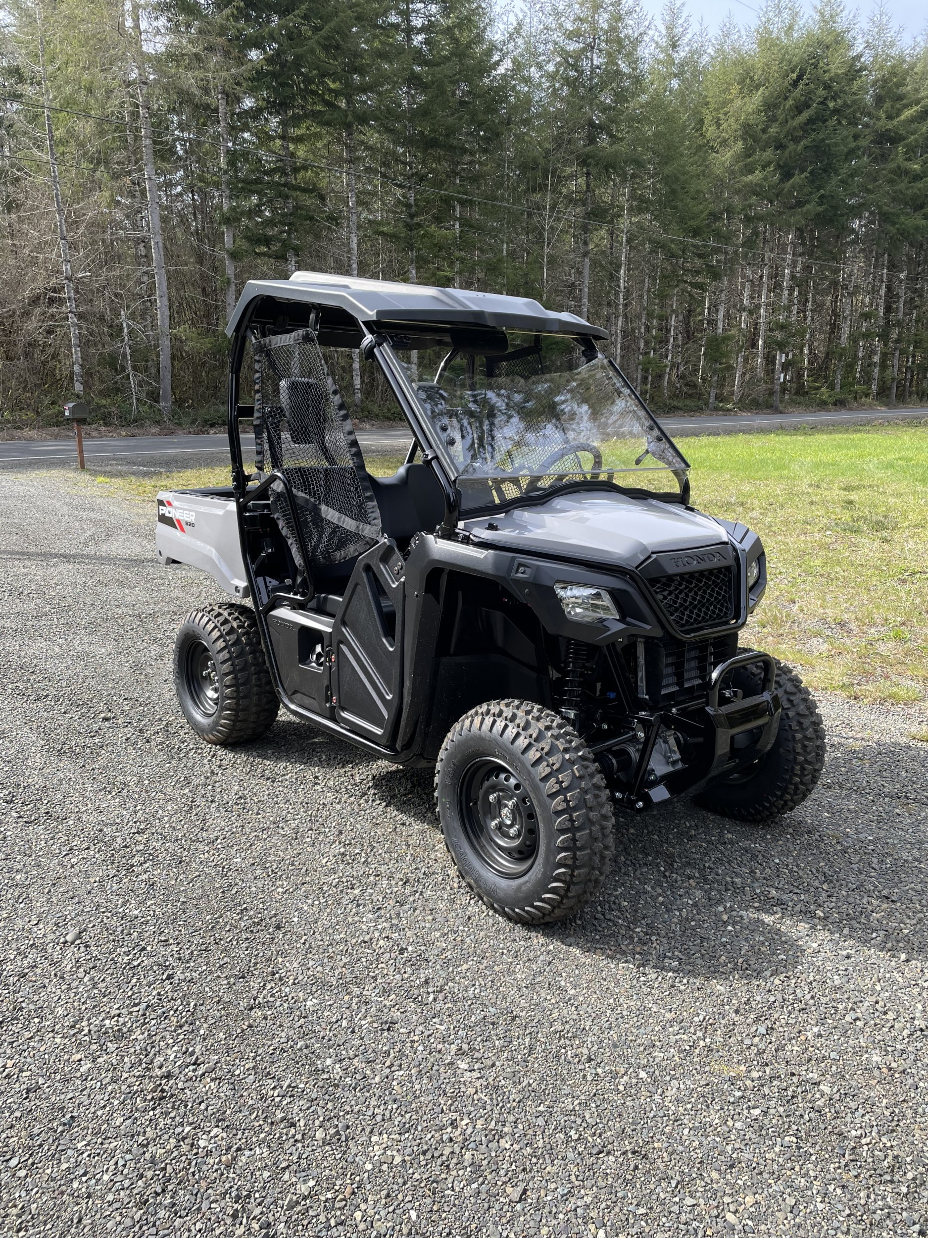

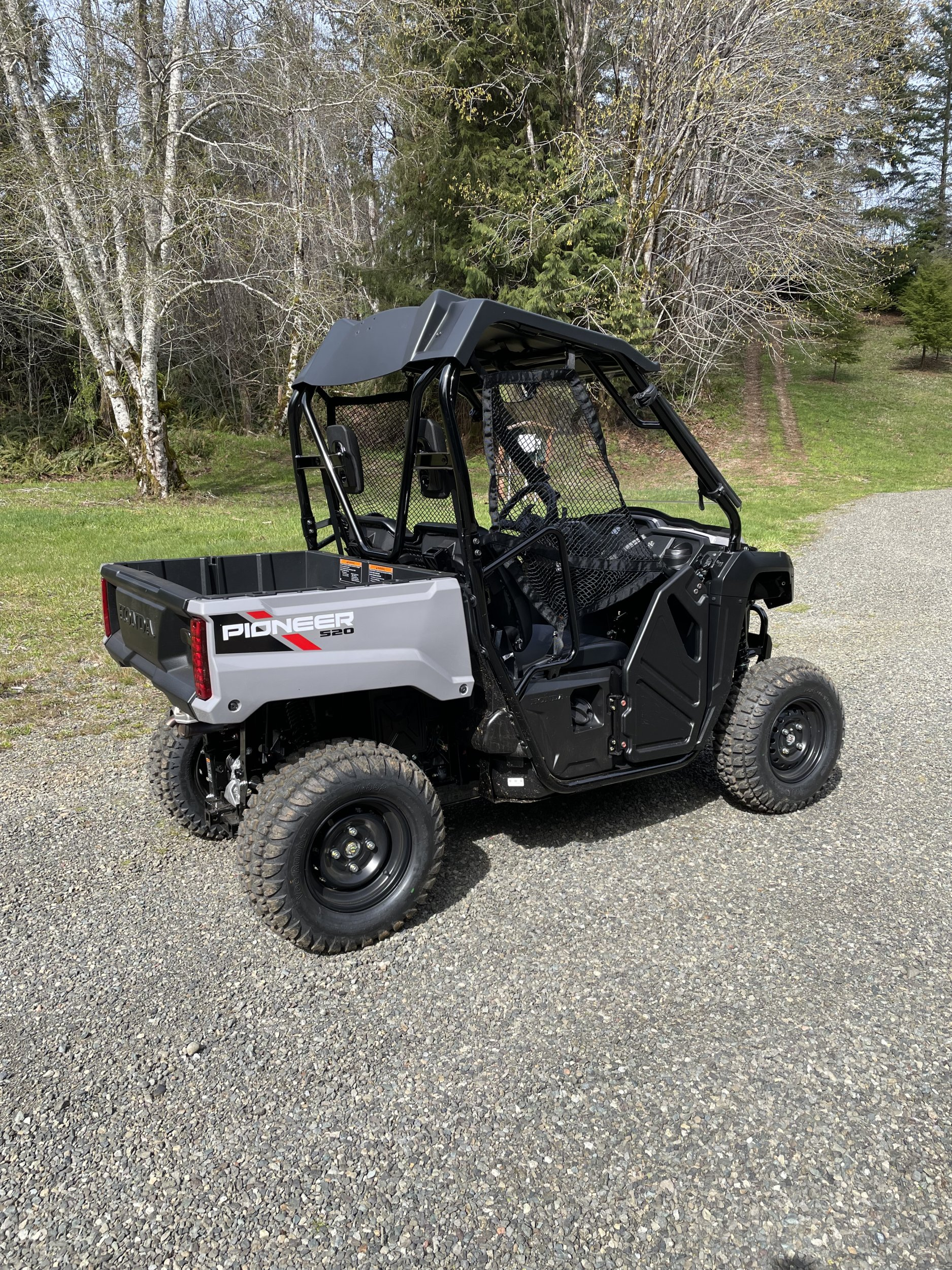

You have a couple of options - one is wheel spacers for a little width or new rims with more offset. The little Pioneers get a little tippy as you raise them up since they are already sort of narrow. Also, don't forget the larger tire start to up your gearing so you will notice a power decrease. I wouldn't go over 27" tires personally, 28's are big tires for small machines. I think I had 26's on this machine and the attached is the tipping point.
