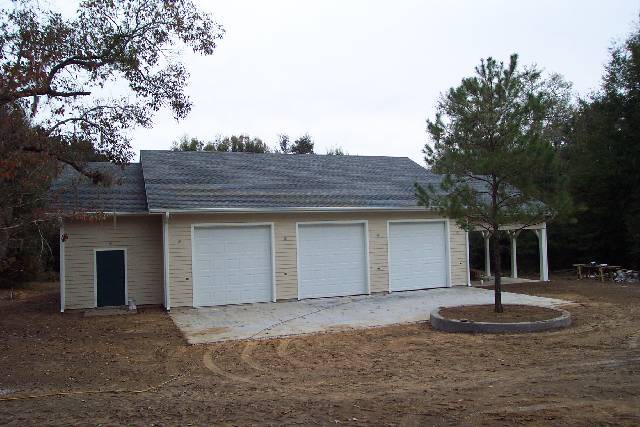

/ New pole barn,long post #24
Spiker,
The building code required a 115 mph Wind Load Design. I was concerned when the Hurricane Charley was heading directly for us .. but fortantely it changed direction and went way to the west of us ..
I sure hope it last a very long time! There is no wood except trim below the roof truss which are wood. The siding is Hardie Plank.
Leo

Spiker, that is exactly the plan for the posts, and luckily no shortage of hard clay, topsoil is 14-18" deep then hard clay laying over rock hopefully can get 4 ft holes without hitting solid rock, otherwise a drilling we will go, minimum of 36-40" is the target for the posts and then backfill and tamp. Em14 nothing to say but WOW that is a great looking building, did you do most of it yourself or contract it? either way it's definately one to be proud of.
/ New pole barn,long post #26
Cattoon,
That would have been a bit to much for me by myself so I ended up contracting it. For example everything is screw to the metal studs, there are some what around 40-50,000 metal screws in the building. The sheetrock is 5/8" ... And it started out to be a pole construction, then we tried for wooden studs and ended up with this to meet this county's code!
Leo
/ New pole barn,long post #27
How do the metal studs compare in price for material with wood? Was it more expensive labor wise as opposed to labor for wood? I like metal studs, but wood cuts faster....
/ New pole barn,long post #28
Metal studs of the gauge we used increased the project by all most 30%. That is a better measure than just the cost of the material. It takes longer to attach the diagonal braces than you may think because you use a lot of screws in spec pattern. For the 14 ga. we had to use hex head screws so the drivers would get a good grip. This is the reccomendation of the fastner mfg. And they were right. This leaves a bump on the surface that doesn't appear to be a problem until you start to install the moisture board on the outside and then put the Hardie plank over it. You will end up with a wavy wall surface ... I admit it is not as noticiable as I had thought it was going to be, in fact, it is hard to see until you are right on it. Hardie told us to just cross nail at the bottom edge and that would pull it in. In most cases it did. The gypsum board we used was 5/8" and tended to flatnen out the inside walls after it was applied. I am glad that we used these metal studs .. they make a very strong structure! But yes they do cost more in labor and material ... This is basing the estimated cost of the wooden stud construction vs the steel stud cost!
